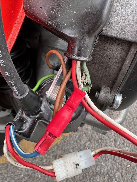

The Most recent "ride" was the 2.5 miles home pushing the Vespa.
he shop was really helpful considering the time, 19:30 on Friday evening !
Turns out one defective wire prevent start. They called it the "kill switch". Made temporary repair later that night. Have not been out for a proper ride yet.
Ideally want to replace the red bullet connectors and entire length of green wire pictured.
The notorious P green wire! Not sure where you're located, but ScooterWest does a green wire kit: https://www.scooterwest.com/green-kill-switch-wiring-kit-for-p200e-vsx.html
See this video:
Quick google maps search gets us England for their location, I think. It's the only option for Ingleton as a place rather than a road.
