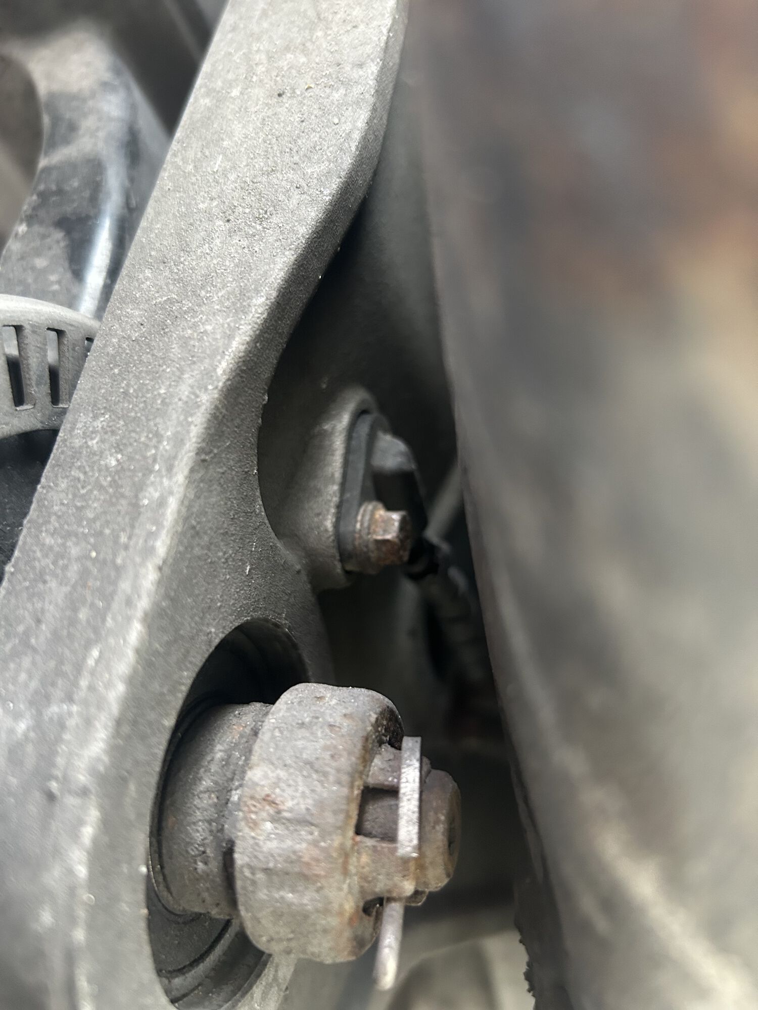

Picture of my ABS sensor and you can see the protective sleeve on it in the background.
