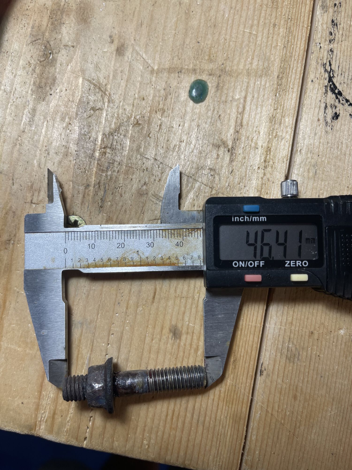

Last week I switched out the Malossi exhaust on my new (to me) BV350 for the stock one. As you can see in the pic, the old stud bolts were shot, only just managed to get them out.
In an effort to avoid this problem again I decided to us stainless steel stud bolts, which I duly got from a Uk supplier. Did some research and discovered it's not advisable to use copper anti-seize with stainless, so went looking for some nickel anti-seize, which I found on Amazon. Most other places won't ship it to me in Northern Ireland (no idea why!).
After missing the initial delivery date of last Friday, they've now emailed me to say they can't supply it. So now I'm back to square one. Albeit with some nice, but useless, stainless steel studs!
So, my question is... Am I being a bit OTT with the whole stainless steel stud bolt thing? Are regular studs perfectly OK to use? I mean, I realise it's what gets used most of the time, but then I also think that getting them out can also be a right PITA.
Knackered stud bolts!

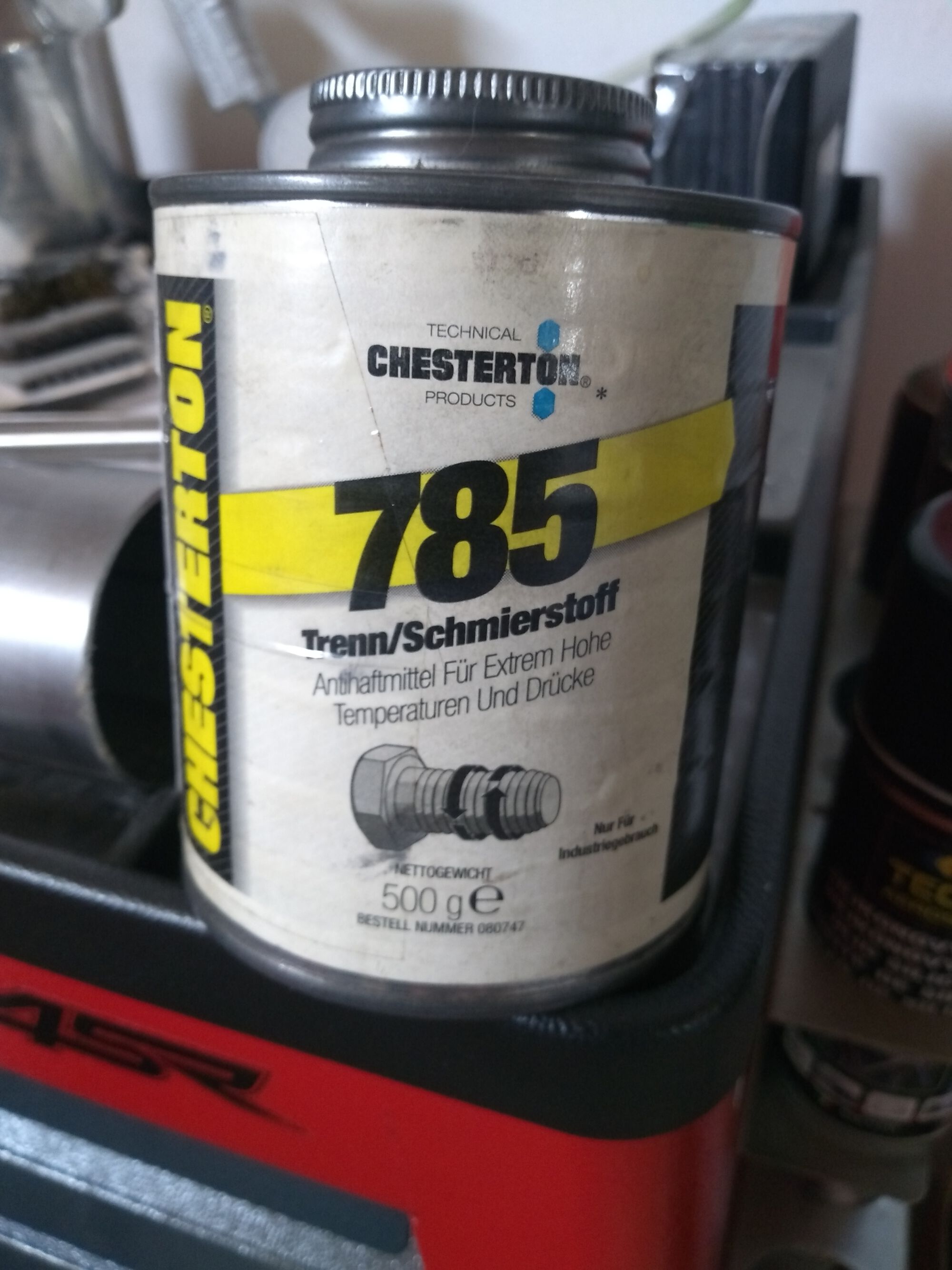

Always use a magnesium based anti-seize with stainless steel. If using a stainless stud and stainless nut, beware of galling otherwise, when the two get locked together and just nothing will get them to move again - just make it worse.
Tip from an aircraft mechanic friend - the sludge at the bottom of a settled bottle of Milk of Magnesia is a good anti-galling anti-seize when working with stainless.

The bolts and exposed part of the stud were shot, see it pic. The only way it was coming out was as a complete set!
Unless I'm mistaken, isn' magnesium only good for low temp applications?

I dab a little nickel antiseize on pretty much every fastener that doesn't go into plastic, and a bit more if it gets hot. I have never had difficulty with stainless fasteners and nickel antiseize in any application except long term use in aluminum in saltwater environments - which was no surprise. The best solution there is a nonmetallic antiseize paste called TefGel.
Do they not sell nickel antiseize in any auto parts store in N. Ireland? It's inescapable in the US. I find the copper version a little difficult to track down in the US and have never even heard of a magnesium formulation. McMaster seems to sell stuff containing nickel, copper, graphite, aluminum, and molybdenum.

I've now ordered some "alumslip", which as the name suggests, is another metal based AS, but it still suitable for high temp and stainless.

We used Milk of Magnesia to coat 32 inch stainless steel heater elements in aluminum plates which gave better results than the regular ss antisieze compound. The aluminum plates ran between 400-500f on the surface, the heating elements much more
The only down side was if I didn't wear gloves with in a minute I had to go
