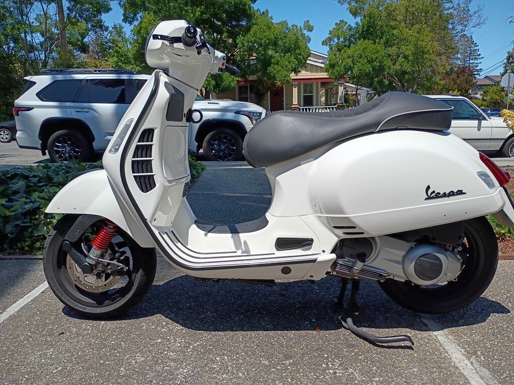

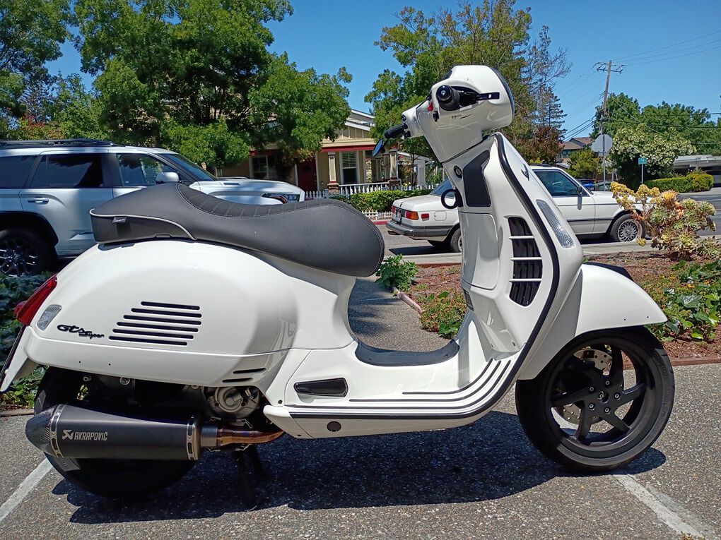

Why these?

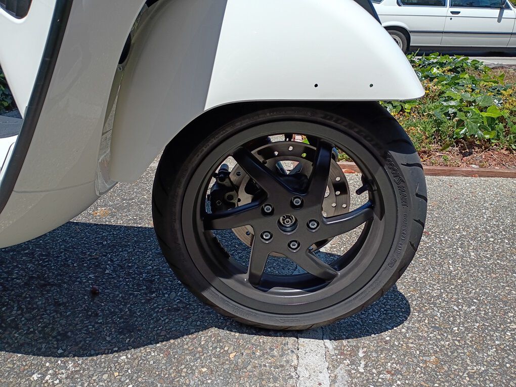

1) good looking wheel, Marchesni 5 spoke look.
2) bolt on, no machining or adapter required, only bolts for tone ring required.

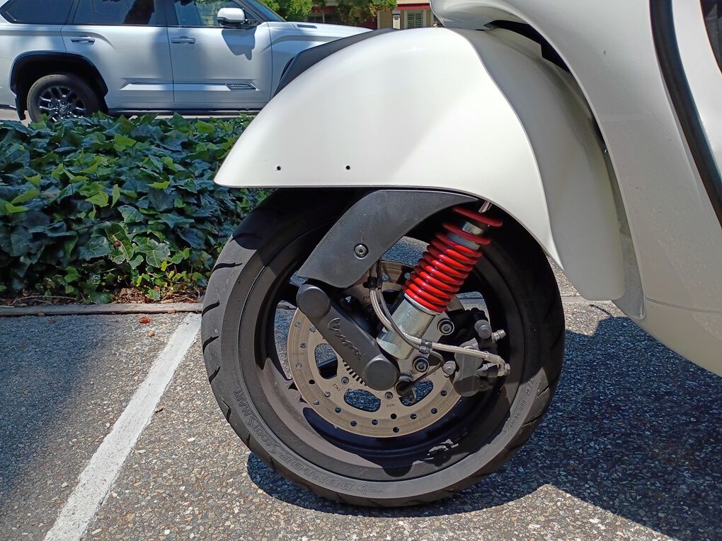

3) 3.5 inch width for 130/140 front to rear stagger.
4) only $95 from your local Dealer.
Only con is the unpainted lip at hub, had it machined off and wheels re-powdercoated.
