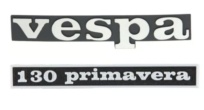

I am confused about something you said, you said features are slanted logo, but then uses the straight lettering, so is the correct badging the image attached or the more script one?

To be more precise: Vespa 125 Primavera 1st series with slanted/diagonal logo vs.
Vespa 125 Primavera 2nd (starting 1973) and 3rd series with horizontal logo.
The Vespa logo itself was a cursive "Vespa" lettering, from the 2nd series onwards with a more "modern" logo.
1. Series:
https://de.wikipedia.org/wiki/Datei:Vespa_125_Primavera_1972_front.jpg
2. & 3. Series:
https://cdn.germanscooterforum.de/monthly_2021_04/vespa_1.jpg.3f4225084e84b21bd8c097f277526827.jpg

Ahh so it might be the "Vespa 125" cursive front logo and not just the "Vespa" one, good to know
