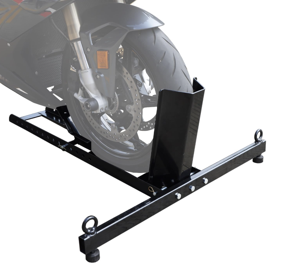

Just thinking about security as well, could you use one of these, long enough to wrap around the telegraph pole and your steering column?

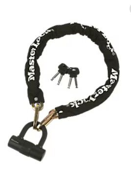

Couple of cheap ratchet straps to tie around pole and steering column, and other for footwell and pole add a litelok x3 through front wheel and suspension to avoid theft.

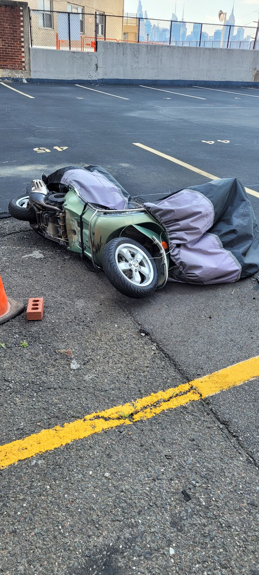

Not good
@shebalba avatar
Posts: 2098
@shebalba avatar
Posts: 2098
Bummer.
Looks like you put a cover on it.
Hopefully the crash bars spared you a lot of damage, and that cover saved some paint.
Posts: 46053
Posts: 46053
Shebalba wrote:
Bummer.
But the cover might have been the reason it tipped over...

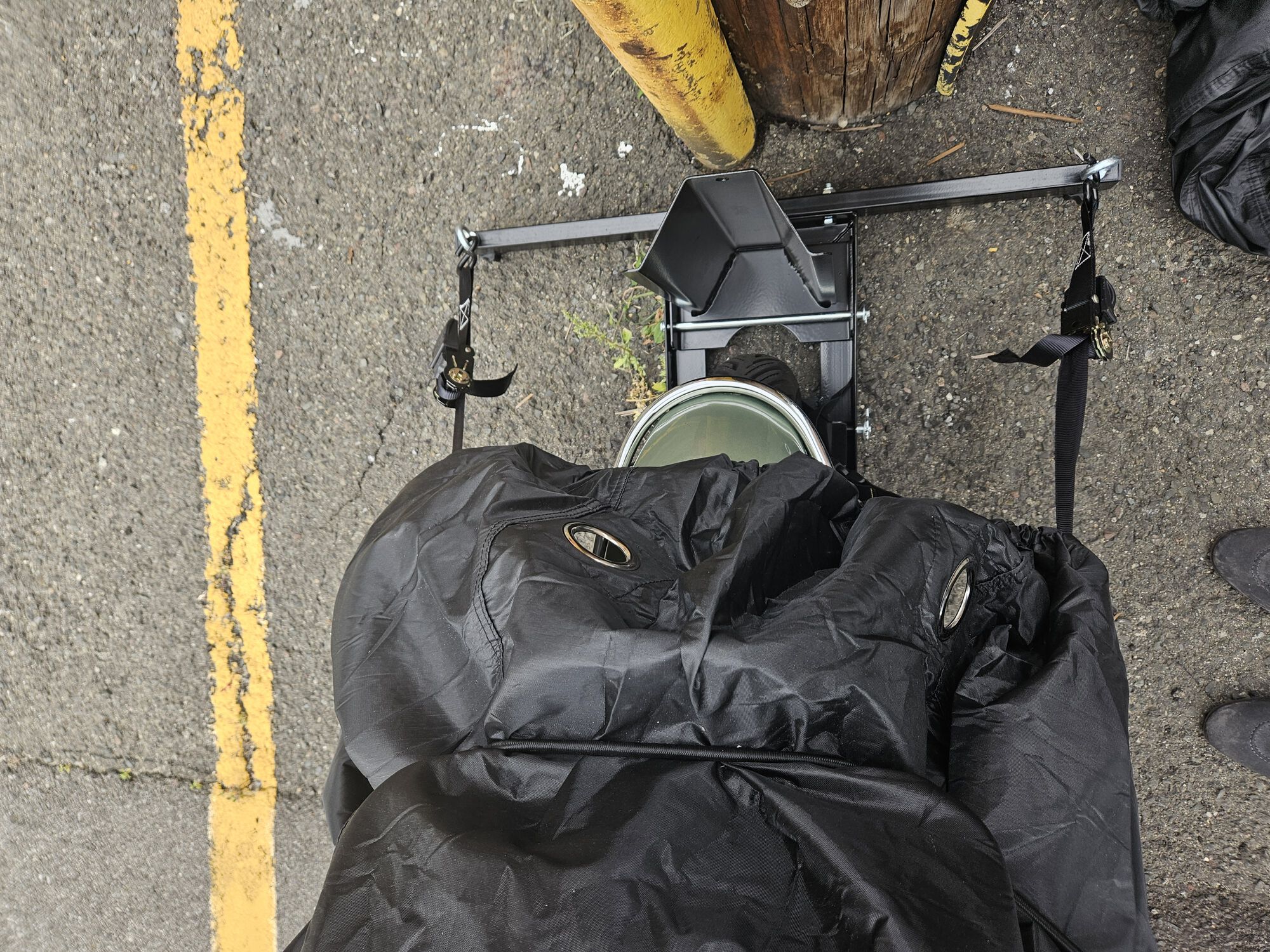

Yes I do keep a cover on it due to only only parking spot available is this one and its full sun and the seat is leather. I tie it up with a cable to keep the wind from picking up any edges. I left town on a work trip and returned to this. Sadly the bike started but then stalled and will not restart. I am looking to arrange a pick up from a local shop.
I just ordered this!

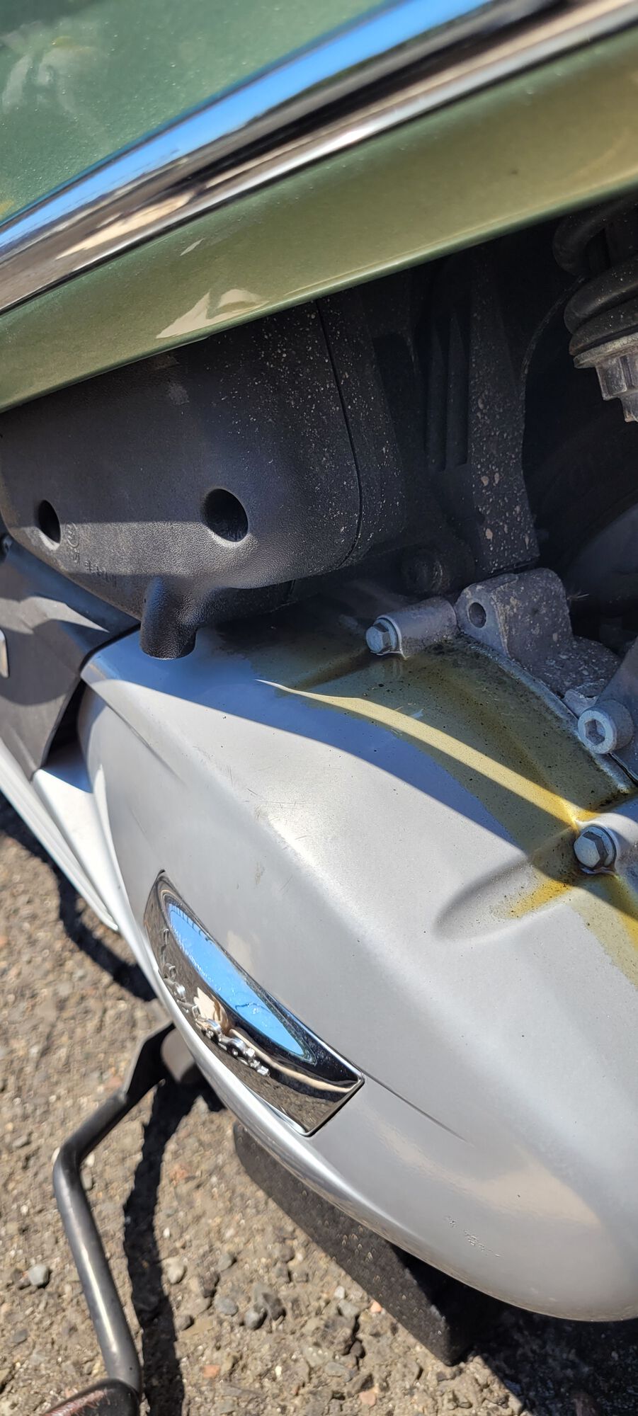

Ok, I was able to get the air filter off and oil started dripping out. Facepalm emoticon

That's not a big deal. The oil can end up in the air filter when the scooter lays over to the left, like yours did. Wipe it out, try to take off the little clear plastic bubble on the lower surface of the housing and empty it out, new filter element and off you go - maybe.
Posts: 46053
Posts: 46053
Just dripping? That's OK. Now clean the filter by putting it into a zip-lock bag, add some gas and squish for a bit. Empty out the gas (into your used oil container is OK), add some more and the same amount of engine oil, squish again, empty out the excess with a few more squeezes, and it's ready to go.

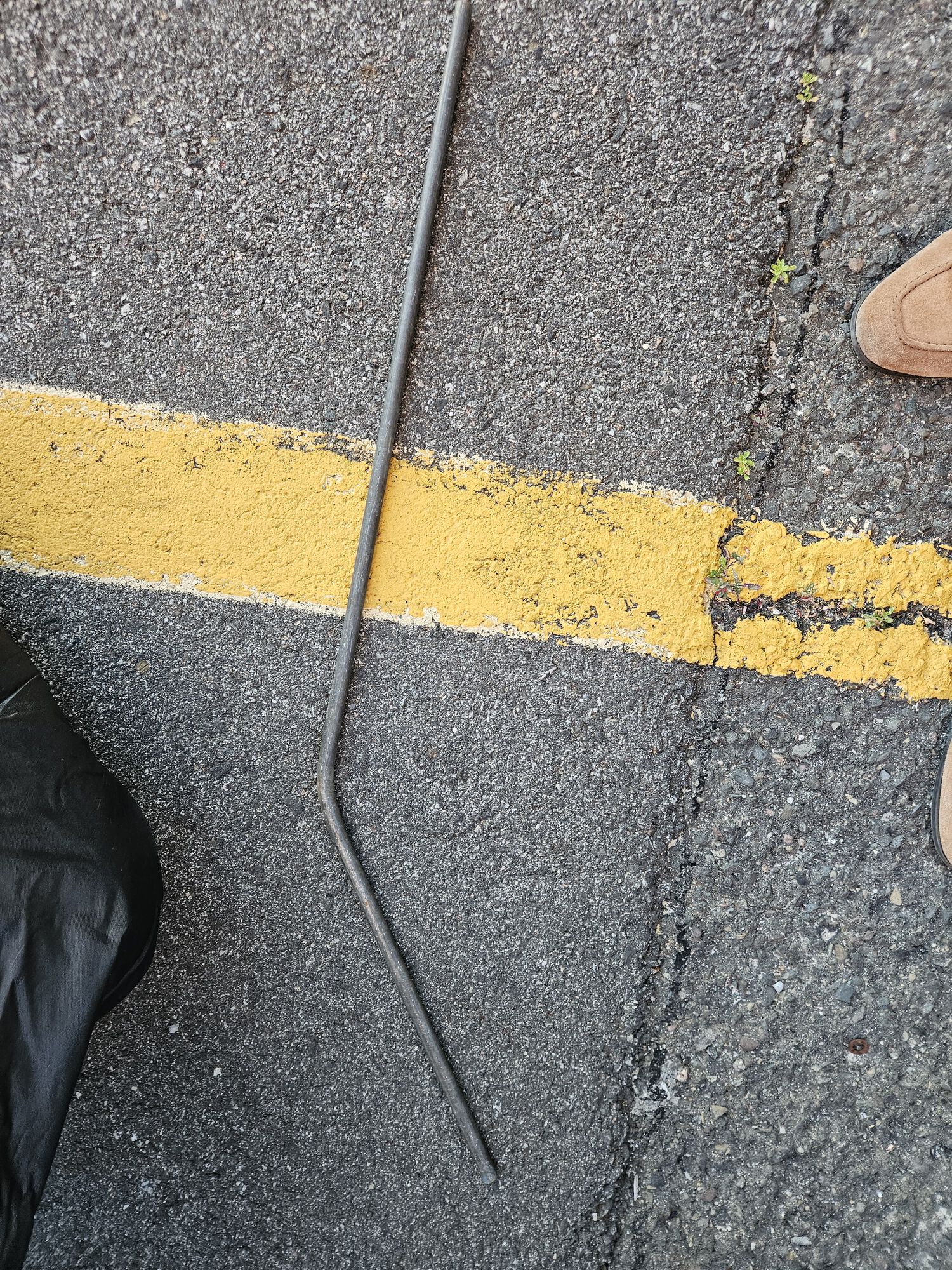

On my way home I bought an steel bar for the center stand. $9 Facepalm emoticon
