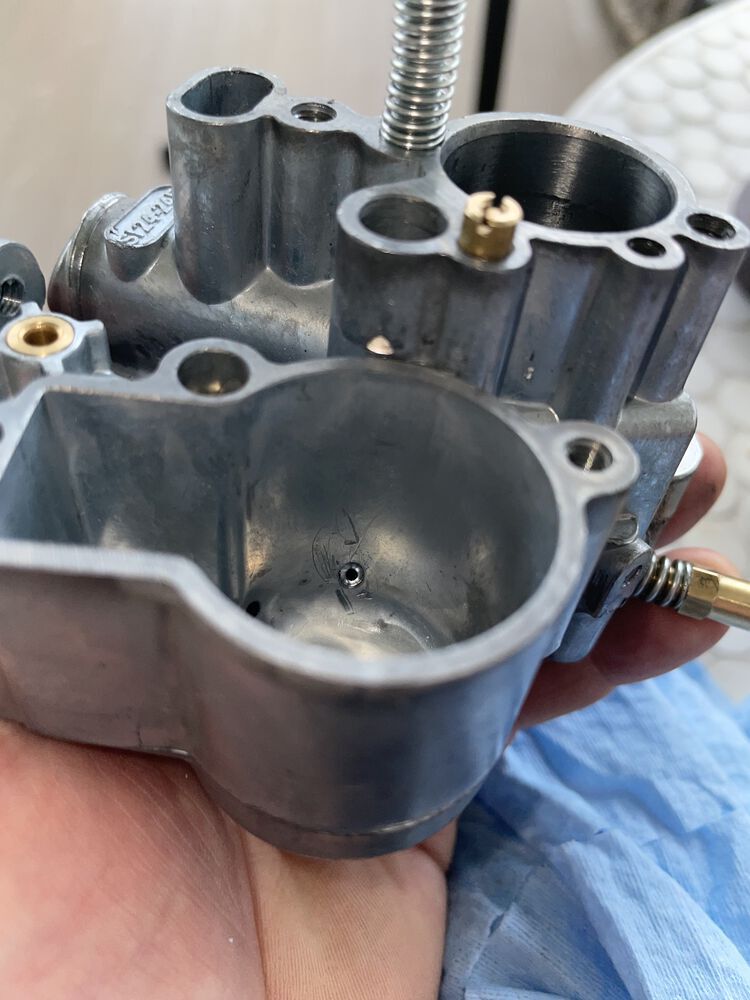

Removed the carb and looked into the bowl. Fuel was at or just below the drilled hole at the bottom. Is that something? Should there be more fuel in the bowl when I check? It DID look like maybe the carb couldn't draw, because the fuel was at or below the hole.
Removed, checked and cleaned all the jets. Checked that the drilled hole at the bottom of the carb bowl —that leads to the passage where the jet stack is—was clear and not blocked.
do you mean fuel is below the hole at the bottom of the float bowl? see picture
If so you may have a stuck float needle.
this should be full of fuel.

Thanks. When I have opened the carb—-after the engine dies—the fuel level is right at that hole. I'm not sure what that means, but my first thought was, "Hmmm. It's sure looks like the carb can't draw fuel, or not much fuel, through that hole."
I've opened the carb twice and found the fuel at that level.
But I'm no expert. Is it SUPPOSED to be higher?? If so, that would explain a lot. But I don't know.
I thought that maybe the float or needle valve might be bad, so swapped over the top (banjo, needle, float) from a known good carb body that I have (unfortunately the fuel screw is in that one is mangled so I can't just switch the entire carb and test). But changing the float and valve made no difference. Still dies after one minute.
