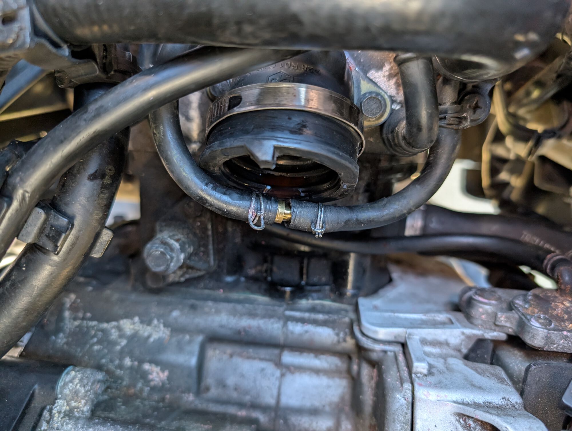

where there's a will there's a way. I modified the throttle cable mounting bracket to allow clearance. installed and working with new jets as well. I wonder if I have got that flat spot yet........Test ride now
I also fixed those pesky water heating pipes on the bottom of the carb. not needed in australia and makes the carb so much faster to get in and out (and its been out way too often)
