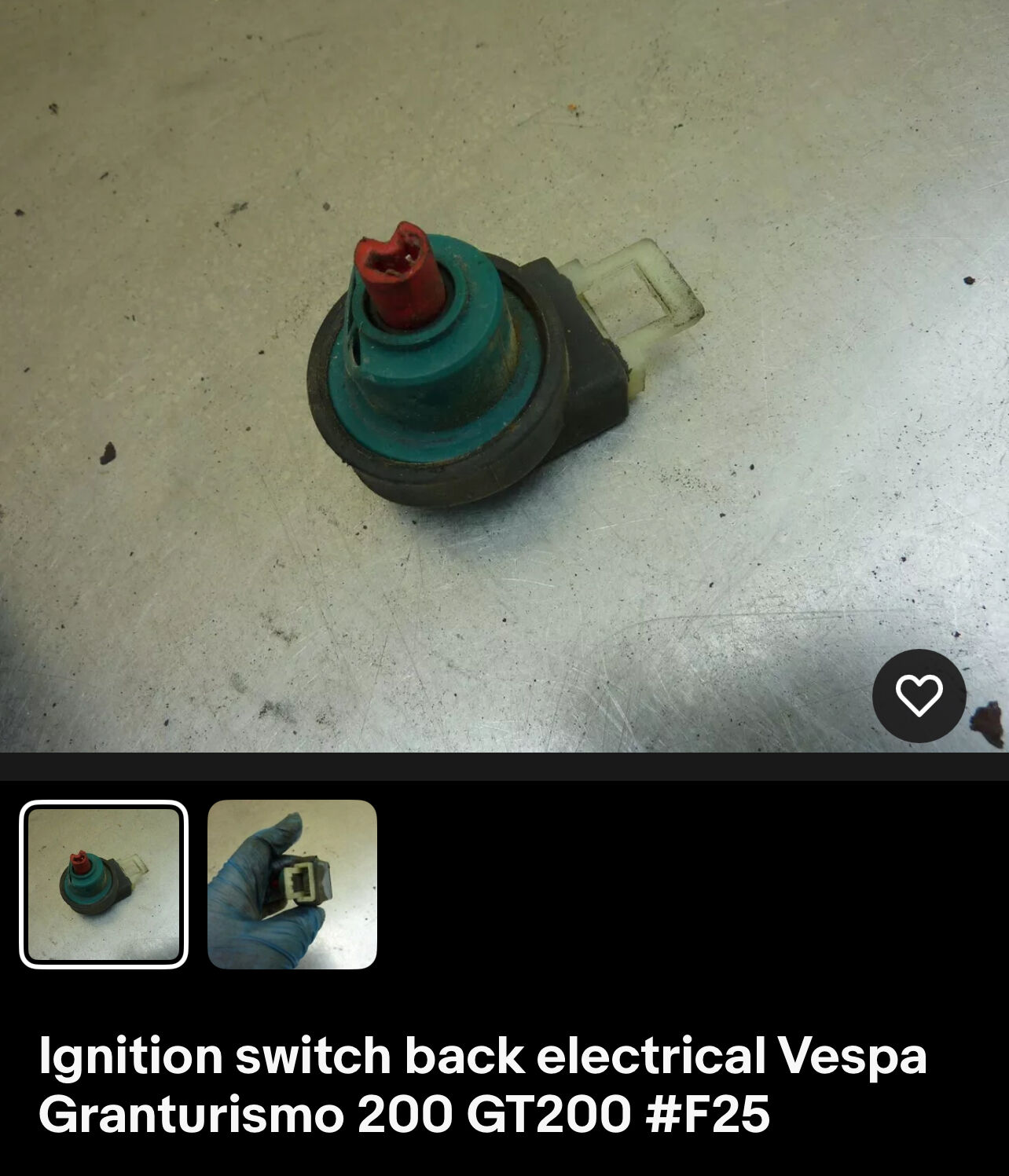

Thanks very much for your prompt reply.
Is this the part for the job?

That's the one! There are quite a few variations that all look very similar, so ensure you're getting a GT200 one.
Of course, that might not be it, but it's a pretty safe 99% bet. Otherwise it would have to be a corroded wire or other connection between main fuse and the switch.
