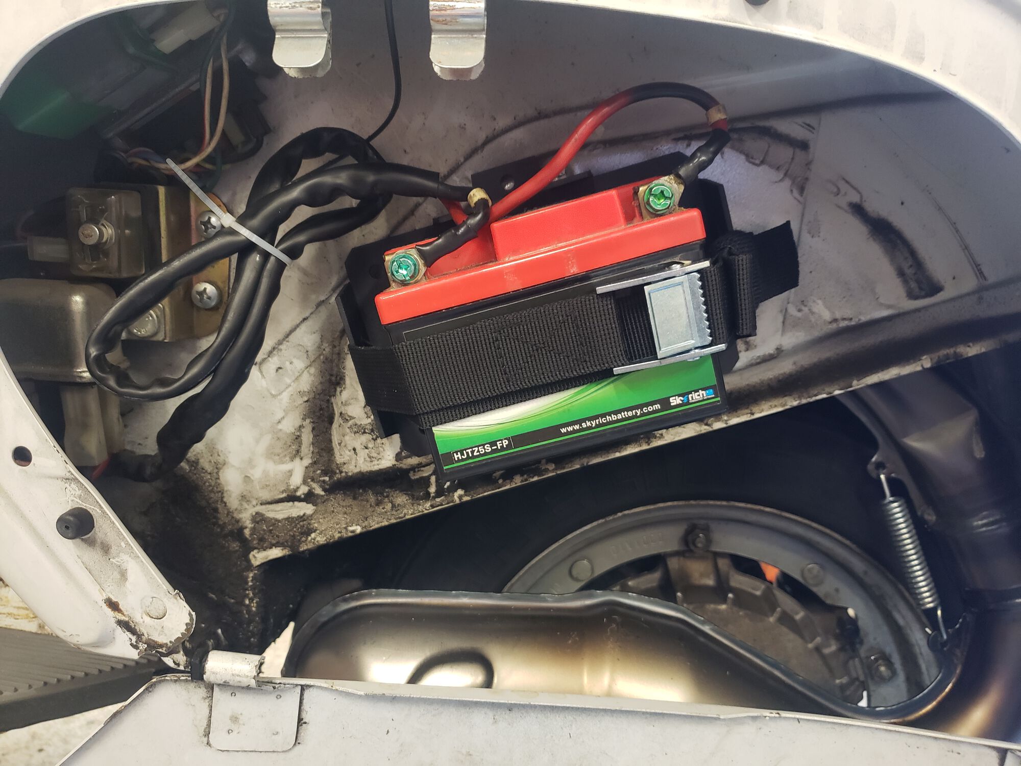

https://www.ebay.es/itm/172097908656
Sits in my 2019 Primavera.

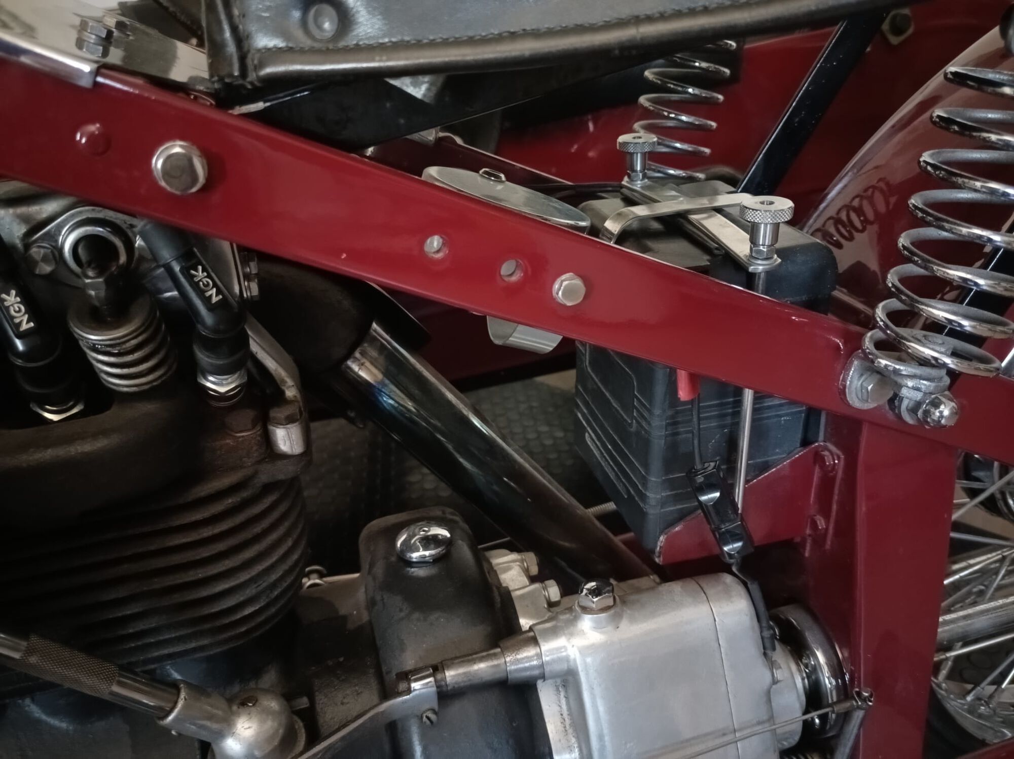

Fitted in the NImbus and works a treat:

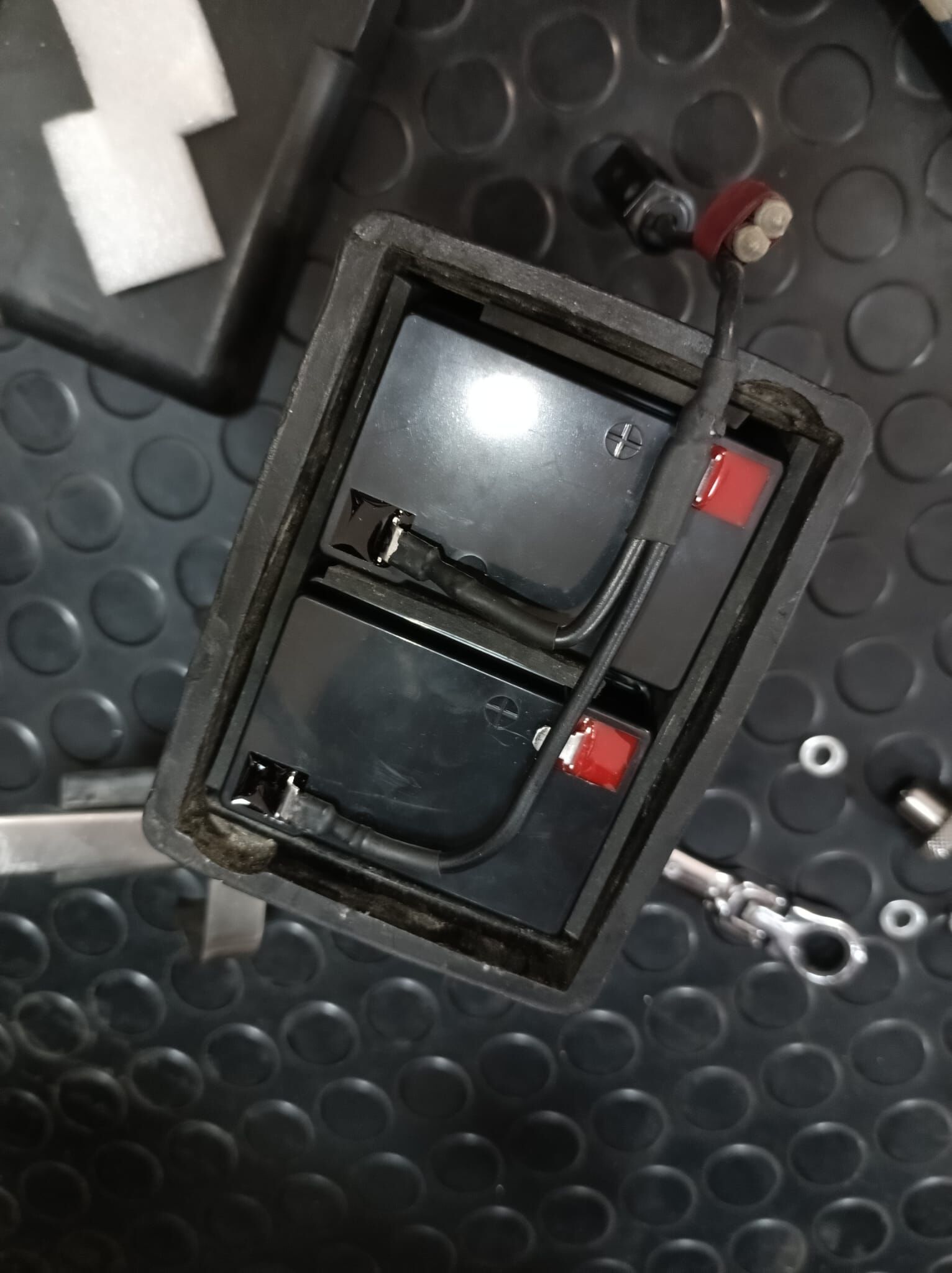

Now I have the LiFePO4 fitted and am confident it works, have measured accurately and concluded two in parallel will fit like it was intended to.
Bought that second one

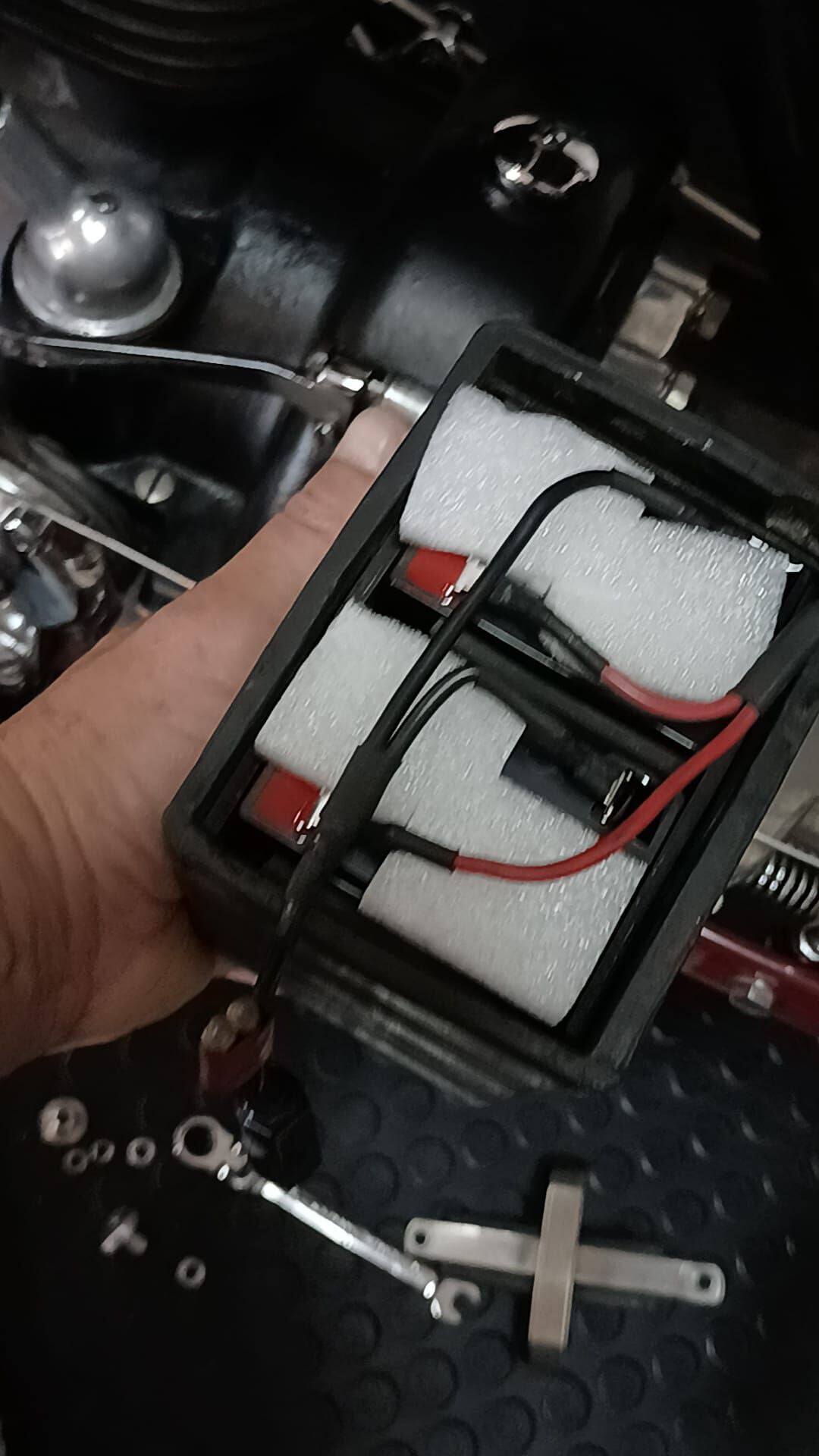

Second battery is in. Über I think. That extra better quality amperage in the same size at lower weight.

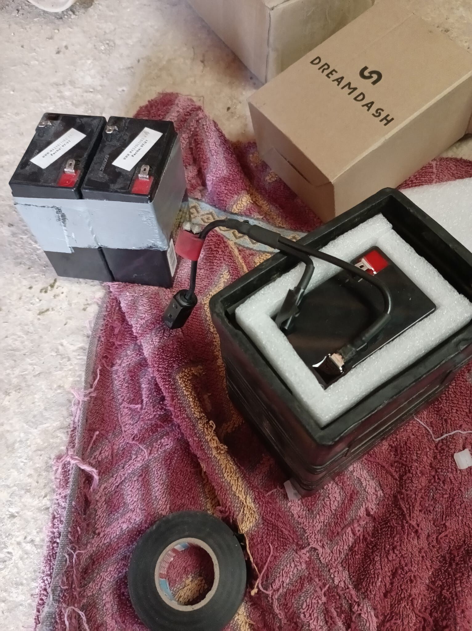

Done 6V 12 Ah.

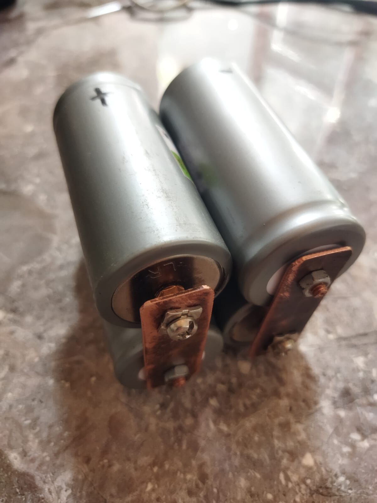

I have installed 4 pcs of lifepo4 32700 batteries in series to get 13,7volt which are equivalent to 6 amps. This has been working well for 1 year.
lifepo4 32700
lifepo4 32700

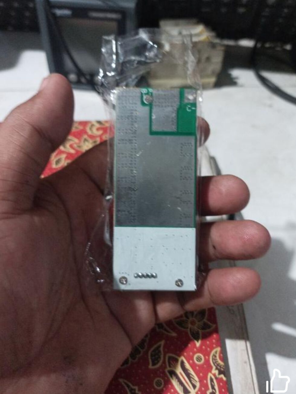

Oh yeah i forgot. i added a cheap 100a bms as a balancer and protection.
Bms 4s 12v 100a
Bms 4s 12v 100a
