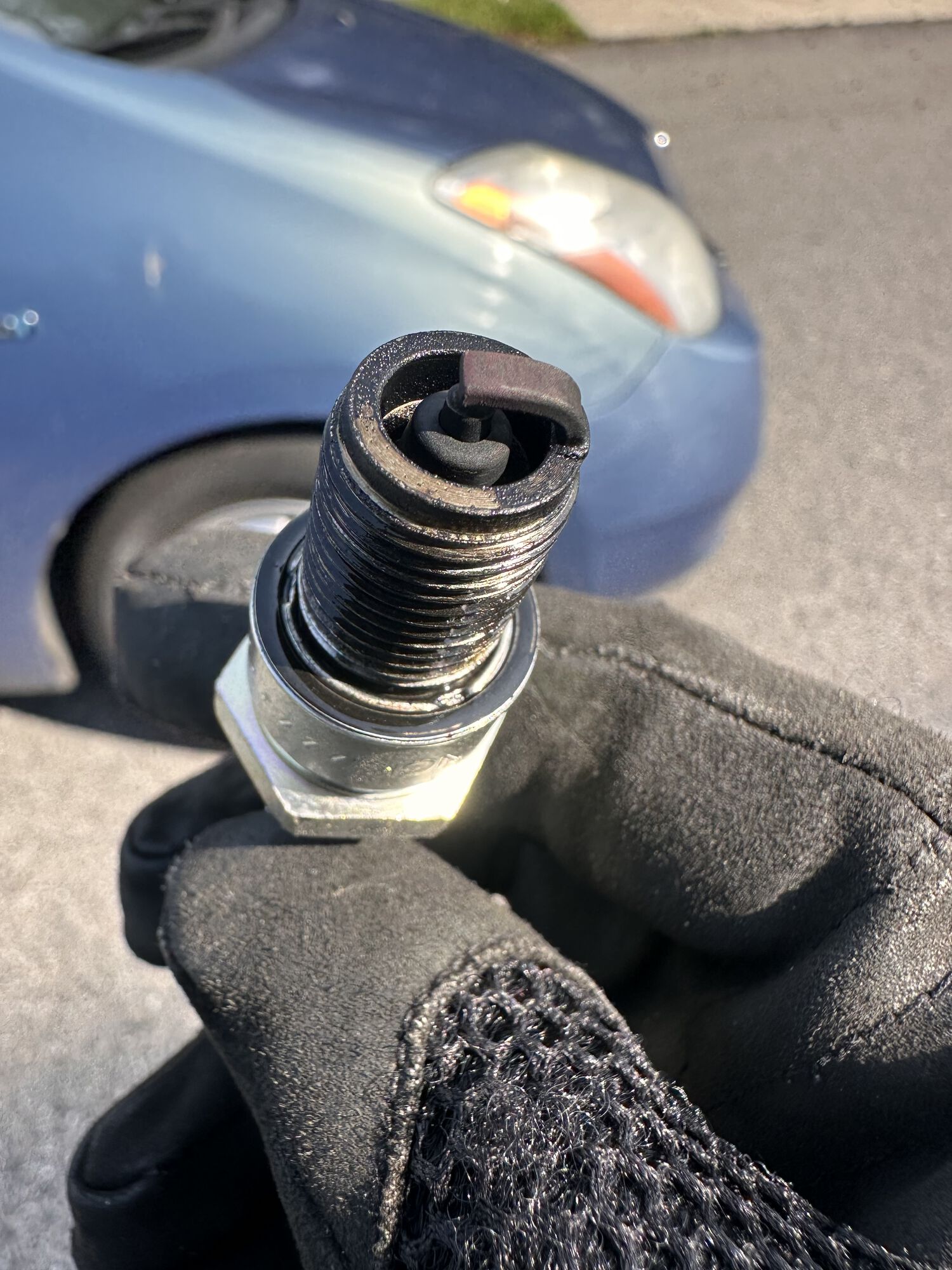

The 118 plug still looks rich to me, but I'm pretty new to this so I dunno for sure. The plug is newish (less than 25mi on it if I had to guess.
I actually remembered to take a pic of the plug!
This plug is new as of the start of this adventure.
I actually remembered to take a pic of the plug! This plug is new as of the start of this adventure.
Yes appears rich. But was from a holding wot run on a fully hot engine? What number plug?
Yea, did the last WOT run with the 118 and checked the plug before I rode home. Didn't wanna ride home if it was whiter than my booty.
Fully hot yes. Temps at start were 200°F ish. Top temp was 293° with the sensor in the cyclinder head.
BR9ES plug.
BR9ES plug.
Ahh, that explains it. Runs great but has a 9 plug. A correctly set up 9 plug will be almost dry black. Buy a 7 next time and you'll have some nice colour.
If the 120 jet feels nicer run that, otherwise keep the 118.

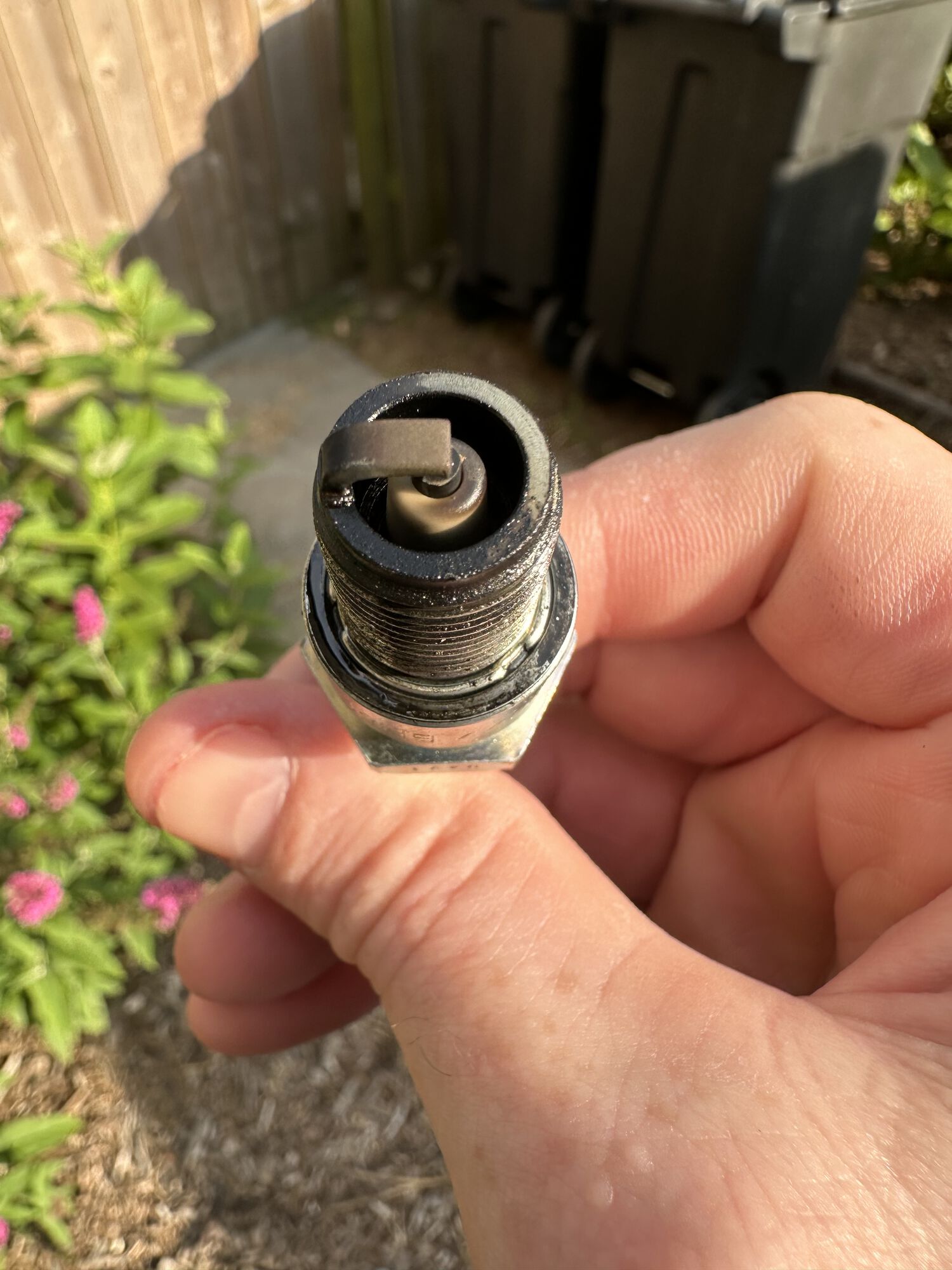

Had a chance finally to get out and continue this journey. Had an 8 plug so used that.
Plug looks a bit better. Got a 7 plug yesterday so I should have some time tomorrow to give that a try.
8 plug.
8 plug.
