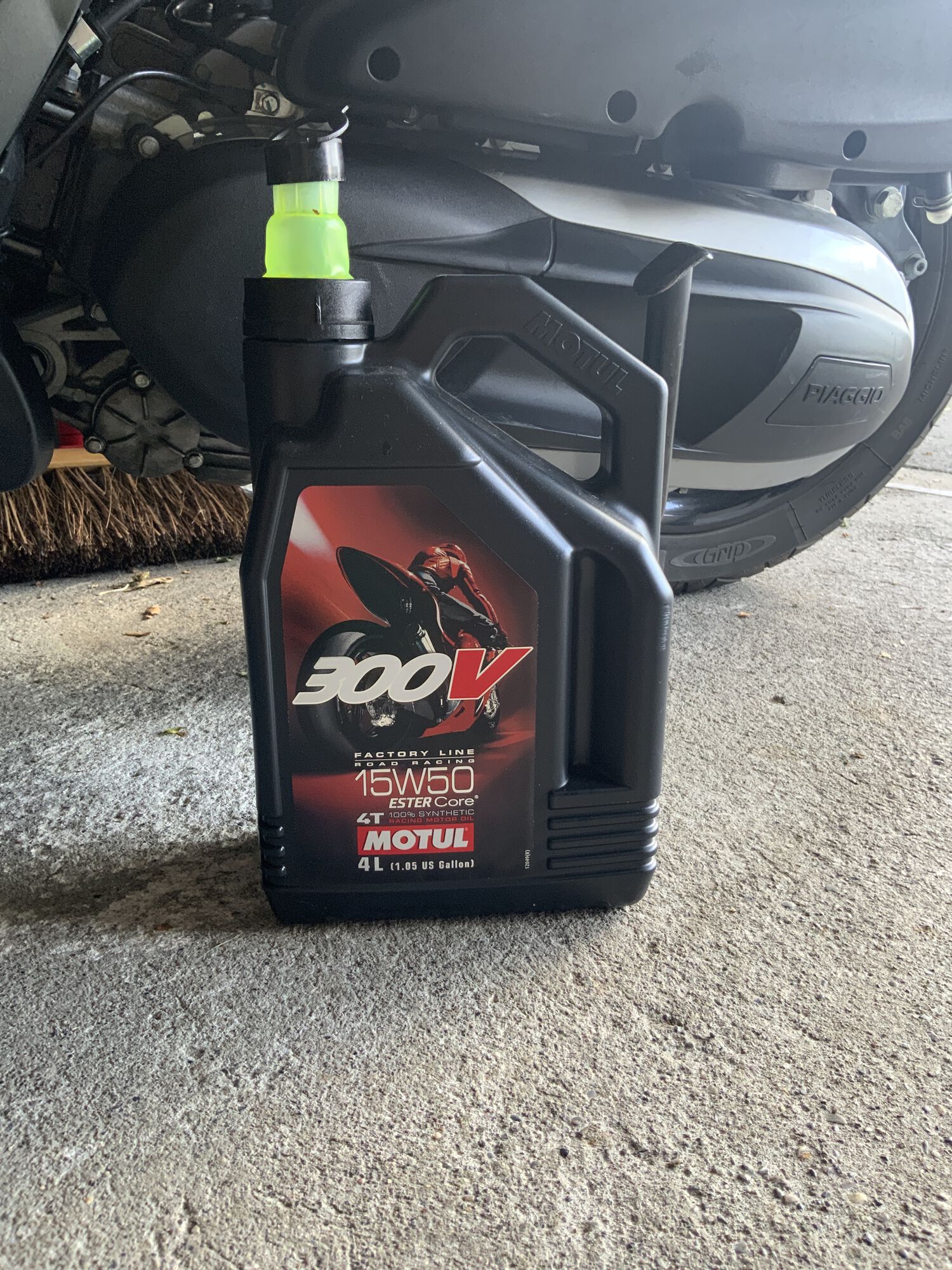

I use this stuff…
Also don't forget to change the transmission,oil occasionally, mine we totally black after 10000km (cause the clutch is in the transmission oil).
