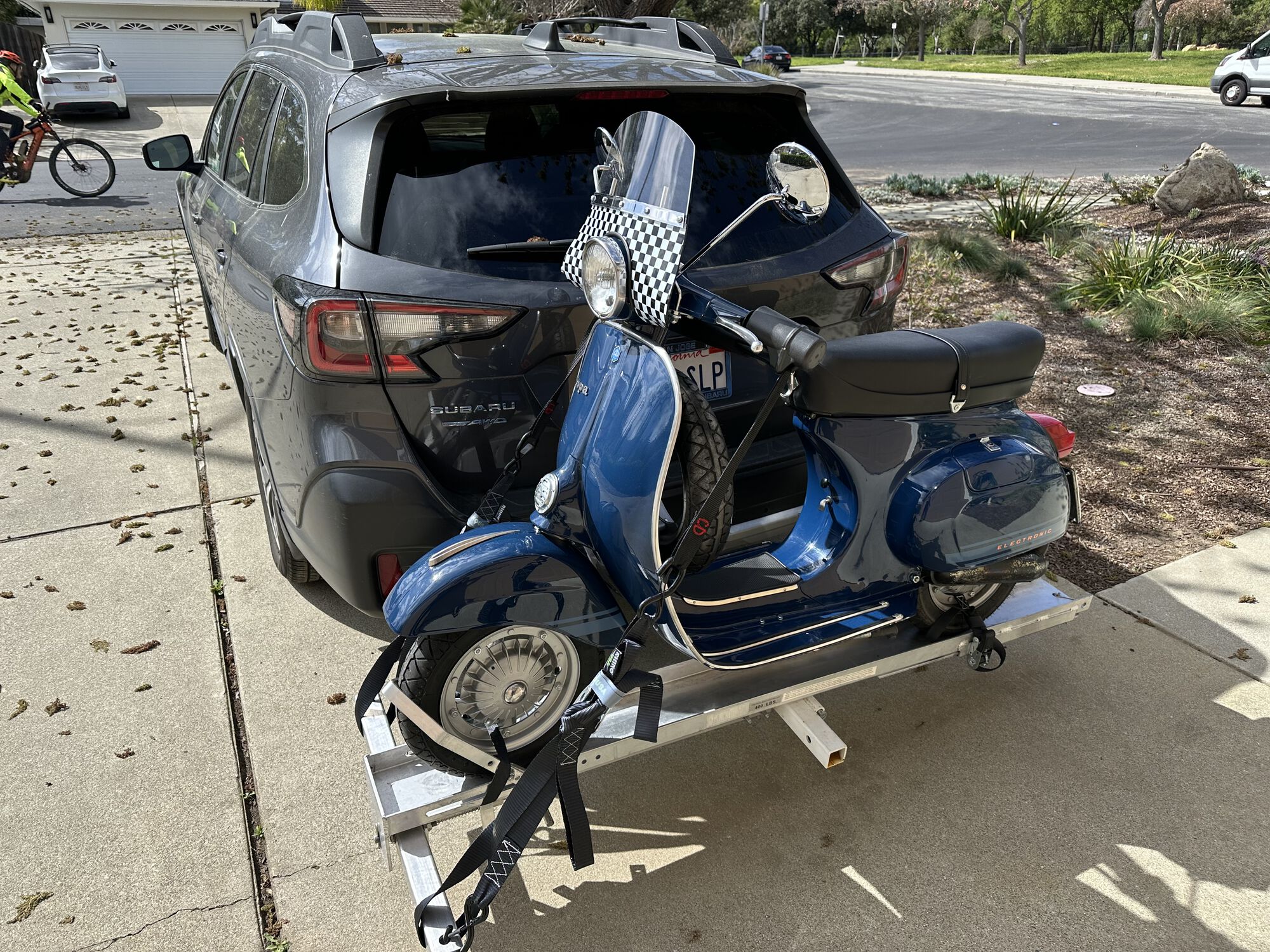

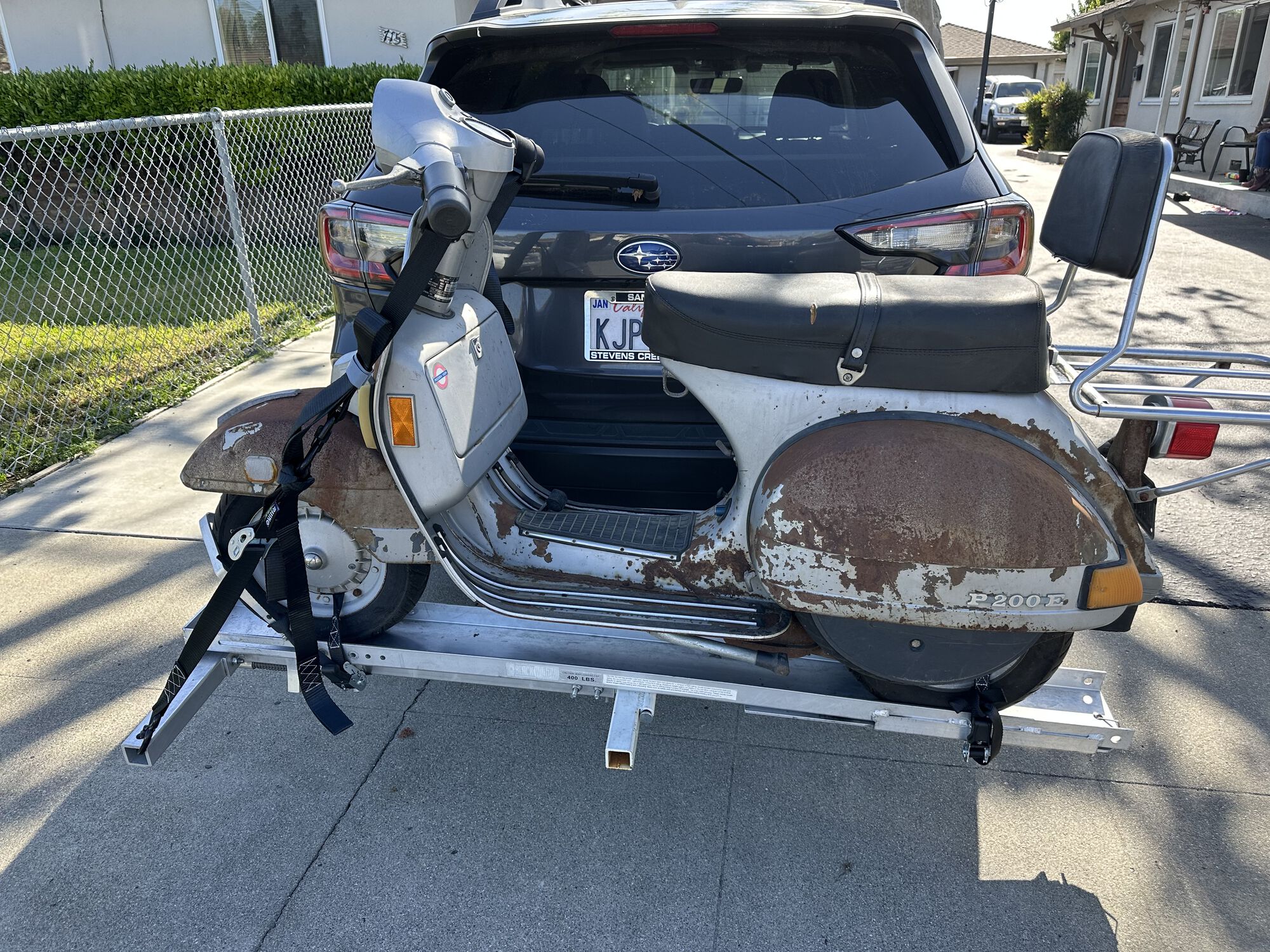

I have a Black Widow hitch carrier. Not sure of the exact model since I bought it used. It works great for carrying either my ET3 or my P200E to rallies. There isn't much ground clearance with my Subaru Outback, so I have to be careful on driveways and the like, but it's well within the weight limit for the hitch receiver.
It pivots down on a hinge and you pull out a ramp to push the bike up. The ET3 is easy, since it's only 78 kg, but the P200E is a bit more work, as it tips the scales at 108 kg. It looks like the Primavera 150 is 117 kg, so that might still be manageable.
I found the ScooterWest video very helpful. I'd say the "Canyon Dancer" strap that he recommends is essential.
Roland, my P200E, on the carrier

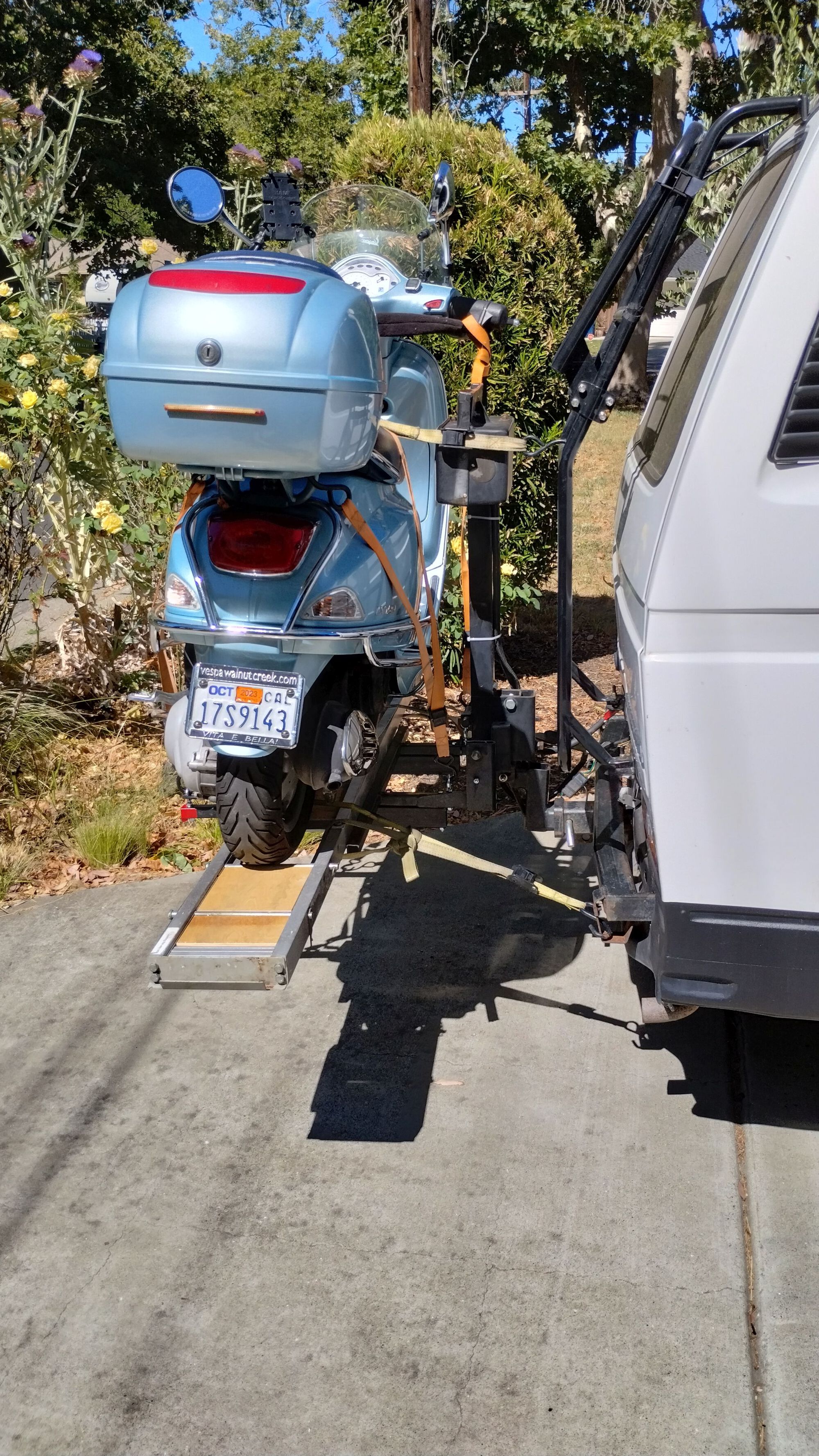

We use a trailer when it's both our scooters, but if just the LX I use a severely modified electric disabled scooter lift.

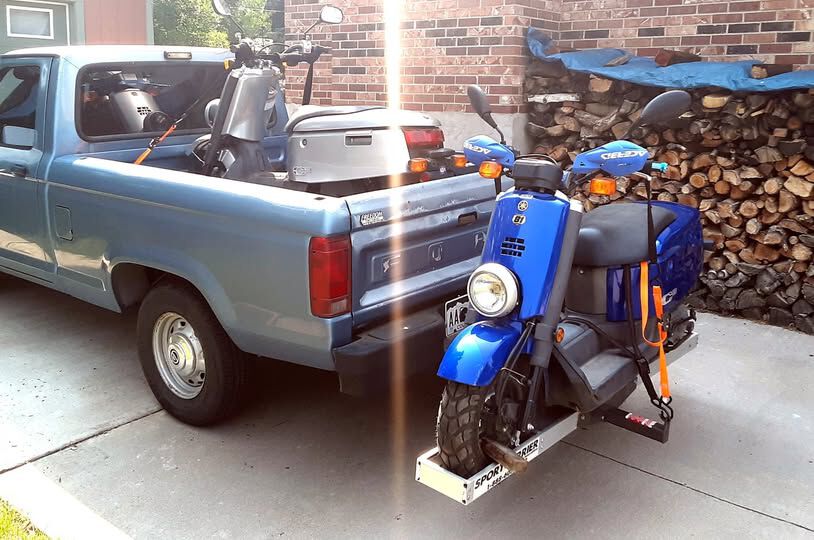

I absolutely hate owning a trailer. Where I am the tags are around $80 a year. I fell for it twice. After three years of renewing registration on a trailer I paid $100 for, I said enough is enough. I have a Ford Ranger pickup that I've hauled a Burgman 400 in the bed of. I have a 500 pound hitch carrier and the appropriate 2" receiver hitch on the truck. I've hauled two in one shot with this. Another decent alternative is the smal open trailer rental from U-haul. About $25 for the day. It all depends on what kind of vehicle your daily driver is, and how often you plan on toting your scooter around. Maybe a trailer makes sense for you, maybe not.
