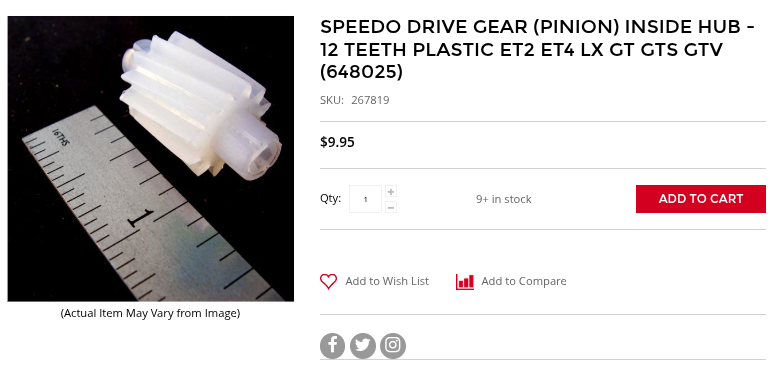

This plastic drive gear is a known weak link. Pull your's out and see what shape it is in.
