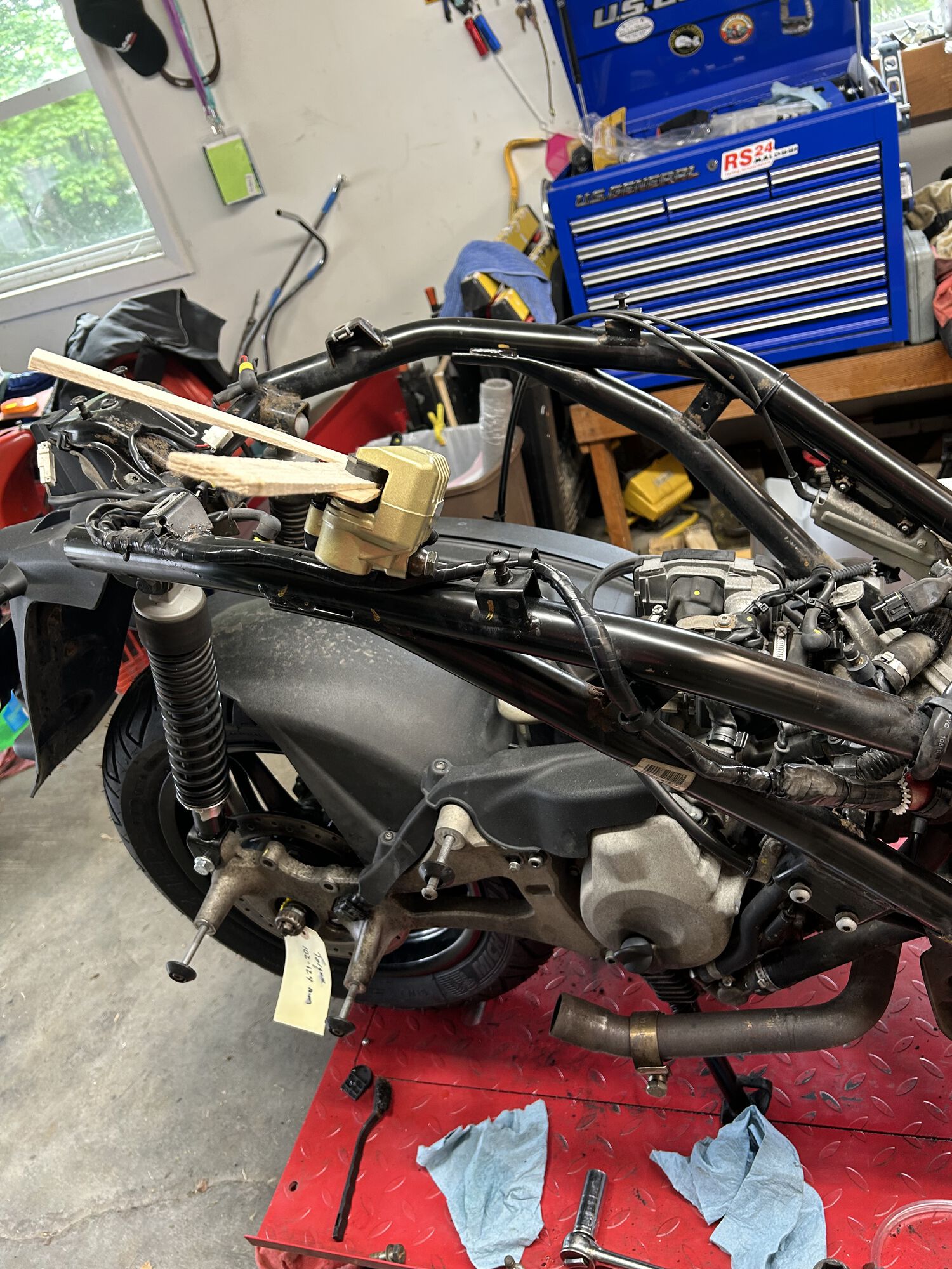

I had a seized caliper on my BV. The only way I could bleed it after replacing the caliper was to wedge shims in the brake and raise it up high. Still took a while to bleed

More information on raising the caliper to get air out of the lines please! What were the steps?
I took my BV350 to an outstanding independent shop to bleed the brakes (and lots of other things). The back brake no longer works. The mechanic said that was the first time this has ever happened to him. He tried twenty times to bleed out the air, but no joy. He stated that he believes there is air in ABS unit and only a dealer has the tool to actuate the ABS system while bleeding the brakes. I've seen the tool on sale for $614 on Ebay, but that is too much to pay for a tool I might only use once and won't come with the data updates that dealers get each year.

Sorry, I missed this. Maybe you go this sorted already, but what it takes is to remove the two mounting bolts for the caliper, wedge a piece of wood between the pads (and try to be sure it won't fall out....it doesn't help the process to find it on the ground ), remove the mounting bolt holding it to the exhaust support and raise it to about seat level.
I wasn't sure if orientation of the caliper mattered, but I did rotate it a bit a couple of times when drawing fluid out.
Not sure whether that was key to my success, as I was trying so many approaches it just seemed to work at some point. I swear at one point I had no idea what I was doing anymore, nothing seemed to work, and just at minus one hour or so (from loss of sanity), it did. Persistence seems to be a major factor.
But assuming you're less German than me (ask my wife about stubbornness ), a good dealer may be worth the trip.
