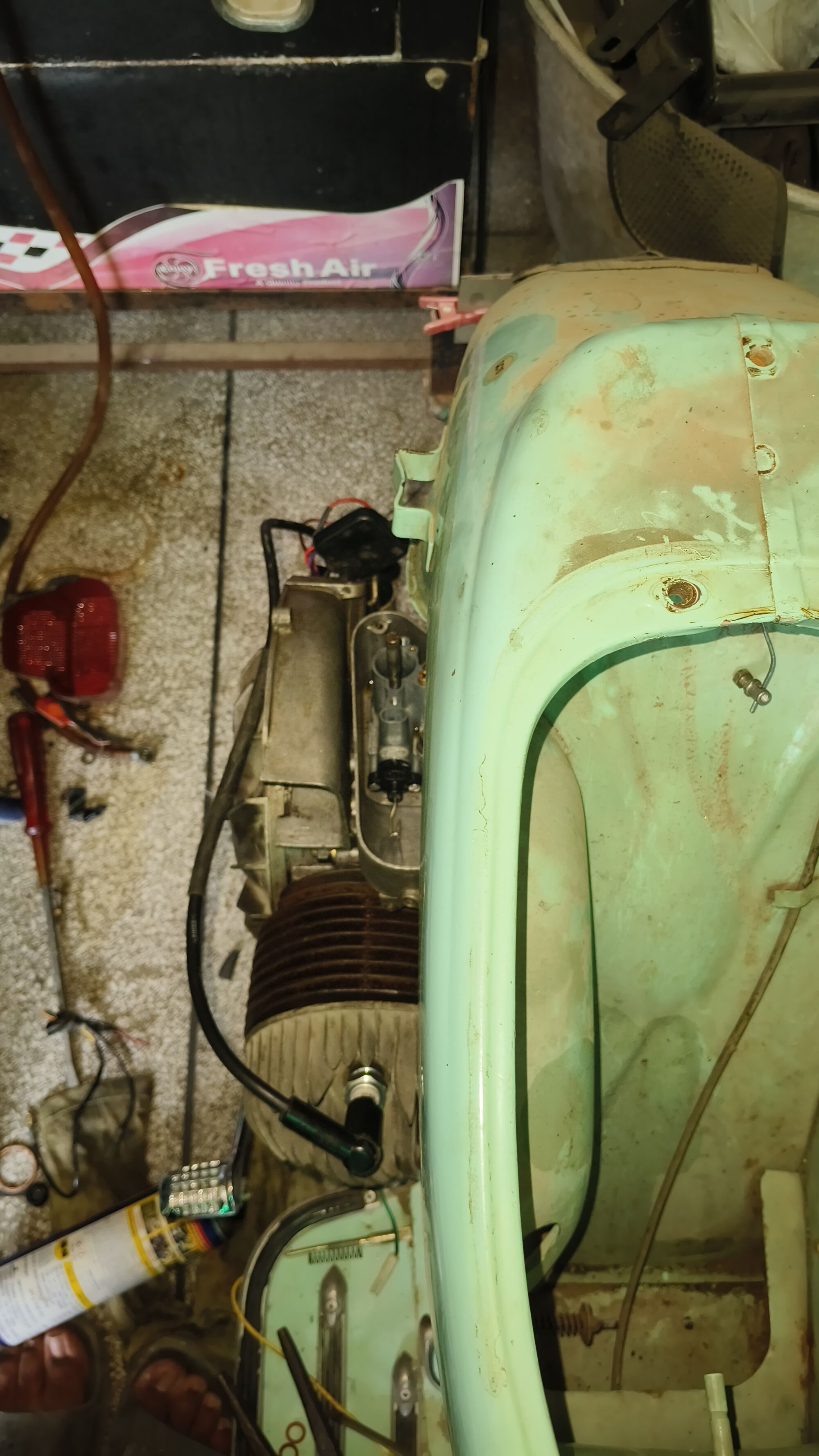

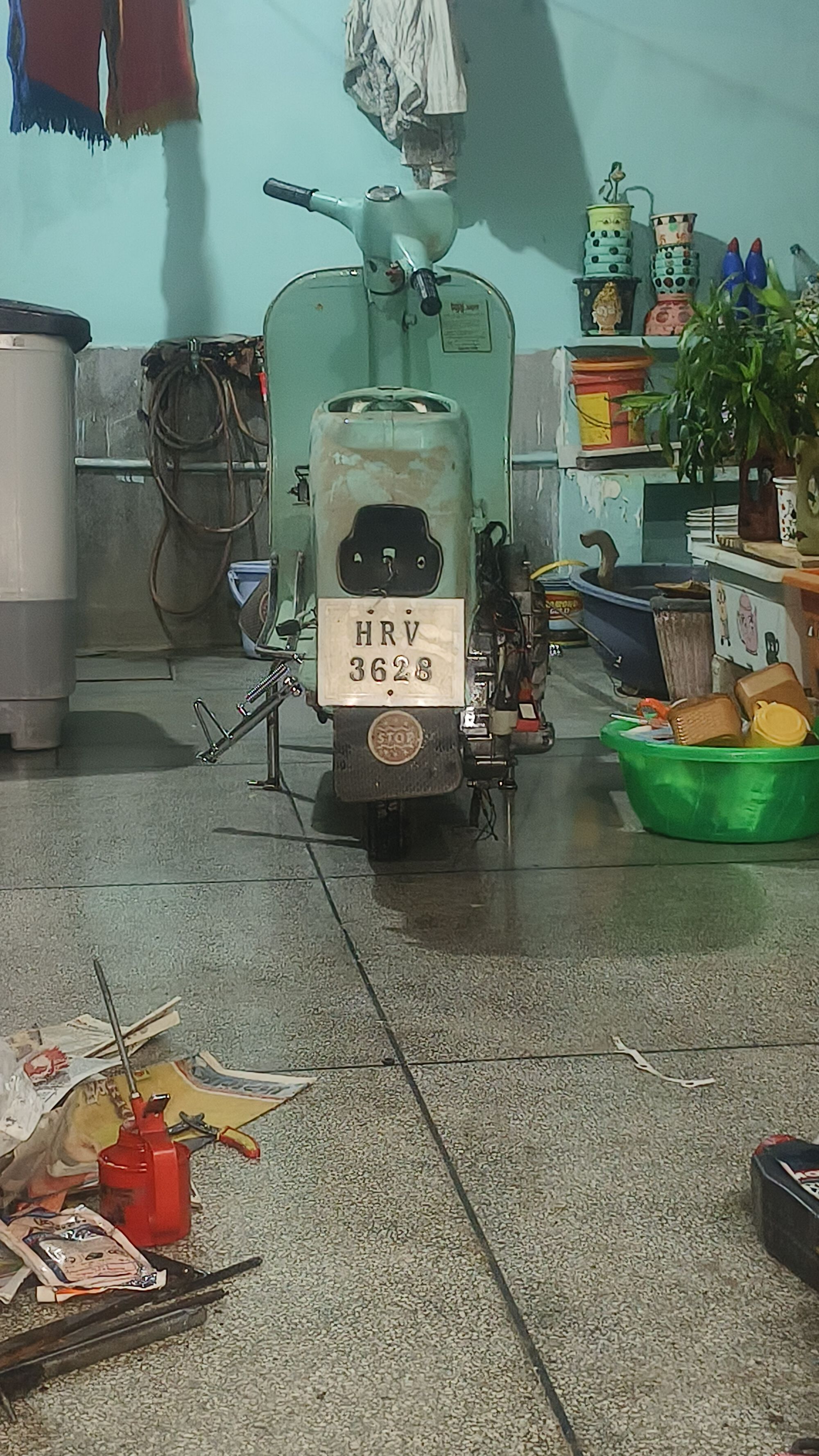

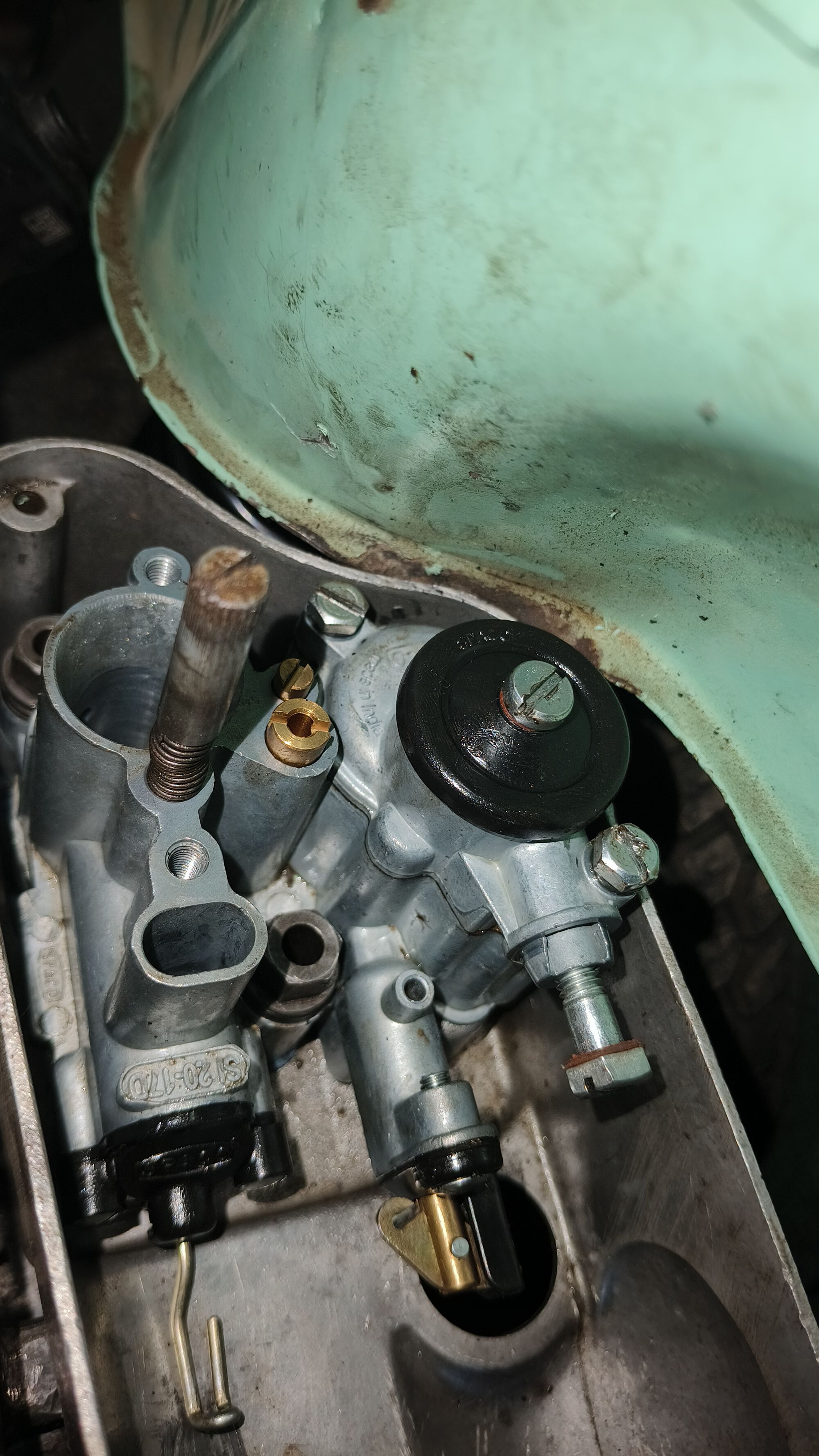

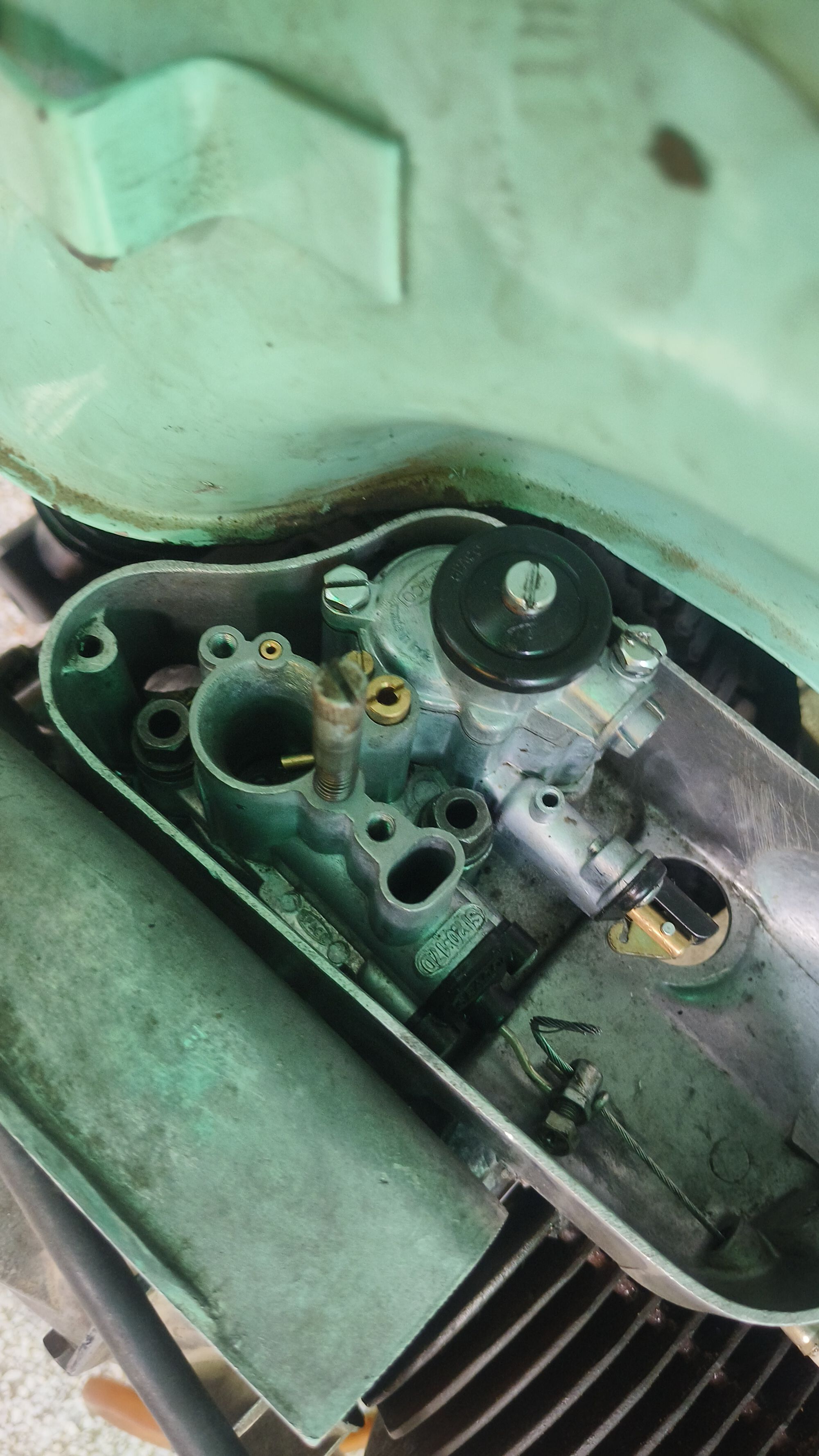

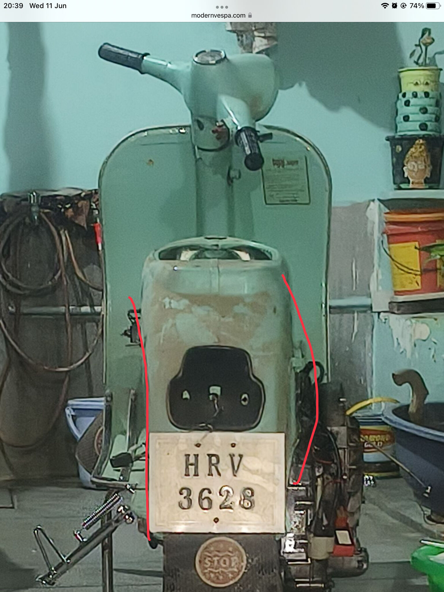

Hello guys I am Daksh from India having vespa super 150 1986, I just rebuilt it's engine for the 1st time in its life so it covered 2.5Lakh kms and was still running from 1986. I changed all bushings but the engine is shifted to left side causing the carb cover to scratch chassis and also I am unable to install carb cover/housing lid. Sharing some pics below please help asap.

Welcome daksh. Did you replace the swing arm bushings?

Yes all bushings are new

Looking closer at your picture, the rear tire does seem to be straight. The body next to the carb looks deformed. Maybe you just need to "persuade" it in a bit for more clearance.

Means bending the chassis near carb cover?

Yes. It can be moved over, almost touching the shock.

I'm Not sure how "1986" & "Super" go together?
The picture from the rear is rather dark, so hard so see what's going on with the tyre, however, as already mentioned, there seems to be a lot more on the right than the left. Are you sure it hasn't been smacked in the left at some stage? Is the wheel on a serious lean (bottom to the left)?
BTW: we love photos here, so the more the merrier.
The body of My VBC would rub/catch on the carb box whenever i took off rear shock & pivoted motor, so I smacked where it was rubbing with a big rubber mallet... never been a problem since!

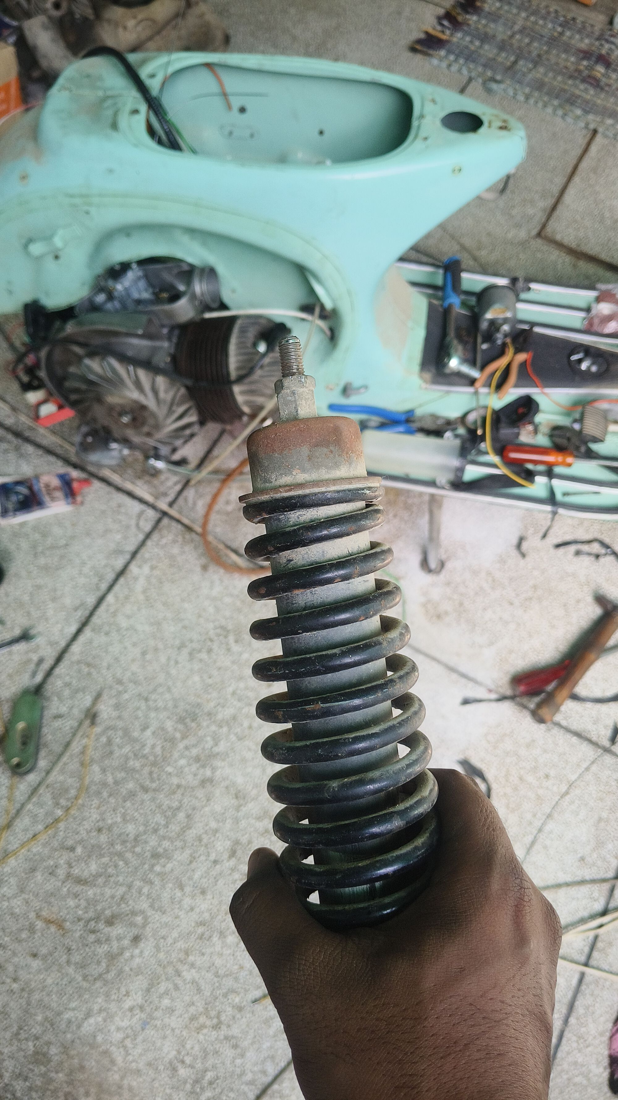

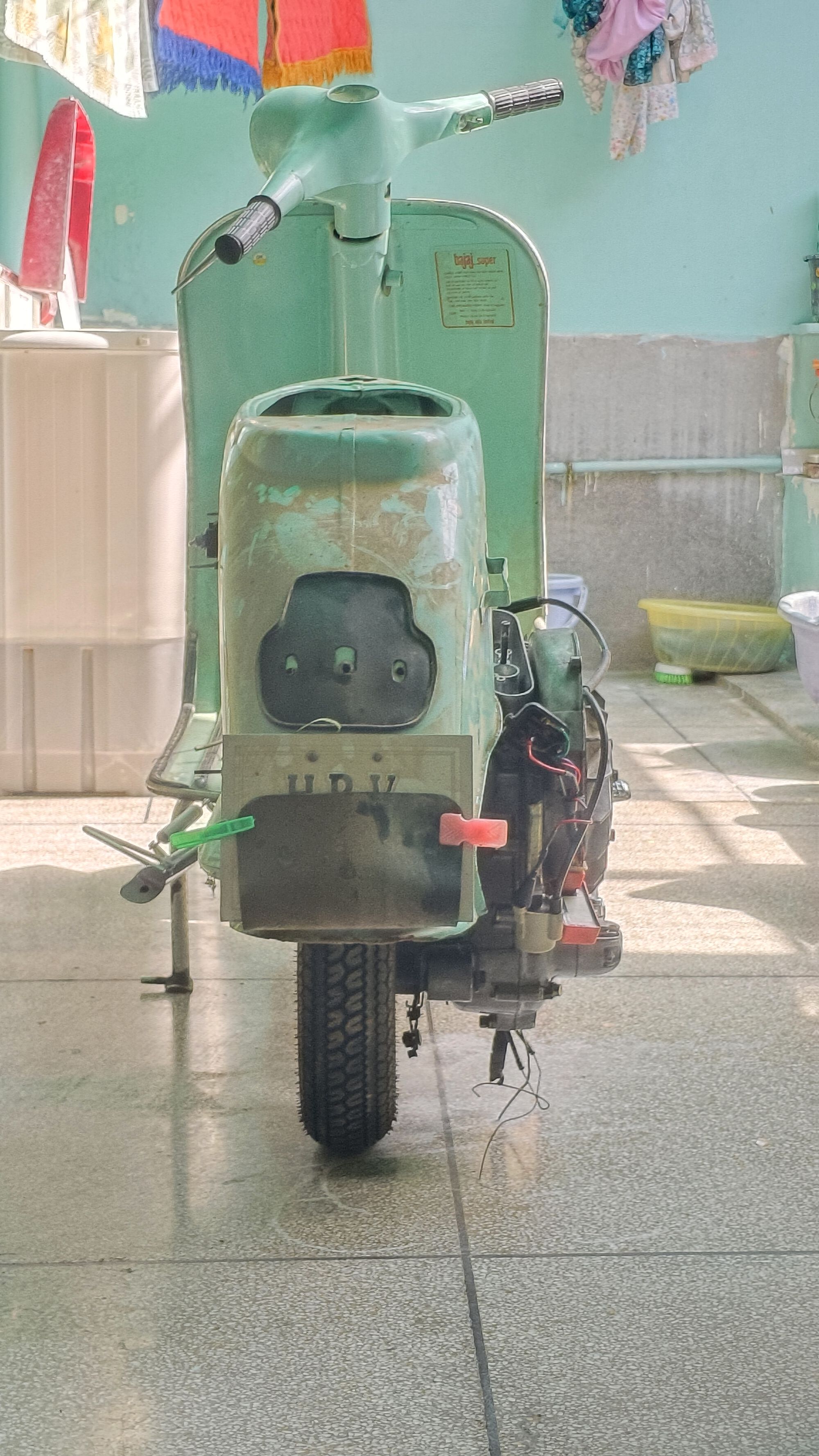

Well I am attaching the another photo here and the issue is resolved, the shock was enlarged by using a bolt so it's factory stock now and everything is fine check the alignment in the photo.
Could you please explain this better?

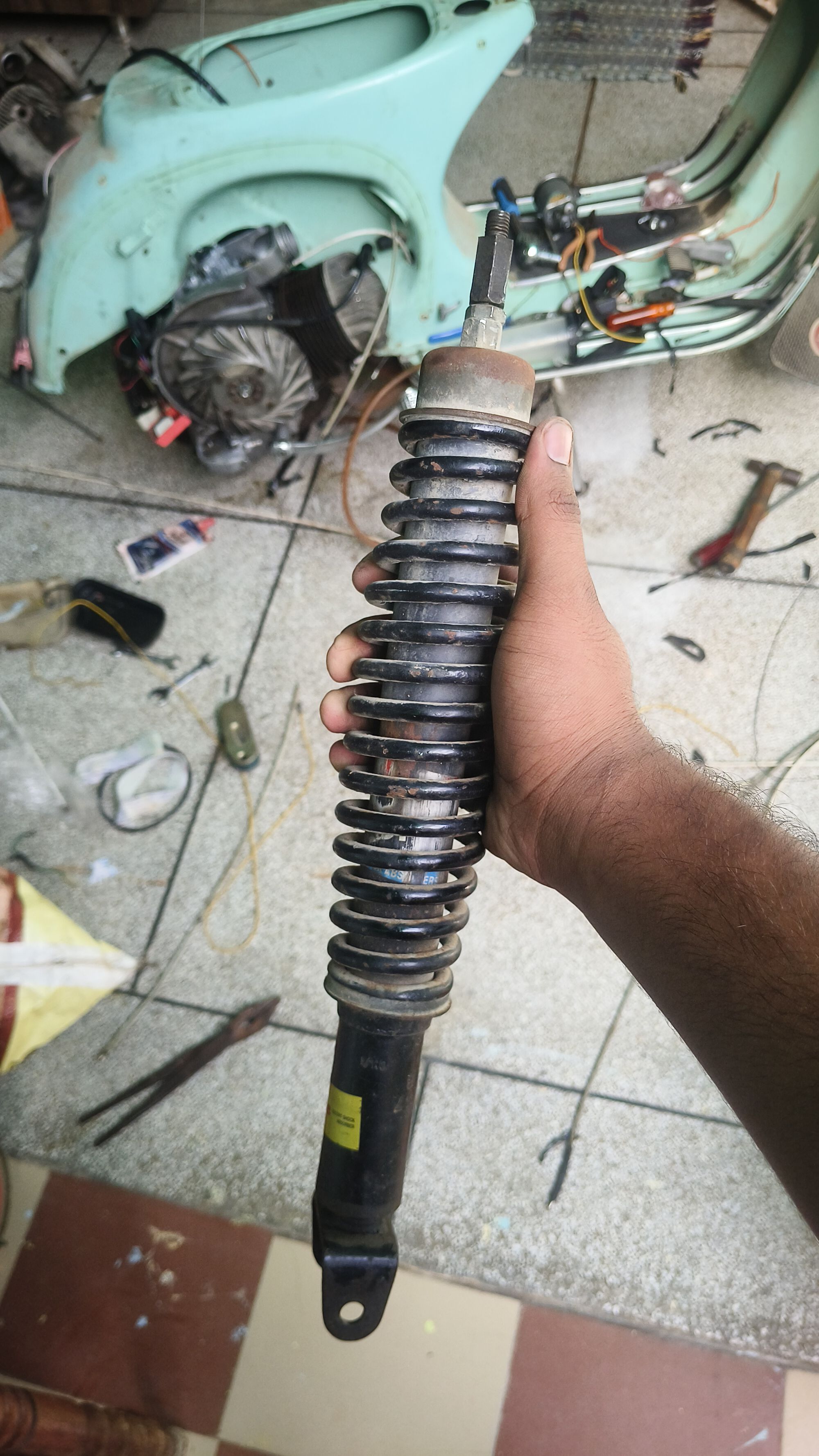

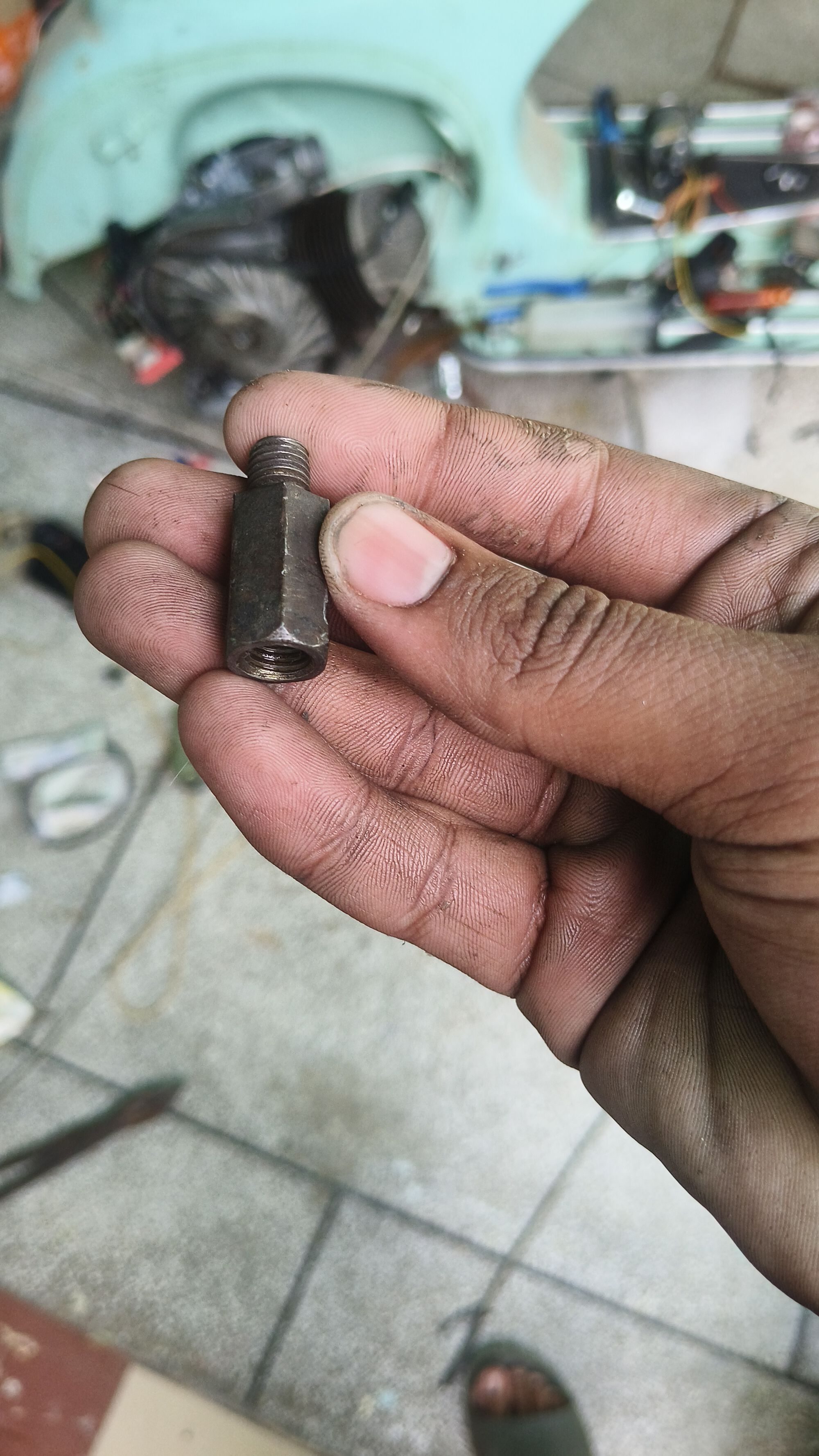

Yes I am adding the pics so u would understand it better.
Normal shock
Normal shock
Bolt to increase height of rear wheel
New increased height
Ain't touching it anymore

It stopped colliding with the chassis after removal of this bolt, this bold works best for scooters with 10" tyres mine is having 8" so chassis is diff, u can use it on sprint models or lml vespa stellas and other things, this bolt is reliable and offers more stability to your shock and comes with a increased height too, it only damages the rubber damper which is installed above the shock to mount it on the chassis.

As far as stability goes, it seems to me that all the forces locating the motor to the frame are at the swing arm bushings. I have never understood how the composition of the top buffer has anything to do with handling as all the forces between the frame and the rear of the motor through the shock are purely linear. Different springs/rates or different shock designs or ride height, sure. But that small block of rubber/poly?
