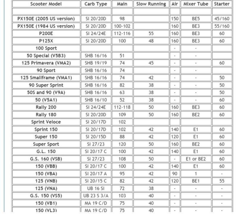

I am looking at a database and from what I see, only two models came with 20/20s. The PX125 and the Rally180 which is quite a spread.

I am just going from this sheet. I see I missed the PX150.
