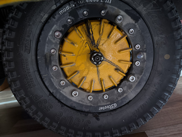

I have some gearbox oil leak at the rear hub nut.
But it doesn't leak into the brake drum but it got squeezed out at the hub nut.
There's no oil inside the brake drum so the seal is intact.
I've never seen like this.

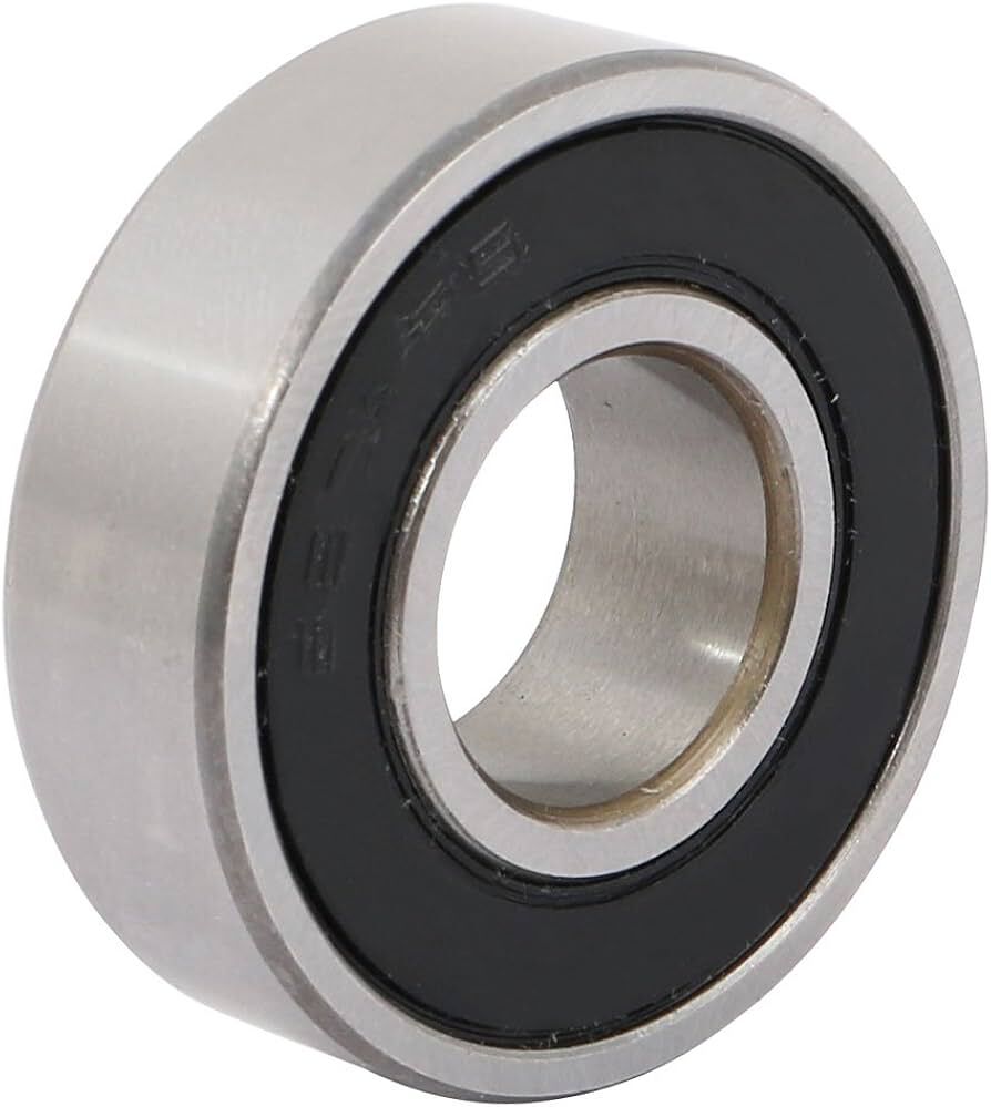

Also, when you replace the bearing it's worthwhile fitting the type with covers like this. I usually take off the cover facing into the case so it's still lubricated by the gear oil. They're not a seal as such, but I think they do tend to hold back oil and let your actual seal work a bit better.

The rims are from Indonesia, a Pinasco ripoff since European manufacturers notoriously neglect 8 inch VBC riders when it comes to tubeless solutions and disc brake upgrades. I use them with SIP tubeless tires and they work flawlessly. As for now it's the only rim that offers tubeless feature for 8 inch VBC wheels.
That's an "RS" bearing. I installed the "ZZ" version but the oil isn't leaking there.

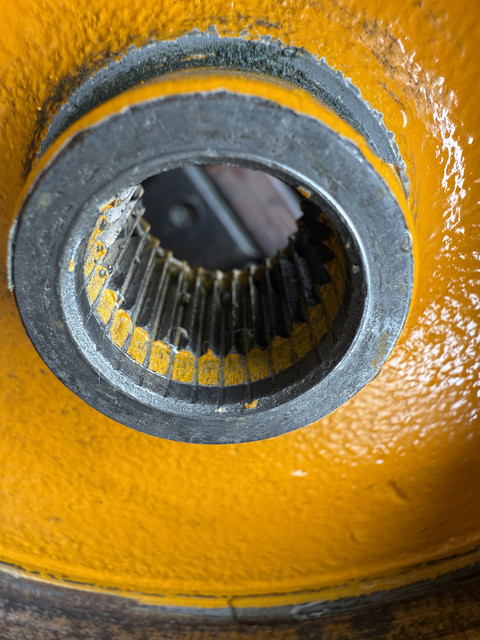

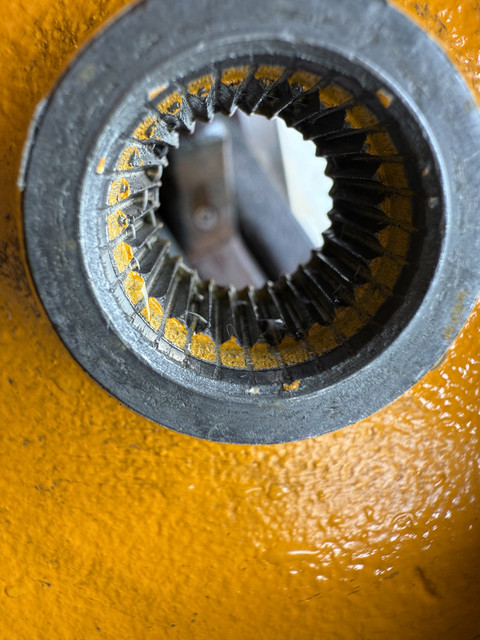

I lifted up the scoot onto the jack stand and I could spin down the hub nut with a pair of needlenose pliers it was that loose.
Anyways I can't really see any damage to the splines. It just came loose bypassing the cotter pin somehow.

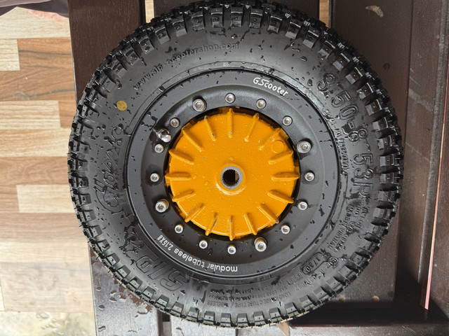

And a clean closeup of the rim.

I have a socket with a long bar so I can stand on it to do it up super tight. And a wheel holder so it doesn't move while I'm doing it.
Hub looks fine, how about the axle?
