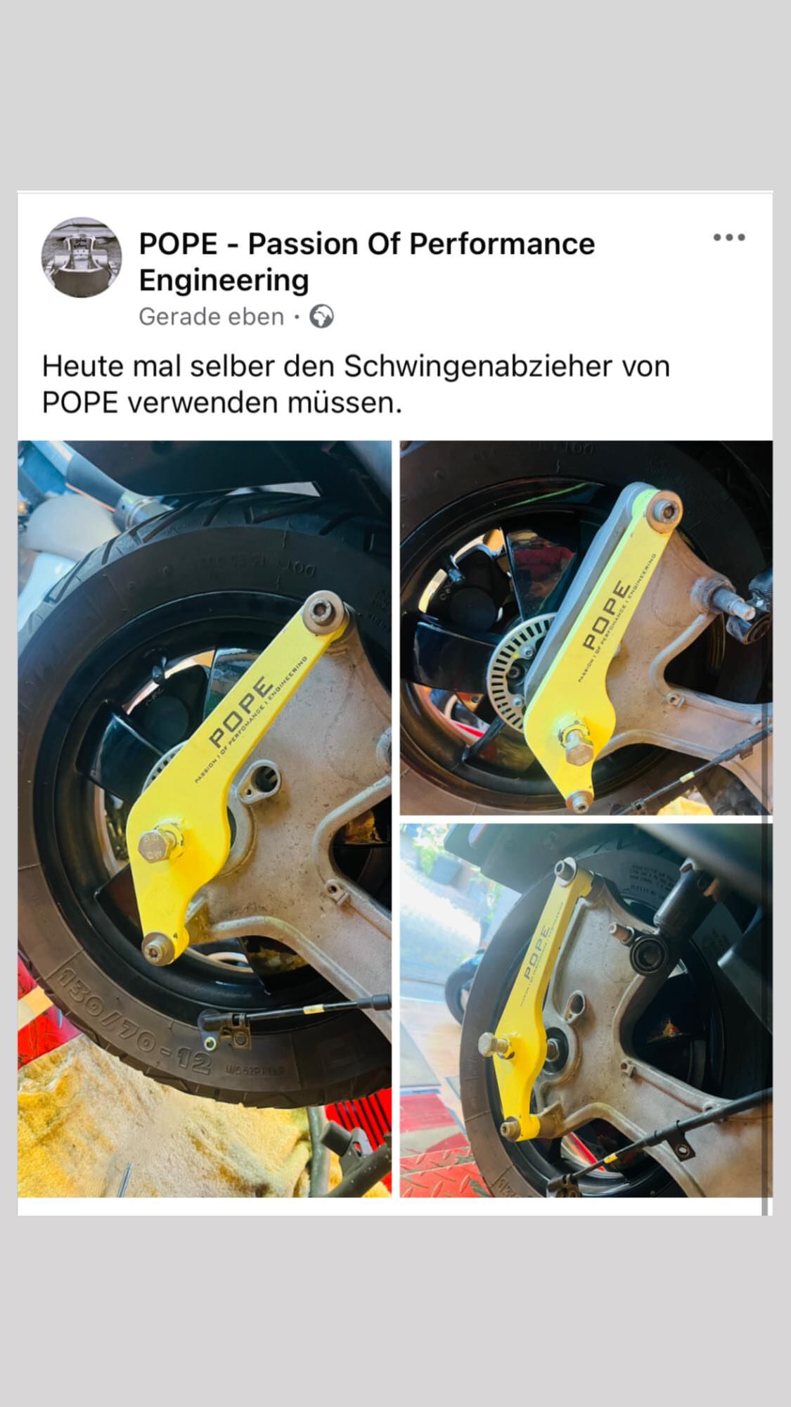

Or this
https://pope-passion.myshopify.com/products/abzieher-fur-schwingarm

Thans SteelBytes , just what I need.
I have emailed them, as they don't ship direct to the UK.
Hopefully I can buy one, as this looks like the tool to remove.

If there any German Vespa forum members here, then I would appreciate it you would buy the swing arm tool.
I would obviously cover all your costs, but it looks like the manufacturer of the tool only ships to Austria, Switzerland and Germany.
If you could purchase the removal tool and have it delivered to you, then forward on to me in the UK.
