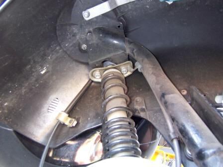

Strange problem on a relatively new Bärchen's Tech 300: 2 screws (M8x25) which are connecting the (upper) baseplate of the front shock to the steering got stuck during removal and, due to almost cheese quality of the screws, the cylindrical heads with inner hex profile got damaged Facepalm emoticon unscrewing process started correct, right tools were used and halfway during extraction got stuck. Both of them. Until the tool ate the hex profile and further work was left half-way done. Due to low available space, using pliers on the outer surface of the cylinder head of the screws was impossible. Crying or Very sad emoticon
The screws extractor tools are ordered, but am really worried if that manages to get them out.
Was thinking on using lighter or small flame gun to heat up the parts on the steering in same time when using extractor tool, but the vicinity of the plastic mud fender scares me.
anybody with similar experience and maybe with some advice how to loose those 2 screws without damaging the plastic parts around?
food for a thought ...
MV's web site example photo of the problem, not the Tech300's real situation

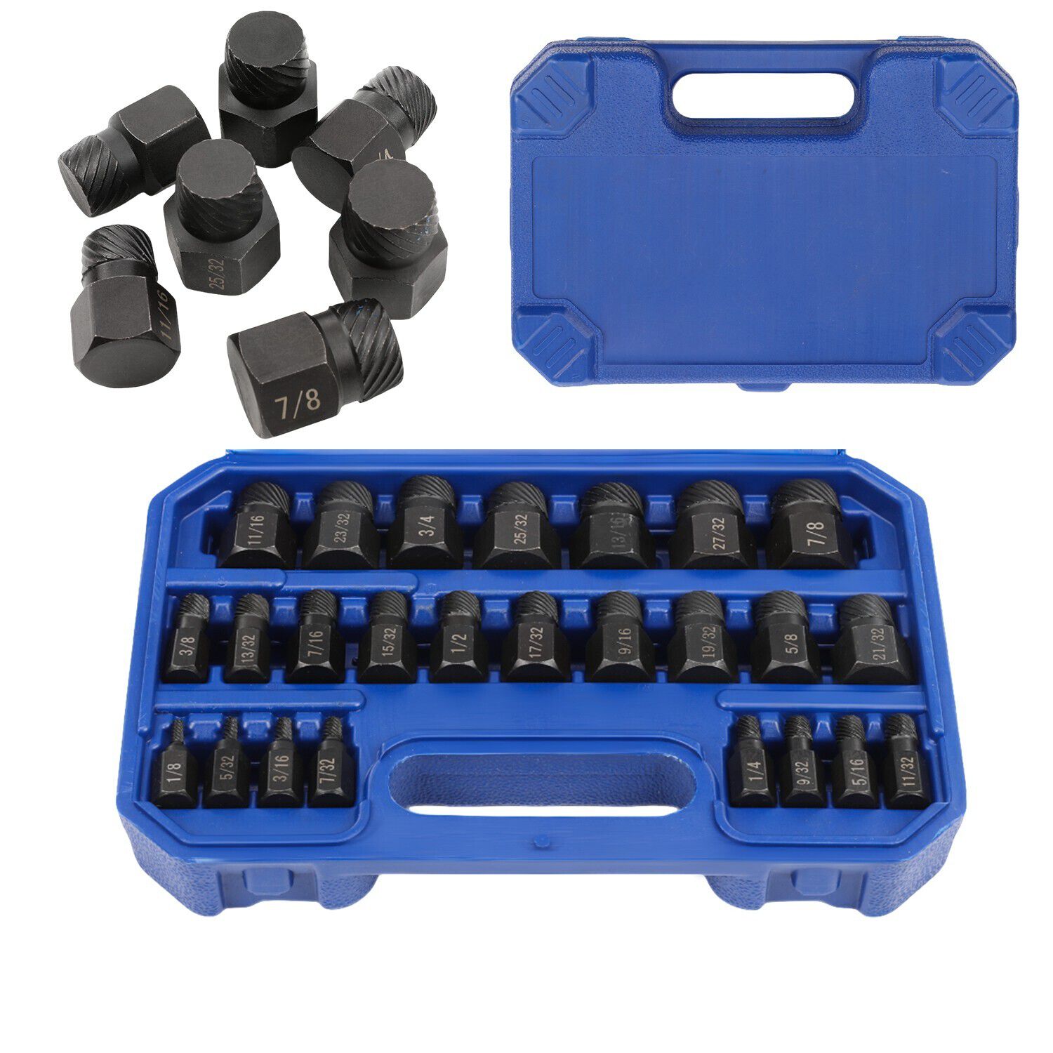

carefull heating was tried, no success
have tried also pounding Torx size 40 to it, no success, just got bigger counterbore hole Facepalm emoticon
let's hope that I manage to get my ordered tools on monday and try with them
these are tools ordered (and delivered to neighbour)
