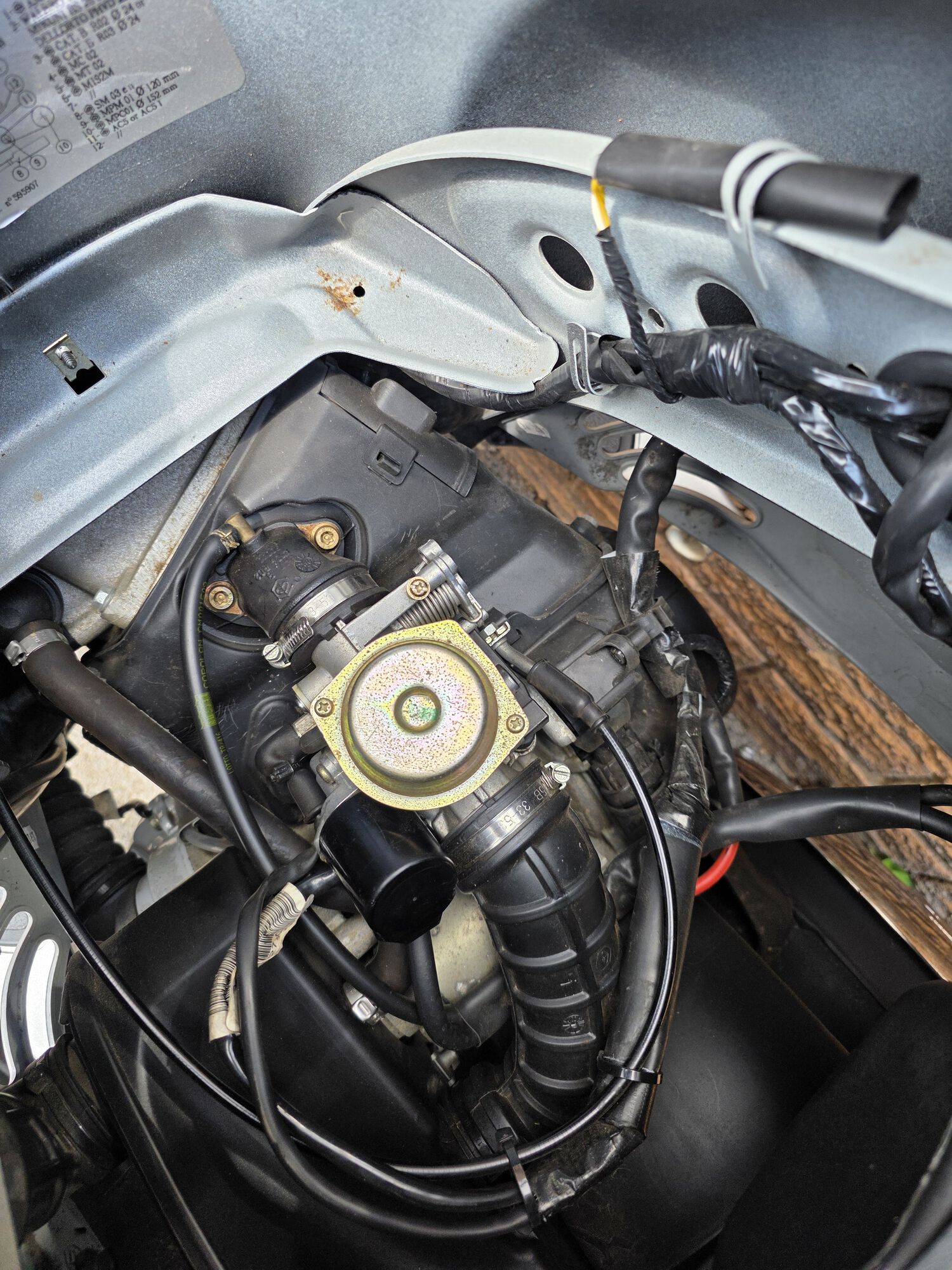

Hi my 2001 et4 is basically refusing to start without throttle and im unsure to which carb i have I think its a walbro.
Hopefully get if off and have a look this weekend

Stripped carb down gave everything a good clean reassembled and now she starts straight up.
Idle screw ended up 1 ⅔ out for a smooth Idle but seems to be out is lean could anyone clarify if this is correct on a walbro wvf ?
Cheers

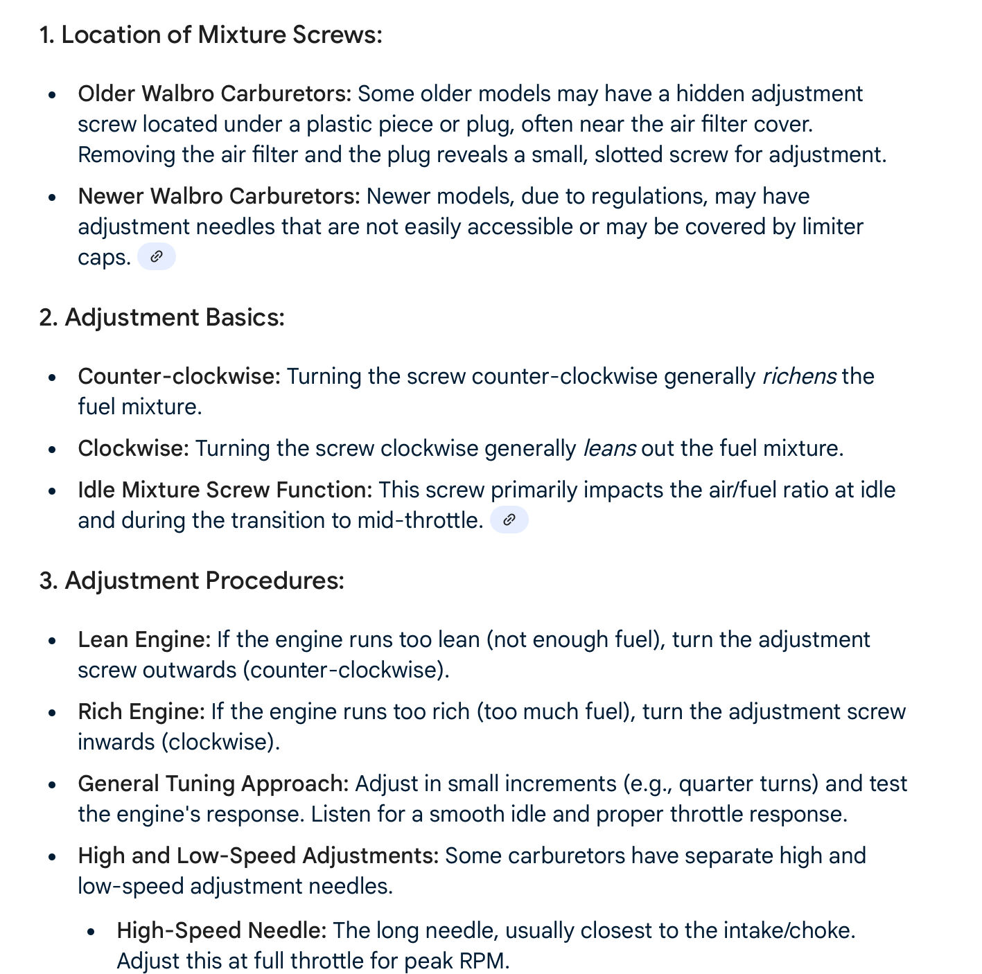

According to this info I found, opening the screw (counter clockwise) makes the mixture richer.

Ok great cheers for the advice.
