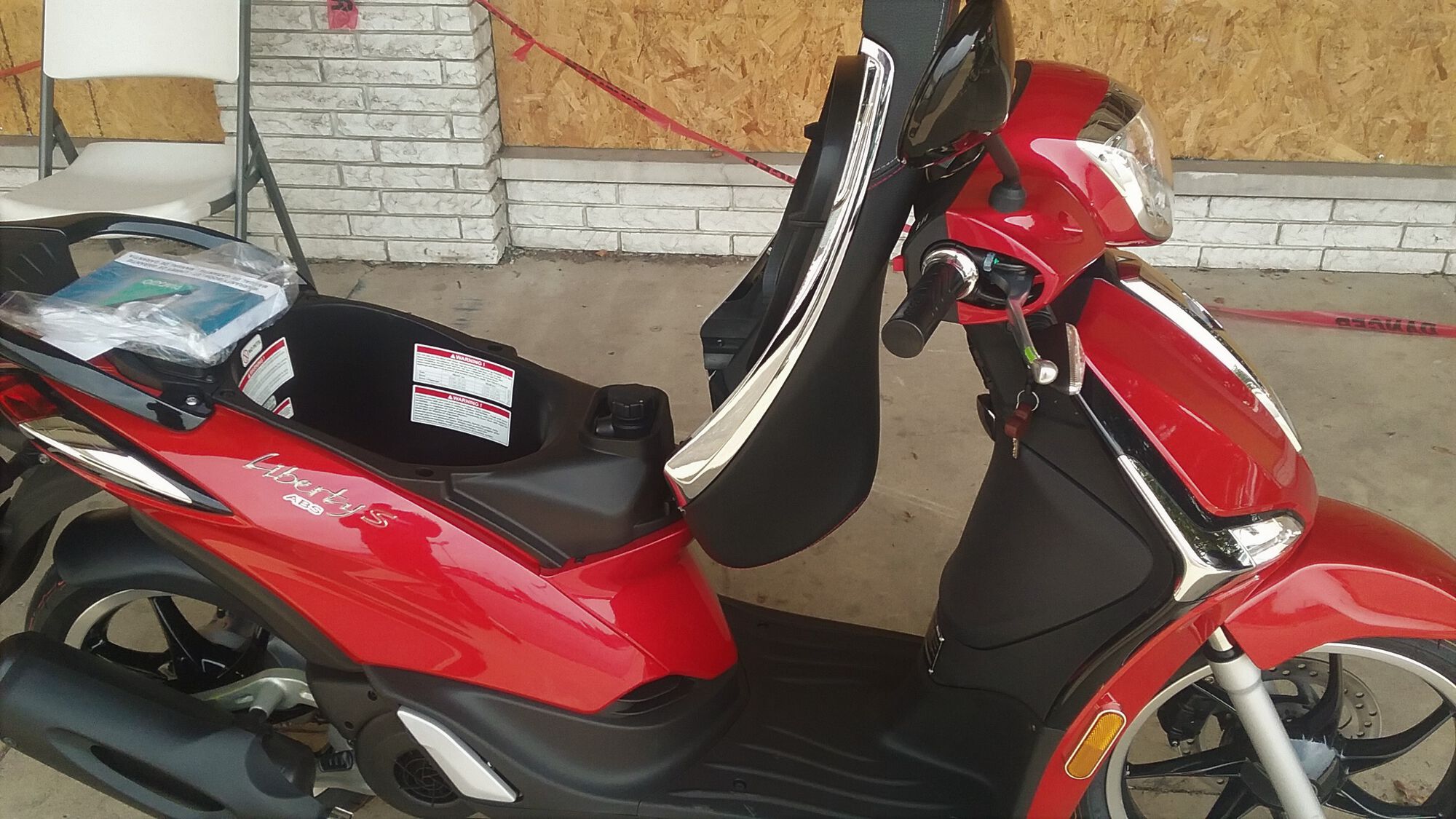

I'm relying on my limited skills to sort things on my Liberty - bought it at a Vespa dealer 35 mins away. He was cleaning up after a small tornado strike as I purchased my Liberty.
In spite of his assurances - he closed his doors a few weeks later!
Honestly - never understood his business plan - "let's open a Vespa dealership out in the sticks of Ohio!"
That was 8 yrs ago.
Heck, if it blew up tomorrow - I figure I have had my money's worth of fun with it.
I'd drive a couple hours and bring home another one - but not the ugly '25/'26 model with those LEDs. Design is a mistake!
anyway - has been a flawless runner since the summer of '17!

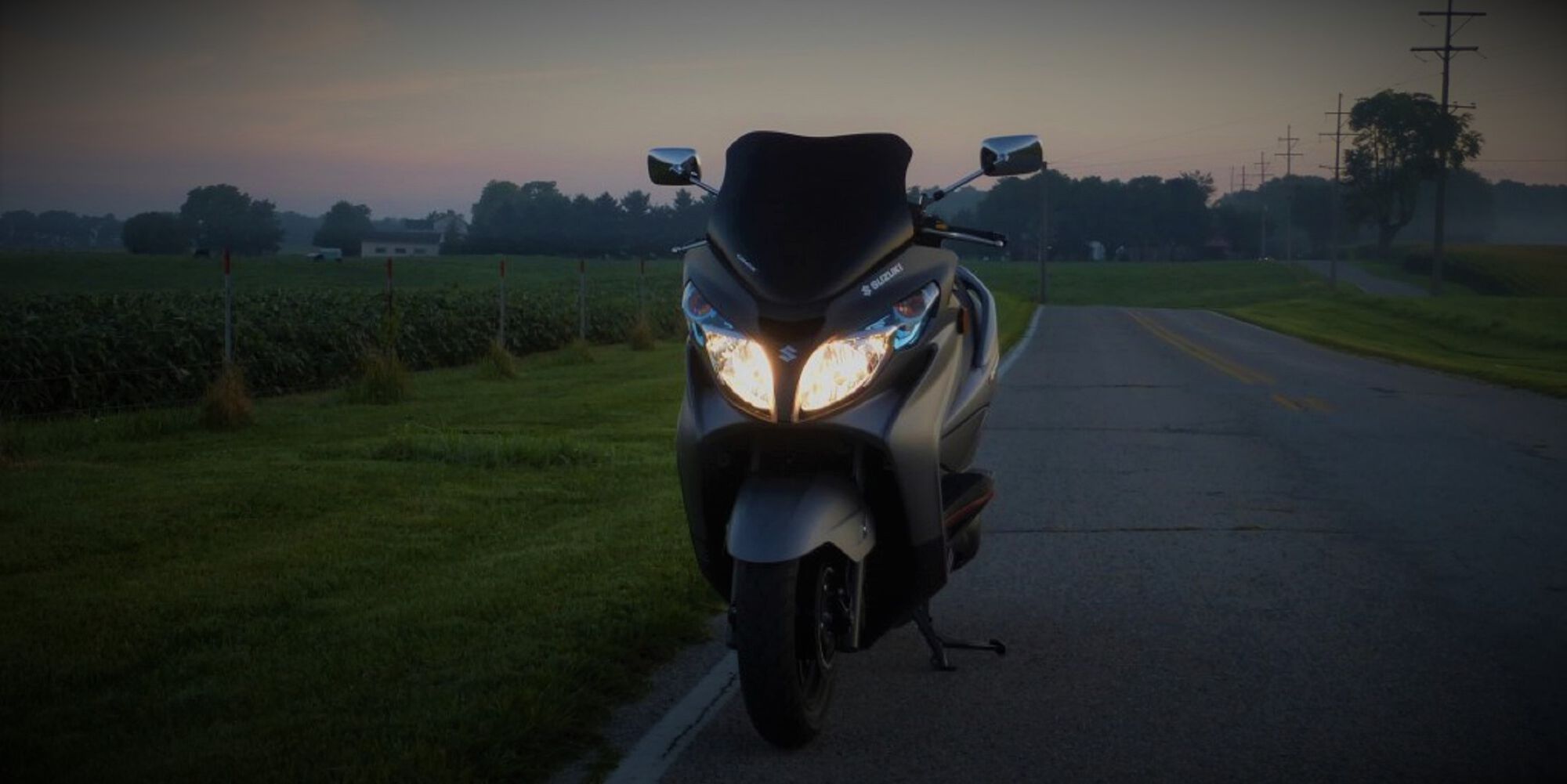

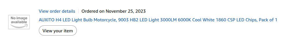

I was really happy with my LED bulb results. I didn't even mess with headlight trim. I think they have a new model as I can't find the exact one I got. But, here's a snippet of the amazon one I ordered.
The big watch out for this one is the "tabs", there's like 3 of them that rotate to lock it into the socket, and they are fatter than the halogen one. So, I had to be really careful installing it not to break anything. I got it in without breaking things but it was really tight.
Afterwards, it just worked and WAY brighter than stock light. I felt very comfortable riding in the dark with it.
