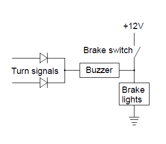

Auto cancellation is available on some big m/c but I have not seen it on a Vespa.
Some here have added an audible accessory as a safety measure to prevent riding on with your indicator flashing.
I'm guessing this is the root of your question??
Posts: 46358
Posts: 46358
Two diodes and a buzzer for less than $10 and you're all set. Or spend a lot more on a kit that doesn't quite do the same thing...

OK - back to the diodes:
You need to connect the cathodes of the diodes (the ends with the stripes) together and also to the + side of the buzzer (though some buzzers may not worry about polarity). The anodes of the diodes (the non-stripey ends) each need to be connected to an indicator wire. One is pink, the other is white/blue.
The - end of the buzzer needs to be grounded. Although this means a bit of extra work, I recommend grounding it via the + side of the brake light bulbs (the output of the brake light switches IYCWIM). This has several advantages:
1. The buzzer stops buzzing when you have either brake light on, saving your sanity at long-winded traffic lights.
2. If you have a brake lever pulled, but the buzzer doesn't stop, then you know your brake light switch has failed, and your brake lights aren't working - not a very safe way to travel.
3. If you have a brake lever pulled, and the buzzer doesn't sound at all, then you know your brake lights have blown - again, not a very safe way to travel.
