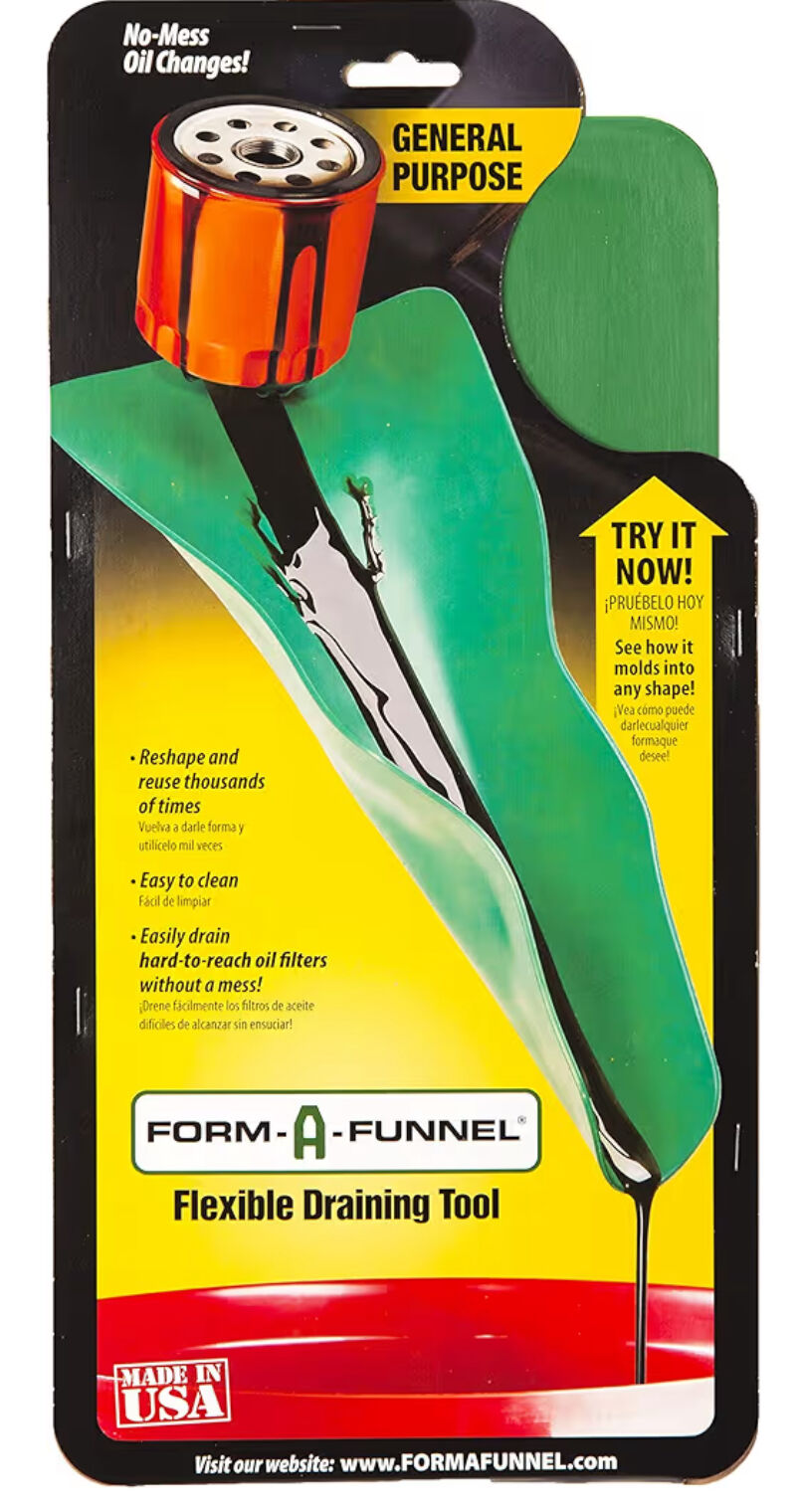

The best thing I ever bought to change the oil on all my Vespas is this funnel. I bend it in such a way that it channels the dirty oil away from the center stand. I bought it from Amazon a few years ago. I use it to change the final drive oil as well. I don't spill a drop of oil on my garage floor anymore.

It's uncannily similar to a She - Wee.

Awesome sauce. I NEED one/two of these.

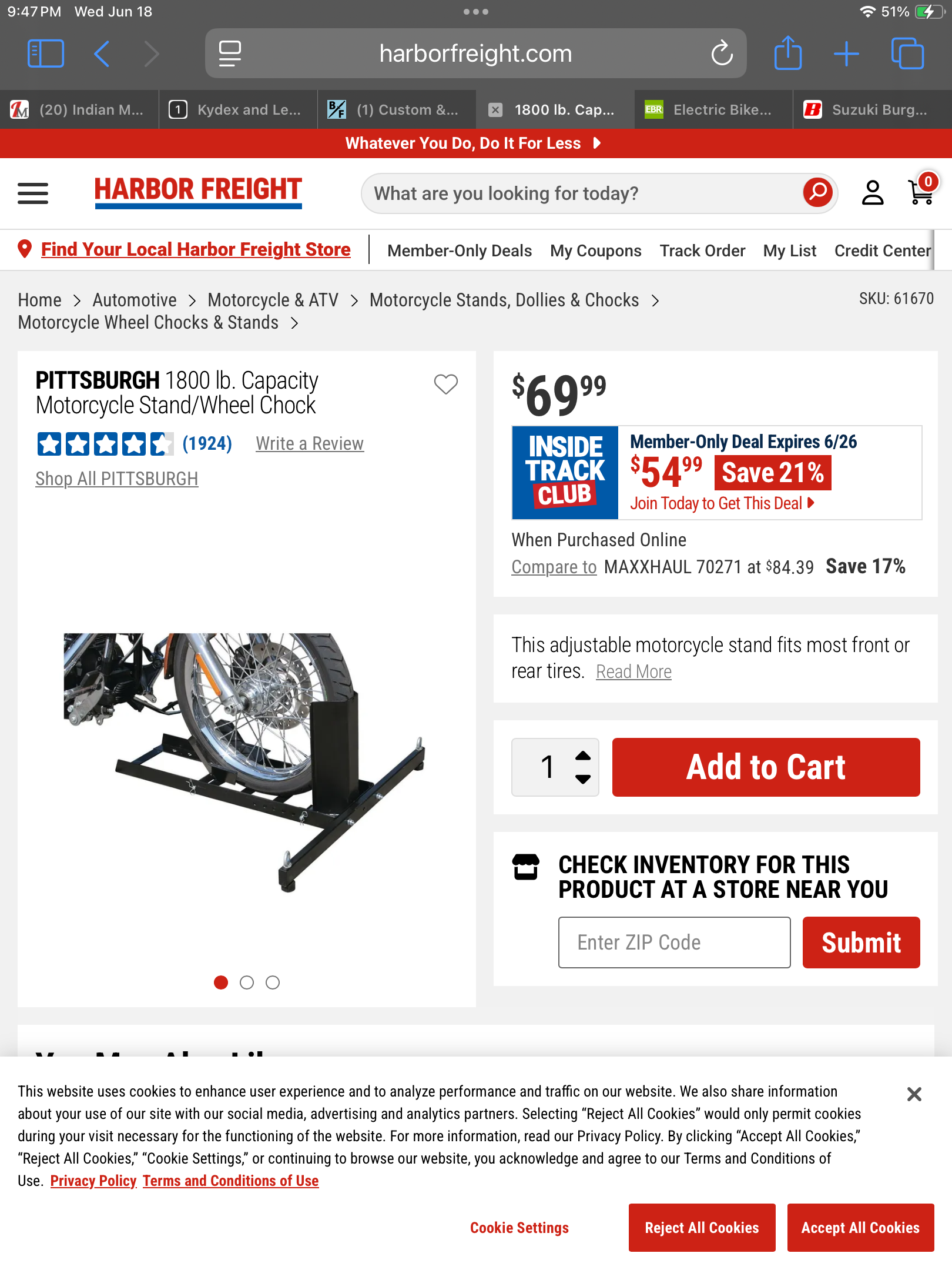

Harbor Freight sells a wheel chock that allows the MC or Scooter to be held upright. Check fender clearance before use. However you don't need anything if drain oil while on side stand a few minutes, then hold upright a couple minutes, then put drain plug back in. Then put on center stand to change filter. Works for me.

This may help, especially for longer term ( overnight) maint work. Reduces the risk of anyone bumping or knocking scoot/bike over.

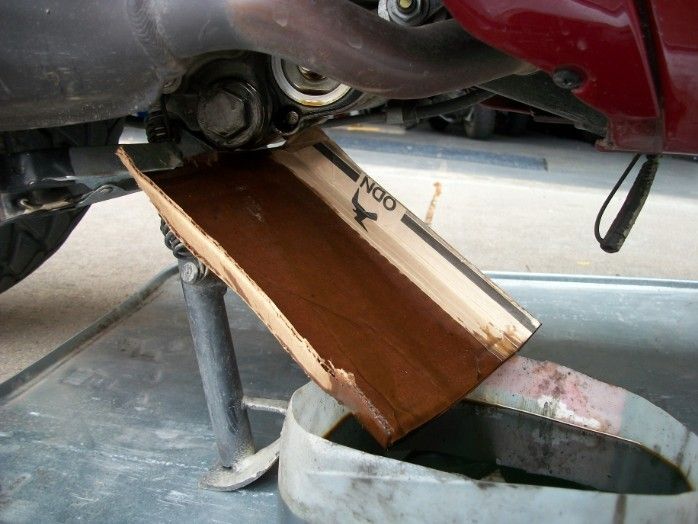

Easy to store, easy to use, and costs nothing.

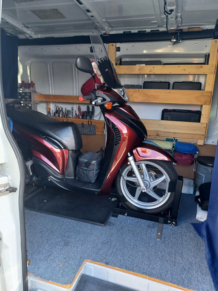

This is where I change the oil.

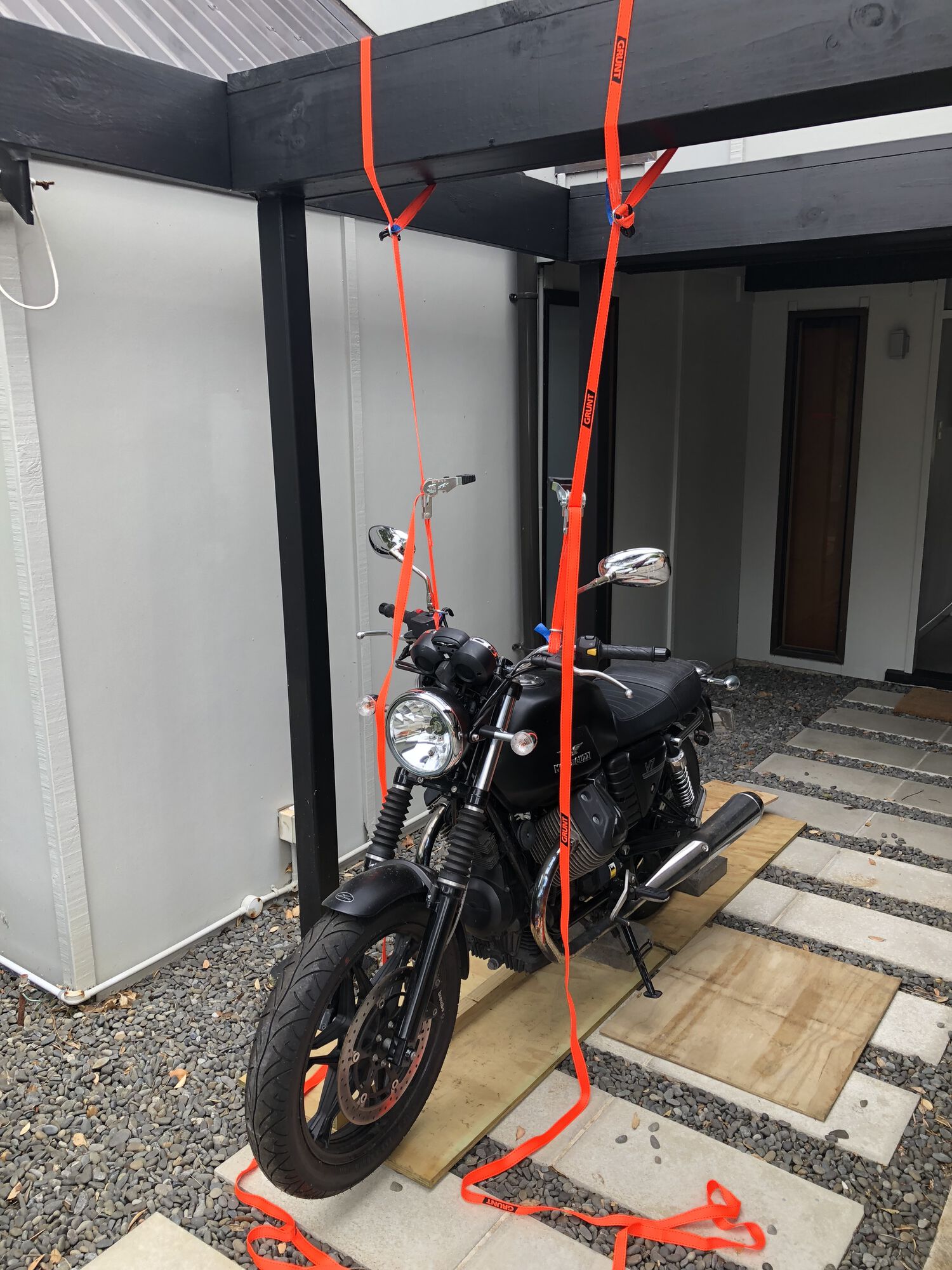

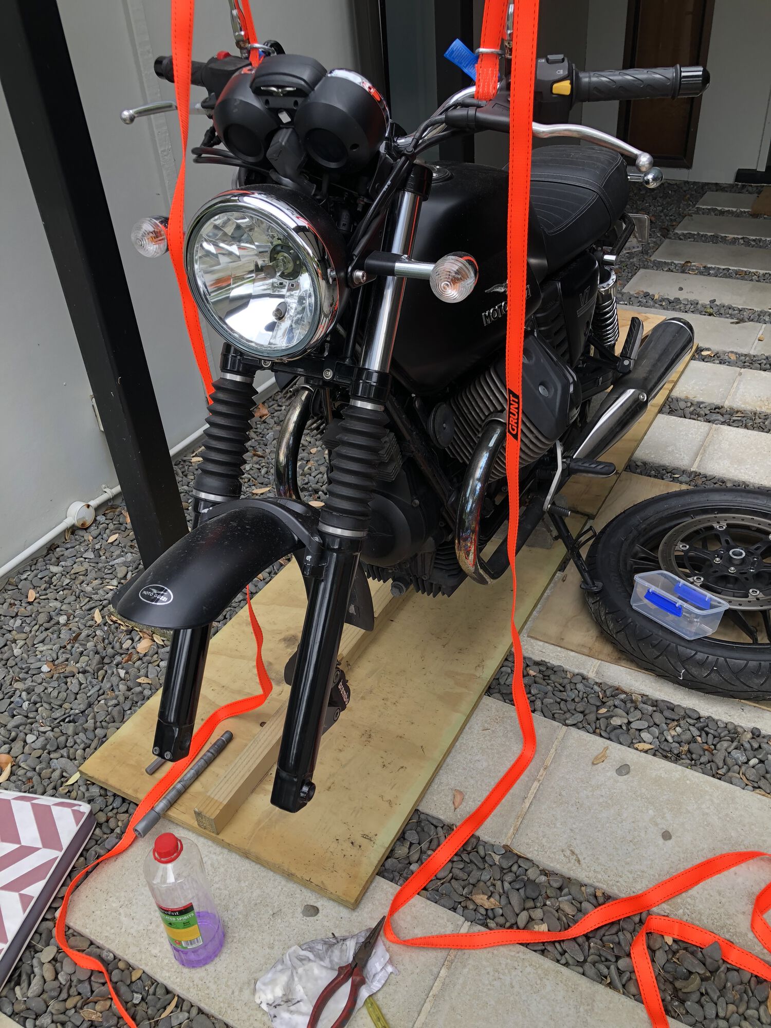

A few years ago I used cargo straps from an overhead beam to lift my Guzzi so I could drop out the front wheel.
It worked exceptionally well.
