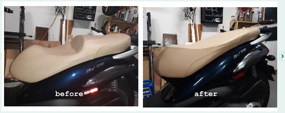

Are you handy at all? I put my BV250 through a humpectomy. Before it felt like wearing a pair of vinyl Speedos that were 2 sizes too small. Just as important, I took off almost 2 inches at the front of the seat.

Wow how did you do the lumpectomy?? Thats very impressive!

I went whole hog on this: Beverly seat reshape - Oh my steaming arse. On my GT200, I took the horn down at the front, smoothed out the hump, and just re-stapled the stock cover.

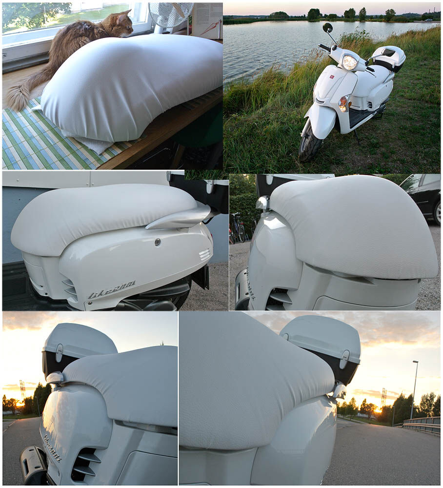

Earlier days I notised my Kymco Like had too thin seat, so I filled some stuff, over the old. Only problem that I could not find vinyl thin enough to be easy to strech over.
