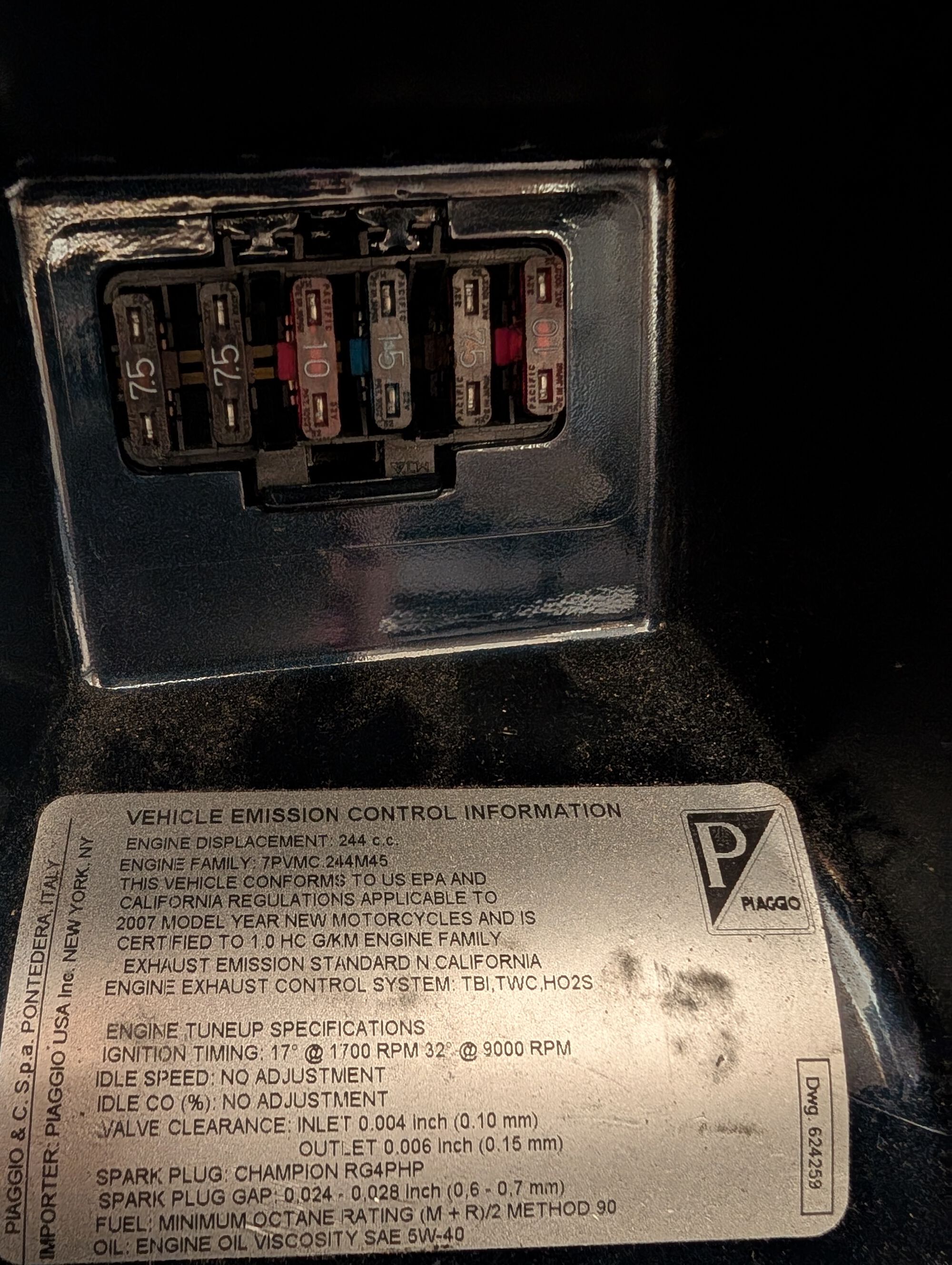

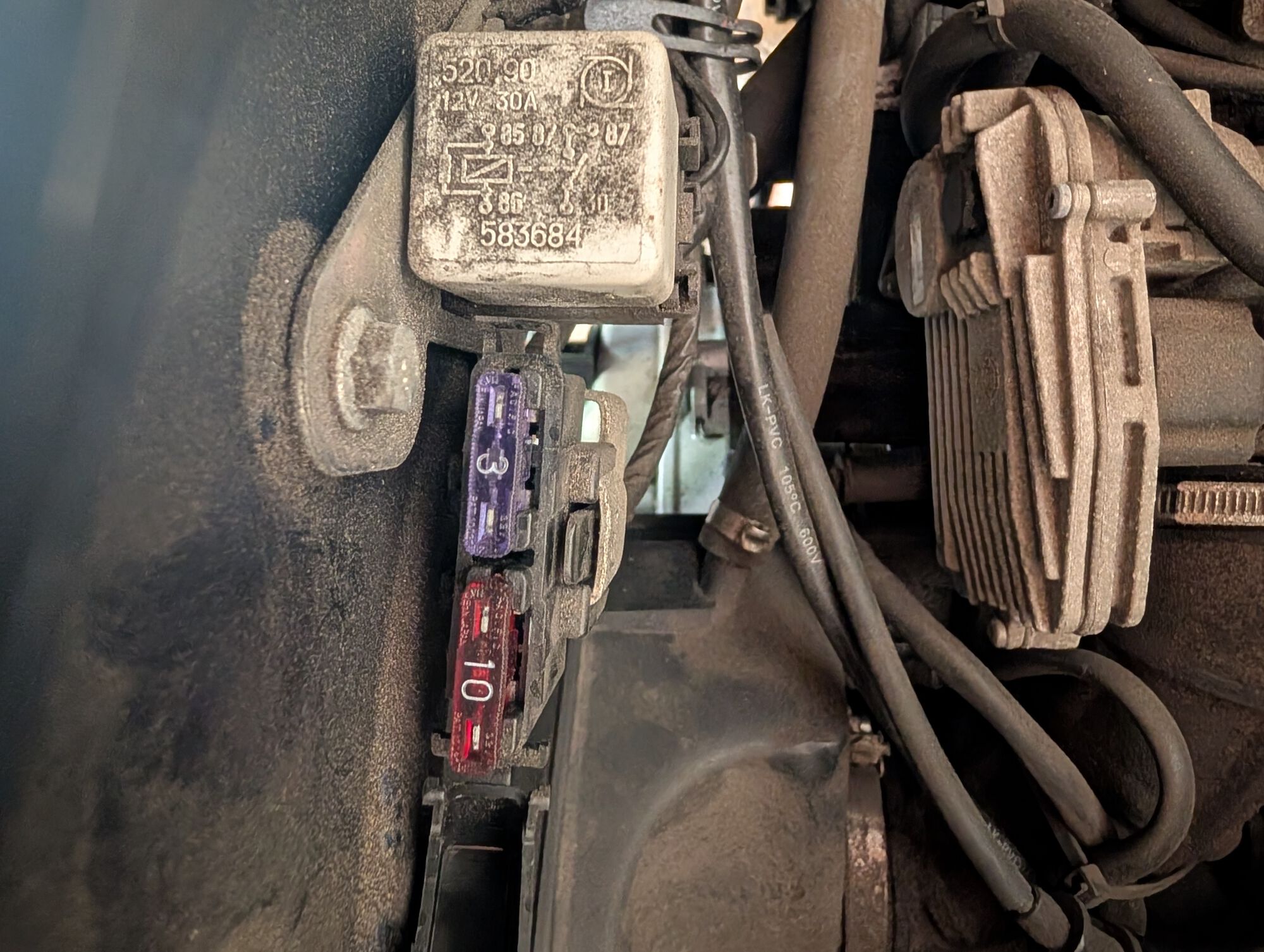

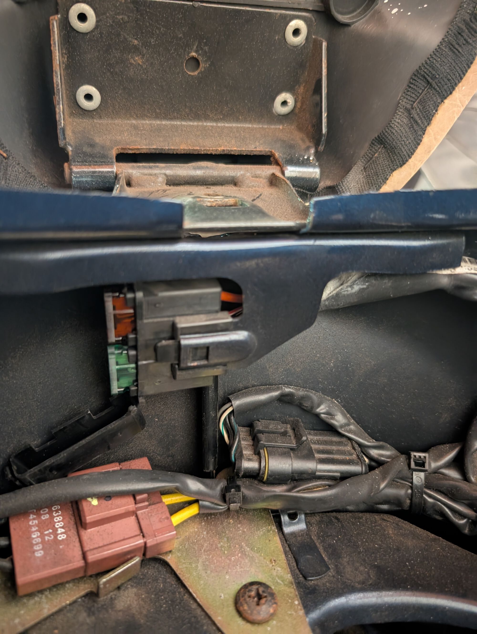

I checked all the fuses- glove box and two sets under the seat. They all were intact. I have attached the pictures of the locations of the fuses.

Glove box
Glove box
Under the seat, near the seat hinge
Under the seat on the left side

The whirring sound when you first switch on is a good sign - it means the fuel pump has activated for a couple of seconds - as it should.
If the brake light don't come on, then it'll never start - the starter relay gets its power through the brake light switches and the starter button. It also gets its coil grounded by the ECU when the ECU knows it's OK to start, i.e. kill-switch off etc.
Firsst thing - check the brake light circuit. Could just be both switches faulty - surely not, people say, but it's far more common than most folk recognise. It's 50-50 whether just the left or both brake light switches have failed if the bike won't start. A very common fault.
If you get the brake lights working, but the bike still won't even turn over, then suspect the kill-switch is faulty. Just working it 20 times or so often gets them working again, but replacement is often the best answer.
Have you measured the fuses (as recommended) with a multimeter or a test lamp or just checked them visually?
Posts: 46114
Posts: 46114
And removed and replaced each one a few times to clean the contacts? I suspect they're good because the fuel pump worked...
