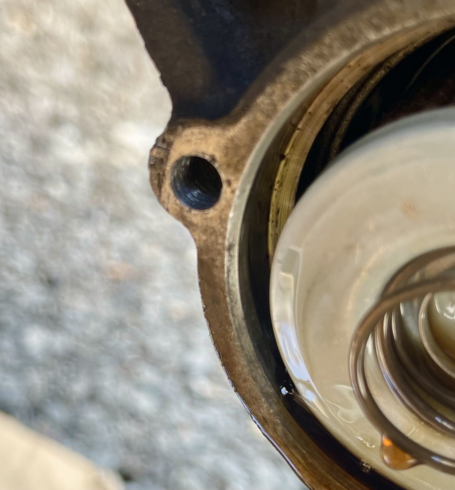

I know it's pretty f@@ked. But just how f@@ked?
Had to remove the oil filter cover (later 3 bolt design) on my BV350 to put in a new spring (new bike to me, changed the filter last week and discovered the bolt was missing, so ordered one).
Took the cover off no bother. Put in new spring. Replaced cover and seated it, carefully, and I do mean carefully, started to screw the bolts in, by hand. Started to finish them off with a socket and with almost zero pressure this bolt in question tightened ever so slightly, then kept going. Knew immediately what had happened.
Now yes, this might have been me, but I don't think so. Either way, I'm now a bit fecked!
So, two questions…
1. How can it be repaired?
2. Is it even possible to use it with just two bolts?
Please be gentle with me. I'm rather devastated right about now!

Looks like it's been over tightened and it's pulled the thread out.
There's probably a man out there who could helicoil that.

I did say go easy on me!
Yes, it looks like it's been overtightened. Thanks for that.
I'm concerned there'll be enough metal to helicoil it. I've helicoiled pushbikes before, but never something with such thin walls.

If that were mine, I'd helicoil it.
You don't have many other options, and at least it's easy to access.
I definitely wouldn't run it with just 2 bolts (pretty sure the would leak and maybe oil pressure problems too).

You might be lucky as it looks like there's just enough metal to make a seal.
The Helicoil Guy might have something that will fill in that missing chip if you ask nicely.

It's way above my skill with a helicoil, so will look out someone who can do it.
I've put it all back together with an ever so slightly longer bolt, which nips up ok. I'd say it's a little over hand tight. The other two are tight as they should be.
Gonna run it and prey, and get it in for helicoil repair asap.
I did google "oil filter cover stripped bolt hole" and I'm clearly not unique! There are pages of similar issues. KTM seems to be a popular victim.

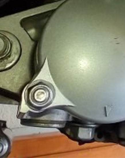

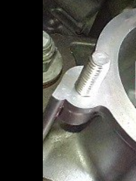

A. Cut the head off the correct size bolt, and JB-Weld it in place. Clean out the hole real good, go slow, be sure it's perpendicular to the face. B. be more careful on the next oil change.

I've managed to get it all back together with a slightly longer bolt and a lot of care. No leaking over an hour long ride, so whilst I still need to sort it, I have at least got a working bike again.
A few are telling me there is (most likely) just enough material to do a helicoil. But I have to be honest, I'm moving more to the solution you mentioned; JB welding in a stud and sticking a nut on the end of it.
My thinking is that even if it doesn't hold, I'm no worse off.
I've been googling JB Weld applications, and it seems if you try to cut a thread in it it's pants. But for "welding" in a stud, in theory that should work.
The images you put up…. Is that a stud glued in with JB weld?

There's plenty of meat there for a Helicoil if the longer bolt doesn't work out. An 8mm Helicoil only needs an 8.3mm drill - get that as part of the kit. I've just had to do that with the bolts holding the timing belt tensioner on a Subaru engine. If that's a 6mm bolt hole, the drill size will be correspondingly smaller.

If you do a bodge job you'll just postpone the inevitable, better to just do it properly now and helicoil it.
I don't think there's a chip missing, the Beverly has a pry-point at every screw hole to pry off the oil filter cover, as it can be really stuck because of the o-ring.

Why is the machining so bad then ?

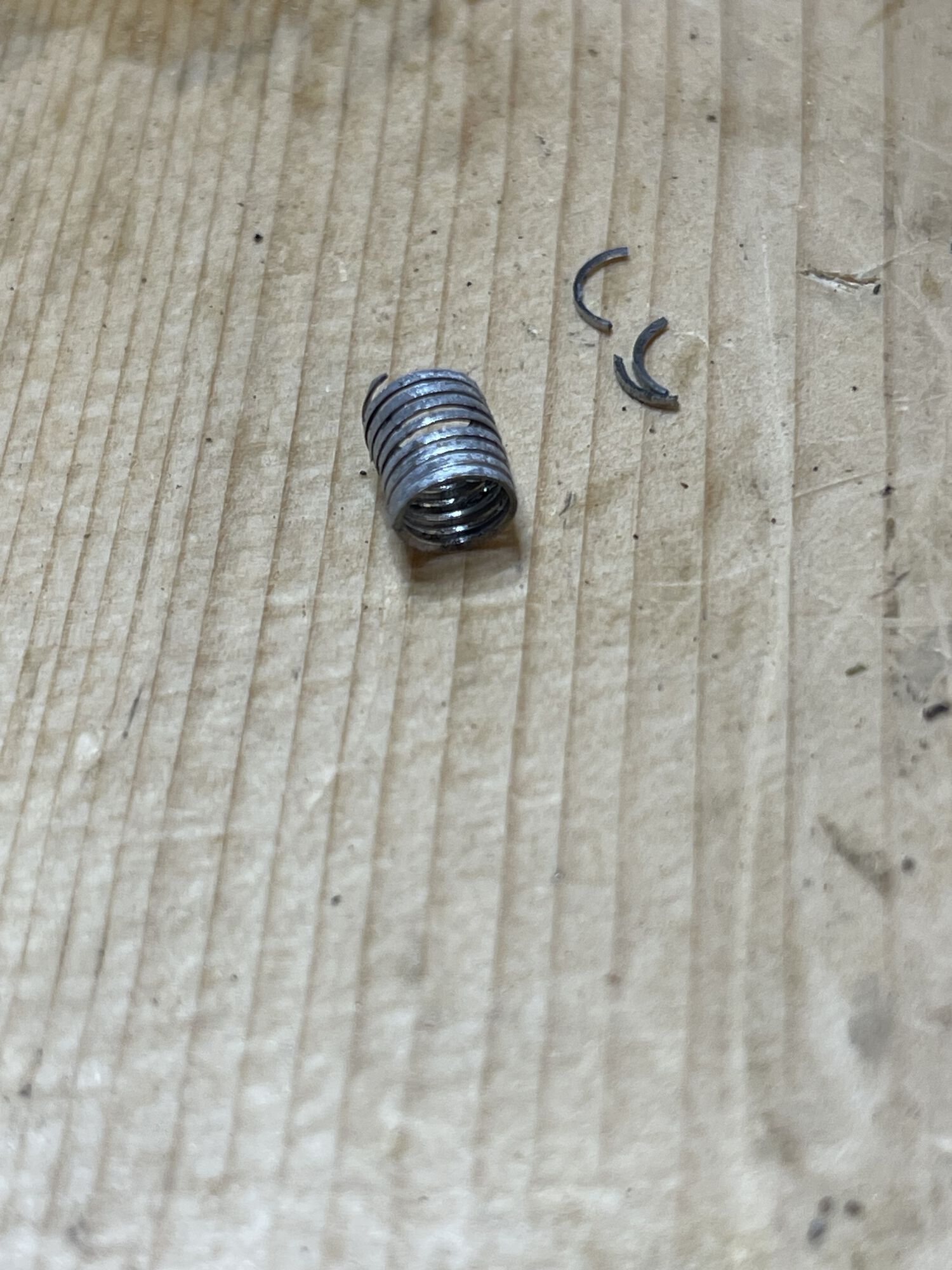

I thought I'd got away with this, at least in the short term. There were still some good threads, so with a slightly longer bolt it all nipped up OK. After an initial hour long test ride no leaks, so I thought phew!
But been out day and there is now the slightest build up of oil under the cover, so either it's leaking everso slowly, or the bolt with the minimal thread is slowly coming loose. Either way, I have to fix this asap.
I hear what people are saying about a helicoil. I've experience of these on pushbikes, but never with such a small amount of material around the hole. I understand some are saying plenty of metal, but I've not convinced. Plus, of course, a helicoil is a destructive fix. ie. if it doesn't work, it is almost definitely fucked; there is no coming back from it.
So my instinct is to go with the idea of bonding a stud into the hole, and putting a nut on the end of it, as per the post by Abner_Bjorn. This way, if it doesn't work, I still have the helicoil as a last resort.
I'd welcome the on opinions of others on this.

If you have enough thread deep inside there to get your bolt started, I think you will be in great shape. Clean the snot out of the opening with swabs and solvent. Maybe mask the surface with tape leaving just the hole exposed. Use the original 24 hour JB-Weld. Fill the hole about 2/3 full and gently thread your bolt a turn or more if you have it. Clean be sure the epoxy is packed around the bolt, and gently clean off the excess with swabs and solvent.

Thanks for that. In the pics you posted above, is this such a fix, also for a oil filter cover?
Looking at the alternatives, as a back up plan, two mechanics have looked at the pics and said they can repair. One said using a helicoil, the other said they can retap to either M7 or M8. I'm not sure there will be space for retapping. Anyone have an opinion on this?
Google says to use a helicoil an M6 holes first needs to be tapped to 6.3mm. Does that sound about right?

Less room for re-tapping than using a helicoil! Plus it'll get very confusing come replace-filter time.
Yes, that sounds just right. The kits come with the bit:

Thanks for that Jim. And agreed. Retapping, whilst a better long term solution, I don't feel is an option due to limited material.
I fired a message to my old instructor this evening, who is a local font of knowledge. He actually recommended the mechanic who suggested the helicoil fix. So whilst I was only considering this as a last resort, I think that's the route I'm going to go.
The bike will be getting parked up in three weeks for at least a few months, as I'm off to Spain. So hopefully all this will be behind me by the time I go. And in Spain I have my lovely Beverly 400 to use, so looking forward to that, as it's much quieter and smoother to ride.

Good luck with fixing the stripped thread.

A guy called Chris is calling out next week to sort the bolt. He does mobile spannering on bikes, recommend to me by Paul, my instructor. His price is very reasonable.
