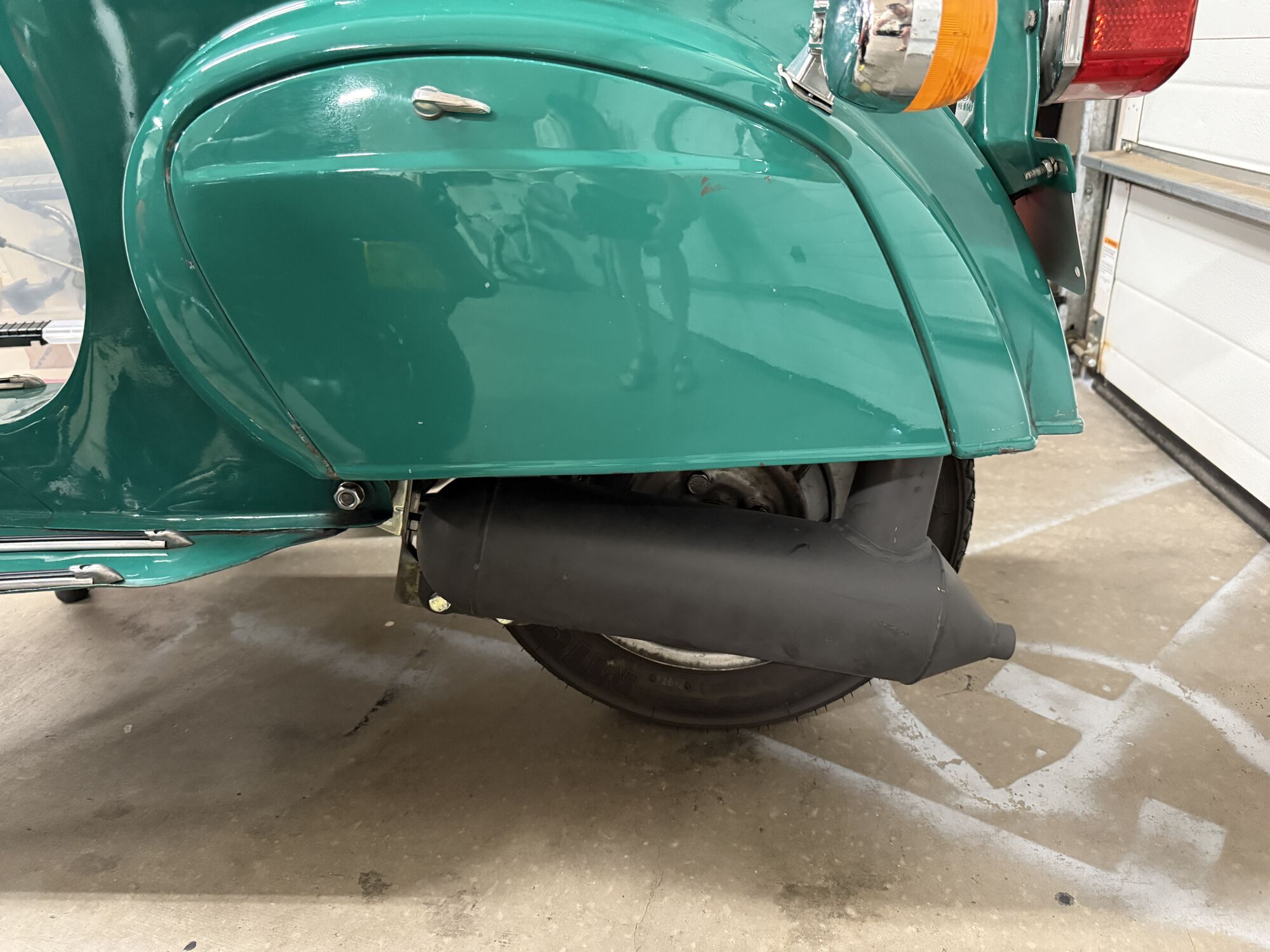

I replaced my Polini Banana with an EGIG Super
Banana touring.
It was very easy to install and the upgrade paid off well. The powerband is very smooth, but the high rpm range increased nicely with tons of torque.
I'm using it with a Malossi 136 cast iron, and Malossi Reed kit.
It's very rideable, but I need to up the gearing a bit.
I was on the fence after reading it required frame mods, but that was with a PK which EGIG states it won't work on a PK.
Long story long, it is a great upgrade.

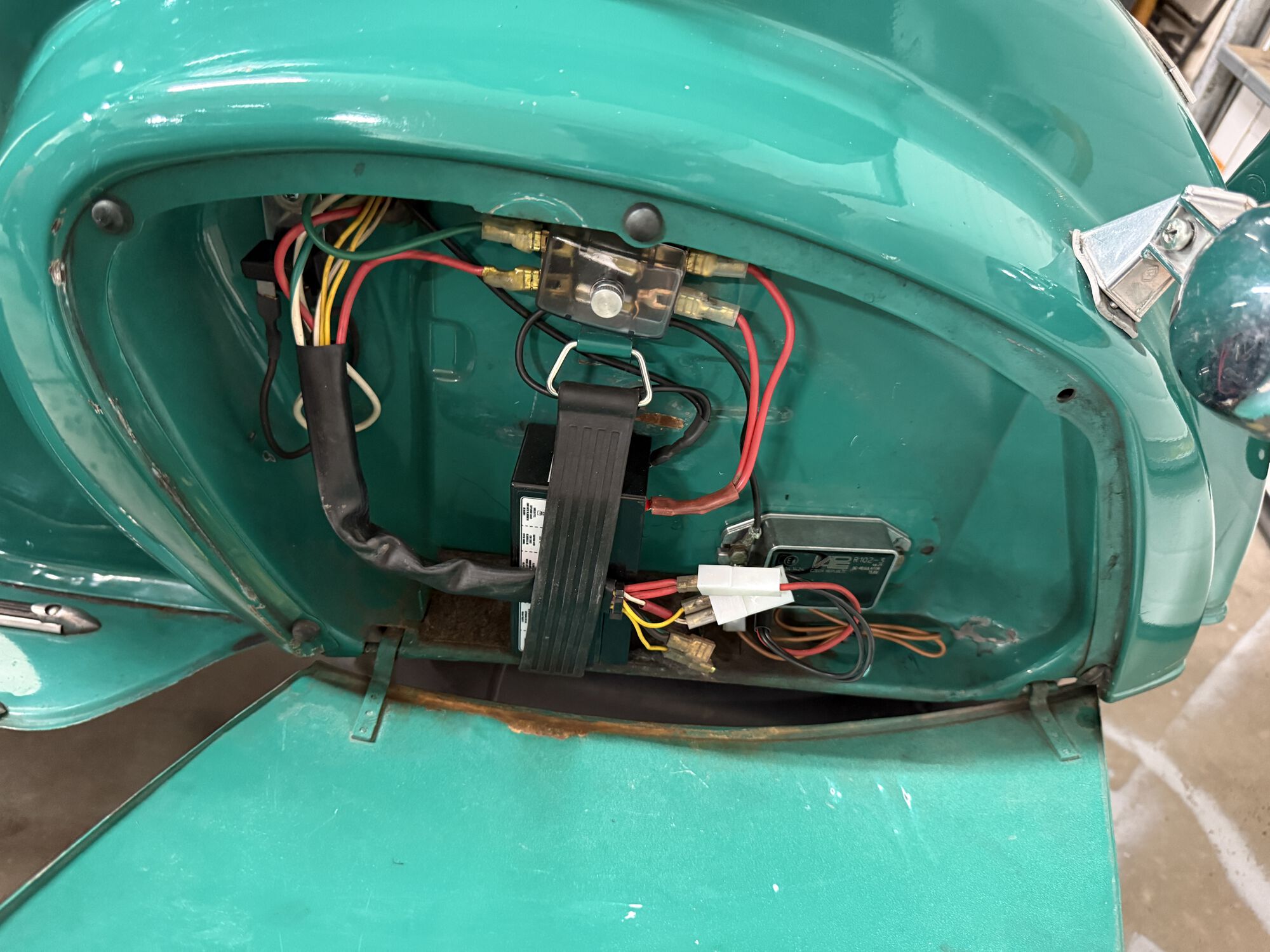

It's very difficult to take pics of the frame mods, when there are none. I can show the battery compartment if that means anything.

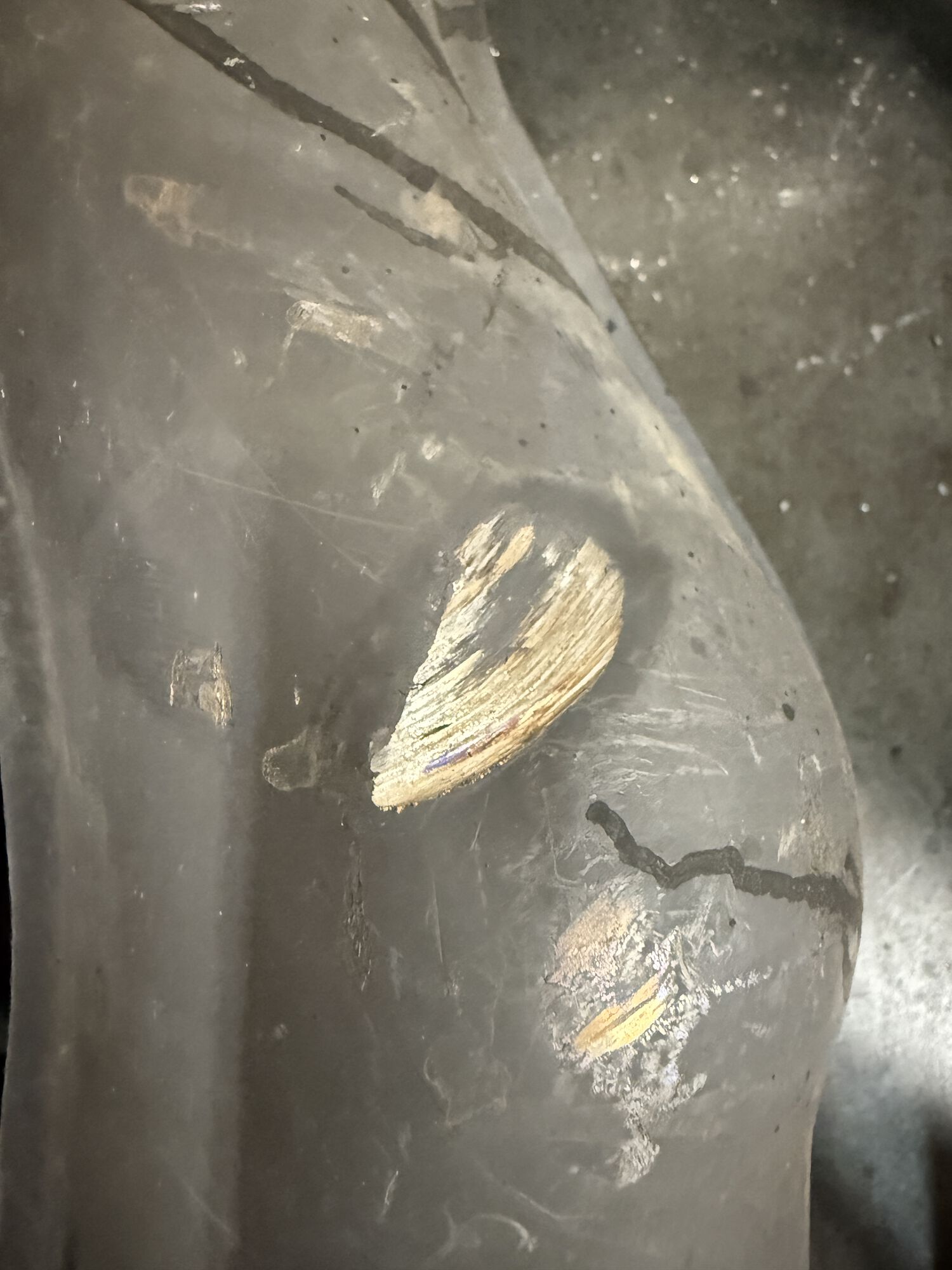

No hacking at all. It was a better fit than the Polini pipe, which rubbed. It took me about an hour to install.
Polini rubbing witness marks.

That was your thread I was referring to. My brackets are very strong, but if they do break (doubtful), I have a welder. Maybe they have improved the design since you bought yours years ago.
All I can say is it was the easiest exhaust install I've ever encountered.
