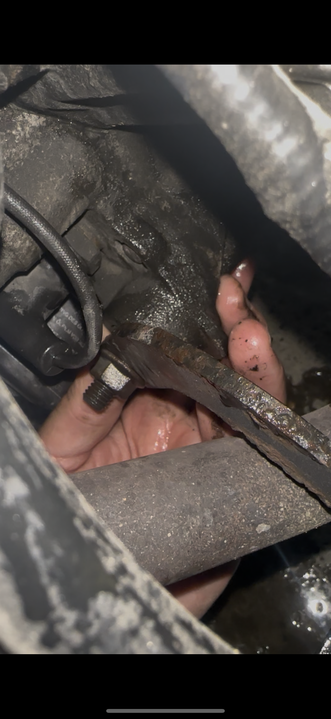

Hi all,
I have a 2008 Piaggio BV250ie with the Quasar engine. It's suddenly started leaking coolant — a lot — especially when I start the engine. The leak seems to come from underneath, around the middle of the engine, near the oil filter area.
When the engine is off, barely any drips out. But when I start it, it flushes coolant fast.
I suspect it's the water pump. I'm looking at the RMS repair kit. Before I tear into it, I'll post a short video of the leak to confirm.
Anyone seen something similar or done this job before? Do I need anything beyond the pump kit?
And one more question: Do I need to rebuild the whole water pump, or is it possible to just replace one part (like the seal or bearing) if that's the only issue?
Appreciate any advice.

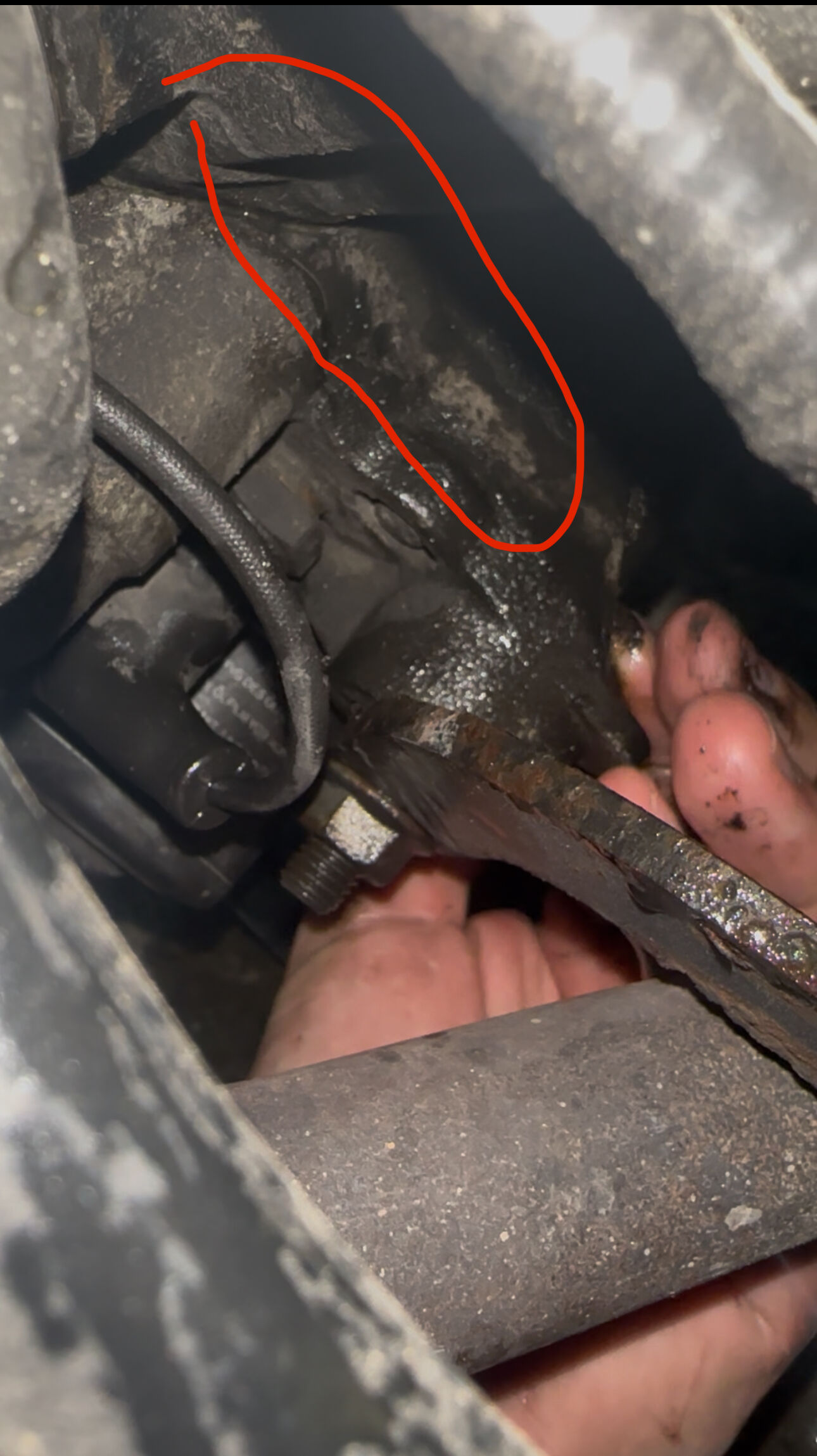

I rechecked again and filled fluid but it leaks after filling nonstop untill there is almost no coolant. Even that engine is off it drops coolant nonstop.
Idk if it helps but i got a new video so screenshoted this: in red circle seems that leak is comming from there somewhere. Can it be something else rather than water pump

Have you removed the seat bucket access panel and looked from above?

Yes I checked from there but I cant find any visible leak near thermostat or somewhere else visible. Only thing i see is this water source in image. Looks like water is comming from there. I dont know for sure where is the weep hole but I don't think that coolant is comming from the hole.

The leaking hole of the pump is under the stator cover. If there is no leaking from the hoses connections , freeze plug or the thermostat cover and the water is coming from the base gasket of the cylinder then the head gasket is leaking and water passing through the orings at the cylinder studs. What is the condition of the oil? Is there water in the oil?

Have you checked all the(18 year old) hoses?
I would use some engine degreaser on it. Then use some coolant dye to see where it's leaking from.

You should start removing body panels down to and including the seat bucket. You're going to end up doing it anyway. Get down to the frame, so you can find the source. I suspect, as others have said, you'll find a compromised clamp.

A failed coolant hose will spray coolant a significant distance from its source totally mis directing you. As others have said , in order I would
1) Remove as much plastic as possible
2) Gunk / engine clean the motor to within an inch of its life, so all surfaces are clean and oil free. Then let the engine DRY.
3) Add a dye , food dyes will be the easiest, to clean water and add to your coolant
4) Get some good lighting below and at the side of the scoot.
5) Start the engine, THEN immediately stop it and look for weeps / coloured fluid.
6) Wipe it down , and restart the engine for a few seconds more until the source is revealed.
Good luck with your quest
