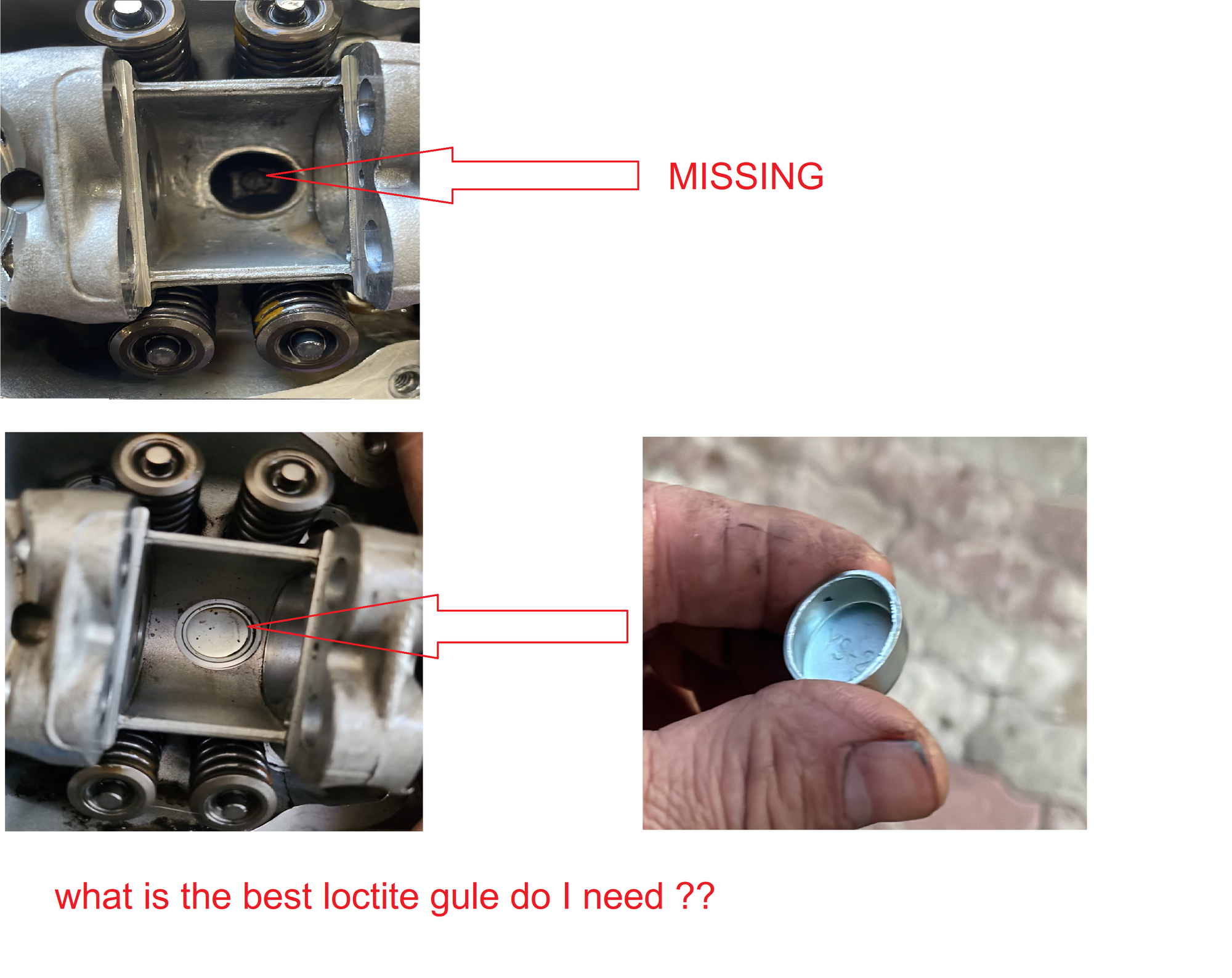

Hi,
I do have now cylinder head that the water bypath pin block has been failed, and I need to know what is the best Loctite glue number for this task?
Locteft 290
Locteft 262,
Locteft 222,
Locteft 620
Locteft 680,
Locteft 271,
Locteft 263,
Locteft 648,277,609,243, 638, 242, 272 ....
help

Isn't Lockteft the chinese copy of Loctite?
A freeze plug should have an interference fit, so no glue needed
^^^^ This! Whatever happened to the old one?

I would peronally not use Lochteft or other chinese loctite copies.
Loctite is very expensive, I know. But do your research on internet on the copies and you will gladly pay the price for loctite.

Again, no locktite or glue/adhesive of any kind.
Freeze plugs are strictly friction fit.

I am asking this because after around 15 Km the freeze plug has been fail again,
so new, I need reopen the engine ☹
when I install the freeze plug I had the good feeling that the freeze solid feed in….
Strange and fracking

Did you install a new plug? Or reused the old plug?
You need a new plug

I installed a new one,
the original freeze plug has been crushed so hard that I needed time to understand that behind the rocker there is missing freeze plug
so I started from water pump, than head gasket and finaly I understand that it is missing hidden freeze
