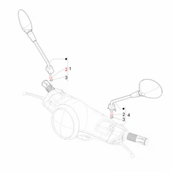

Are you missing the dome washers?

That is a good possibility. Tell me more about them. I don't see any reference to them. I am guessing that I have to buy new mirrors to get them.

I have primavera mirrors on my GTS HPE. They came with one flat and one dome on each side. Without them the mirrors would always come lose.
I don't know if the GTS pre-HPE had these but if not go to the hardware store and buy some generic ones.

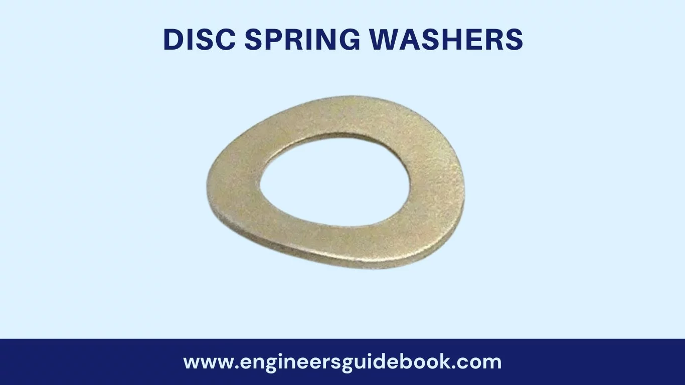

I put spring washers from the hardware store on my bv350.

By spring washers, are we talking about Bellville, split washers or something else ?
Belleville washers are usually called conical washers. Split washers are as the name indicates. Spring washers are typically made like this -
