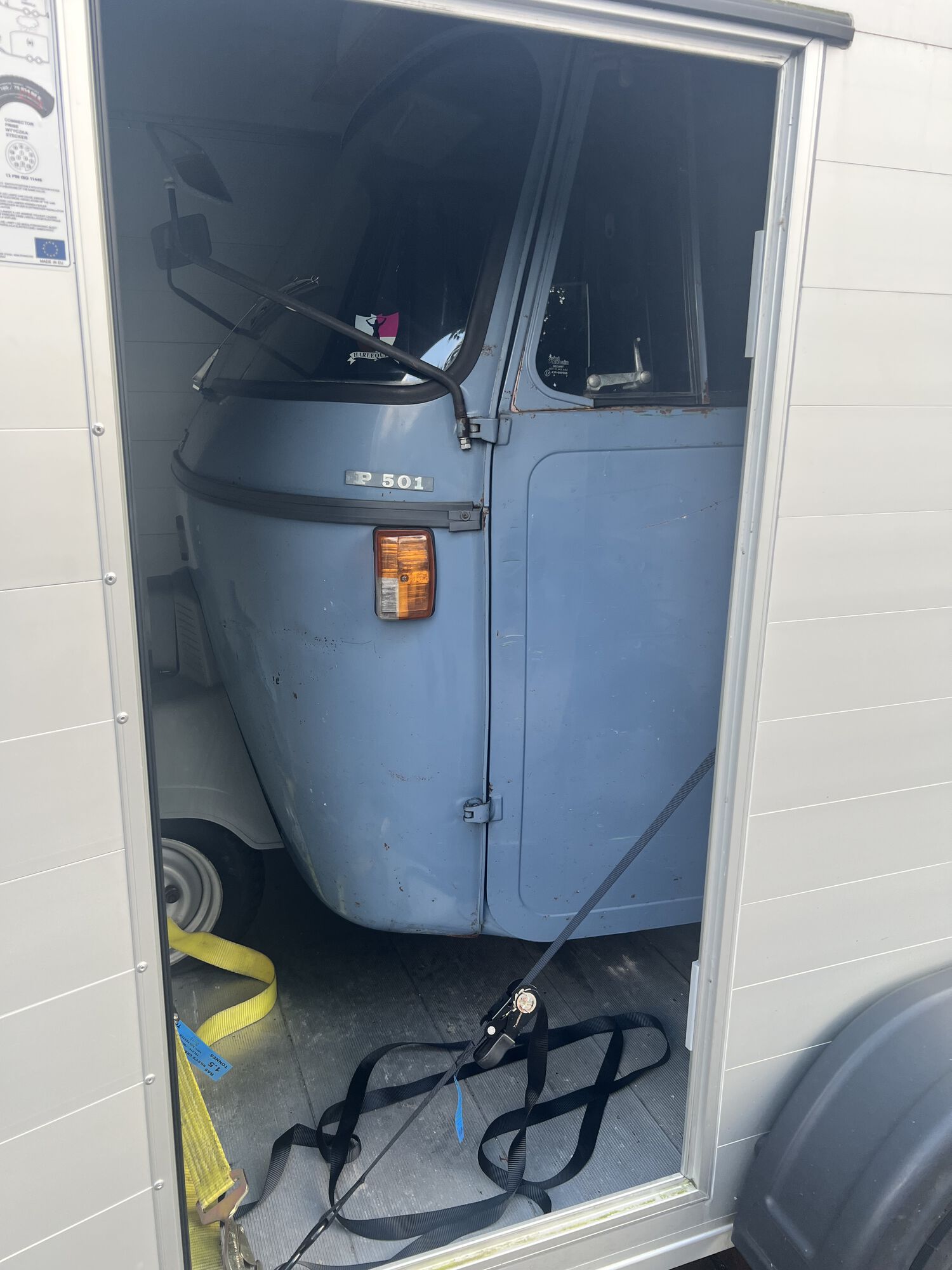

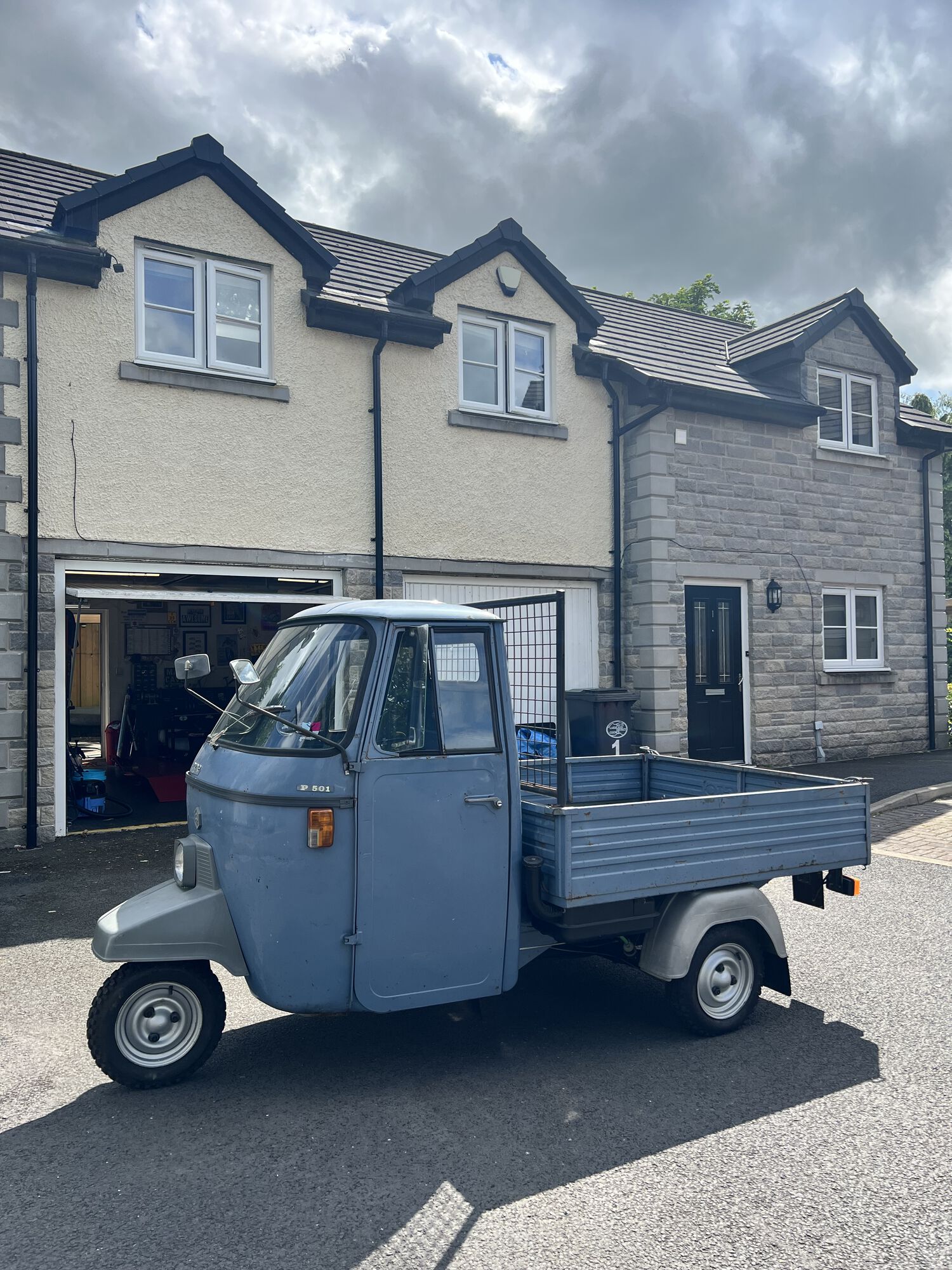

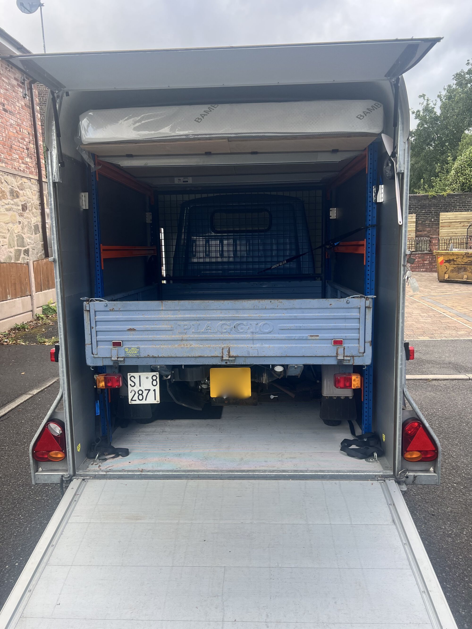

A couple of pics picking it up the other day.. to say it was a tight fit in the trailer ๐Ÿ˜ณ
