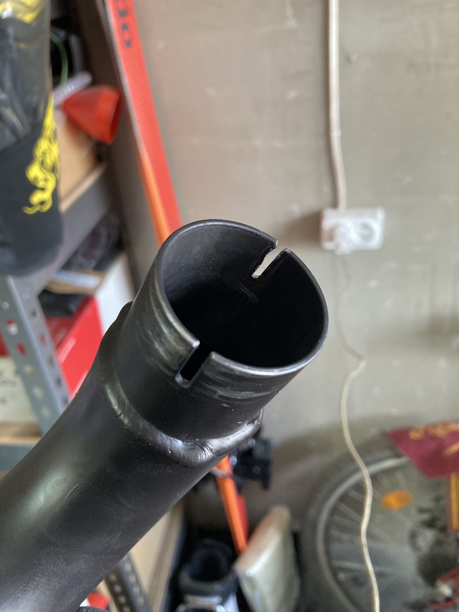

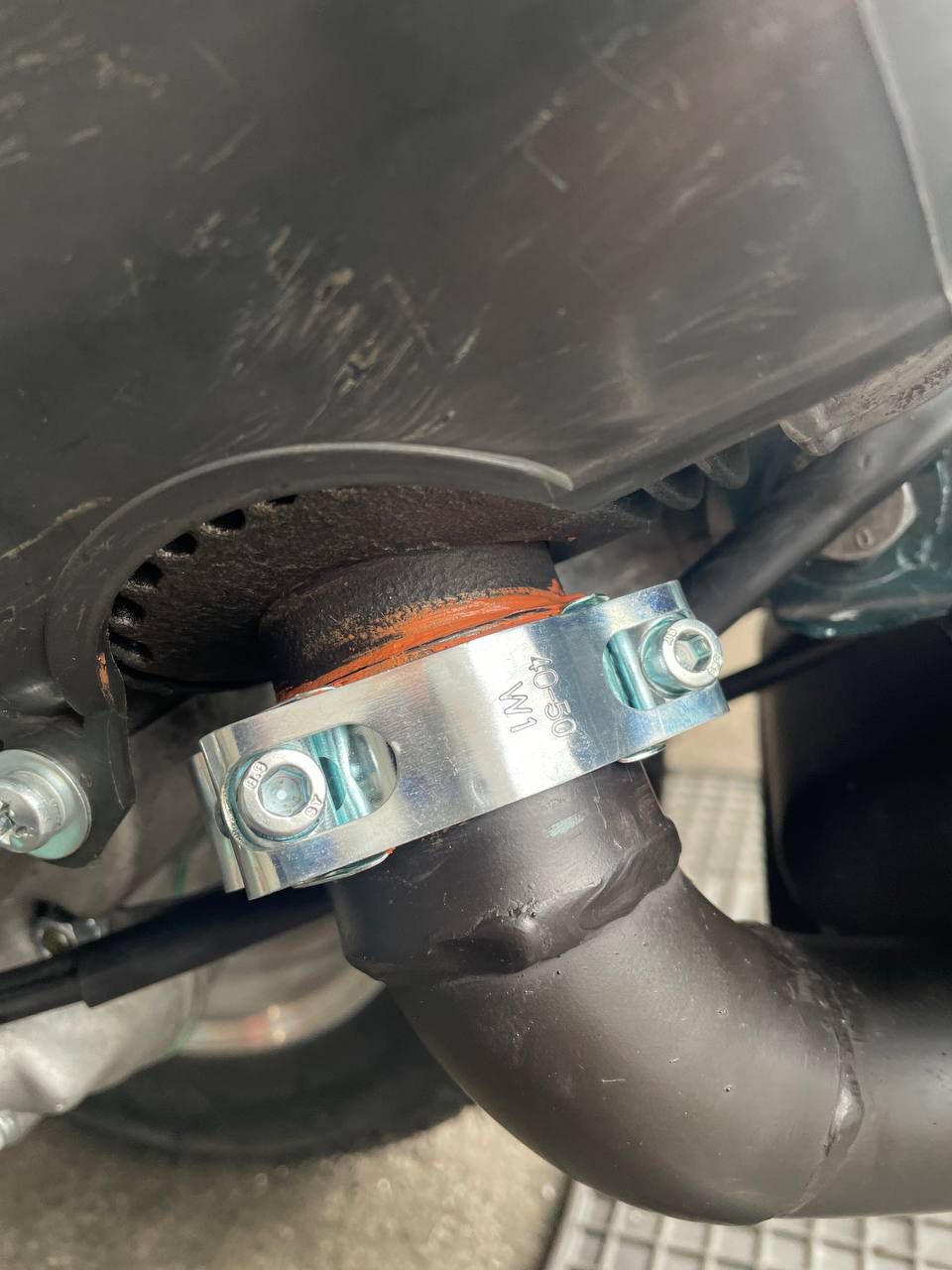

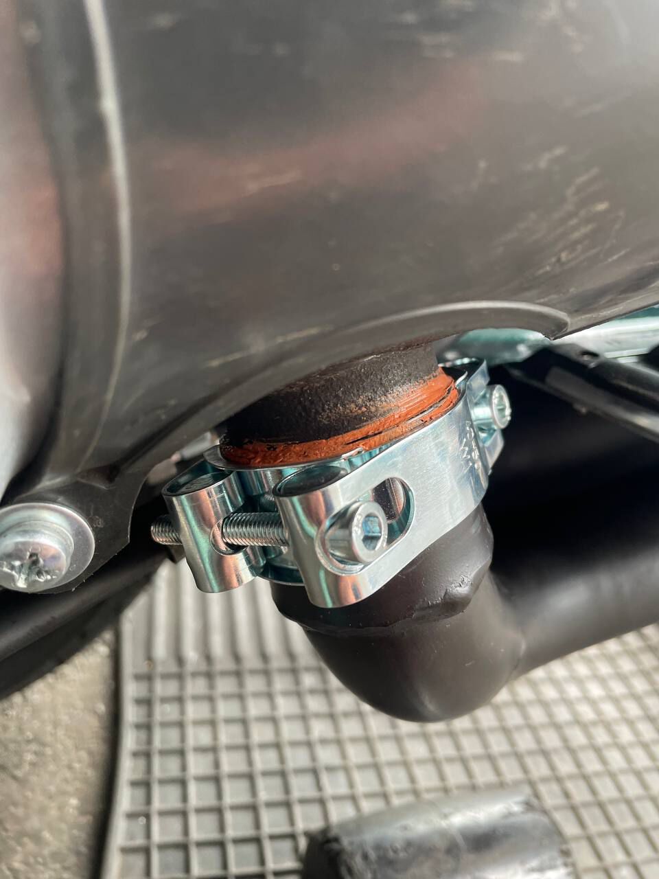

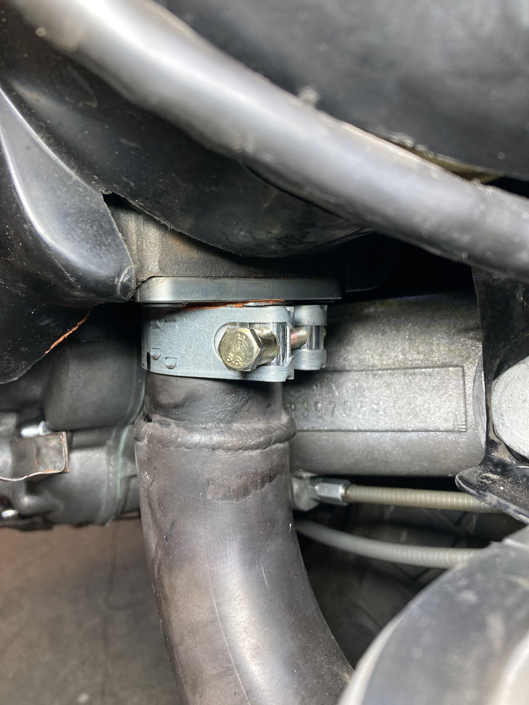

I added extra cut opposite the existing one and used jubilee super clamp. And copper silicone sealant ofc.
Extra cut.
Extra cut.
On my P150X.
On my P150X.
On PX200.
On PX200.
On PX200.
On PX200.
