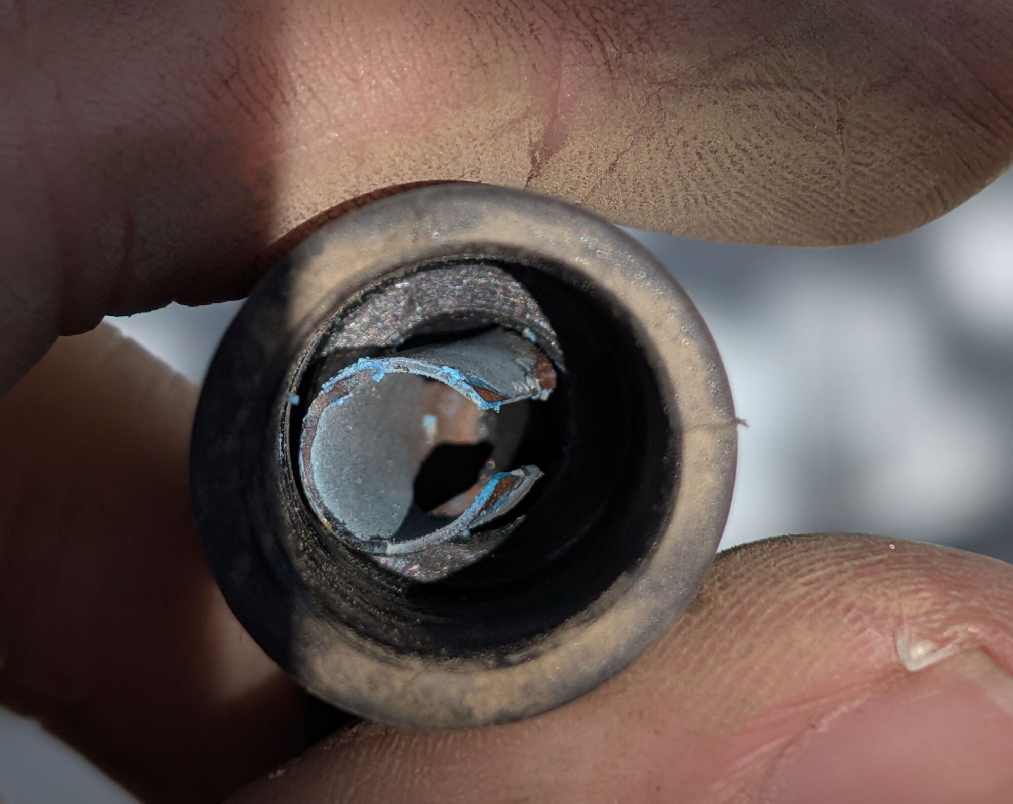

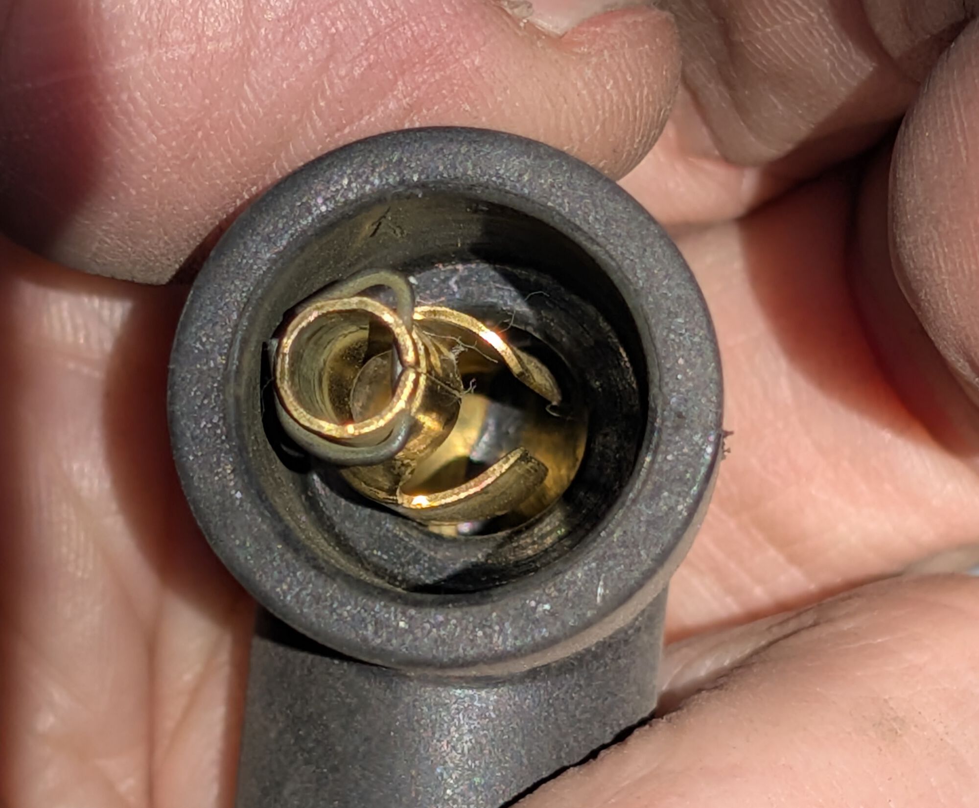

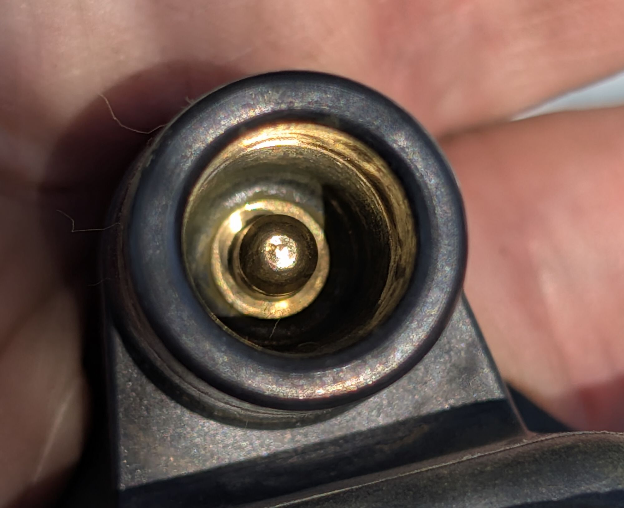

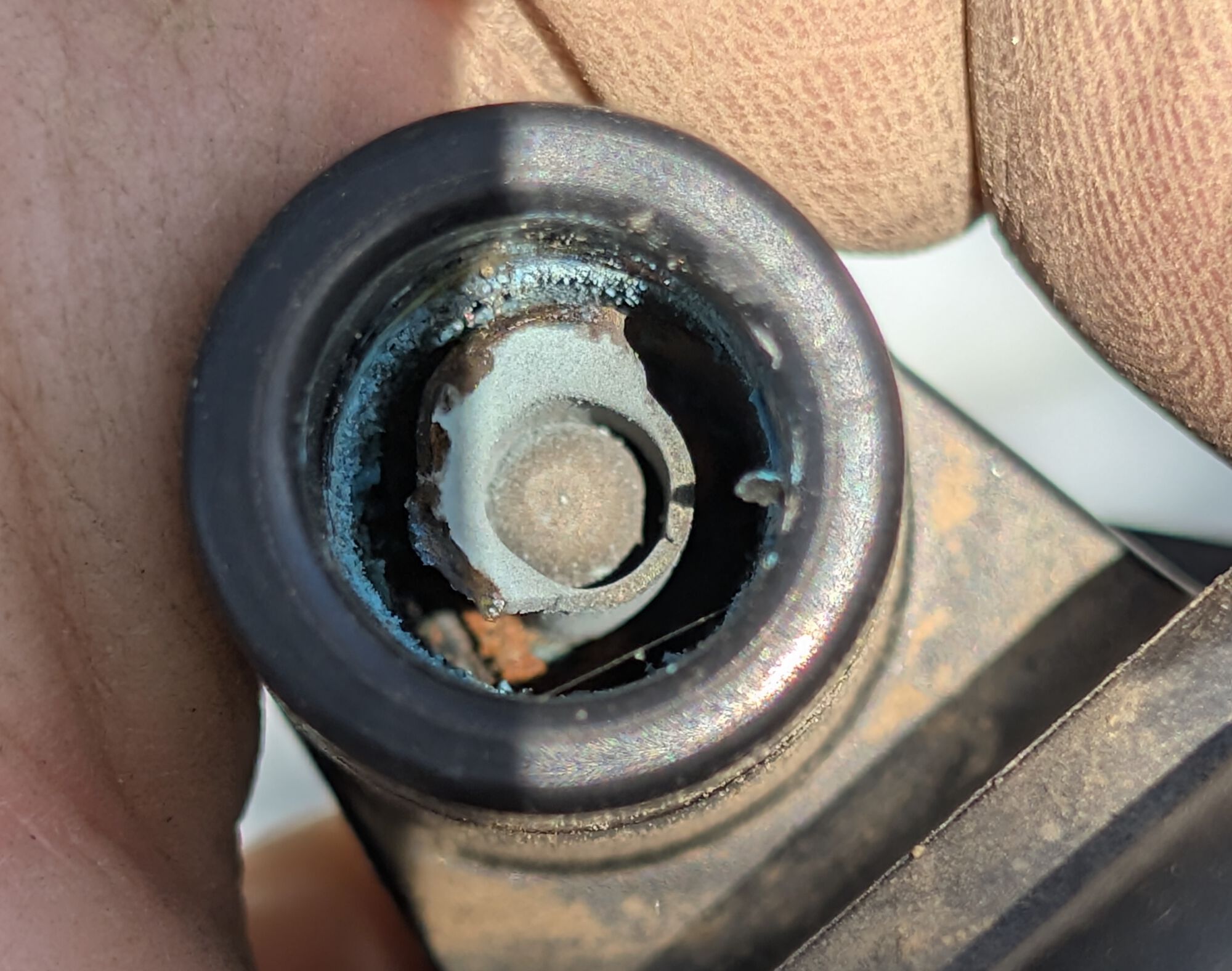

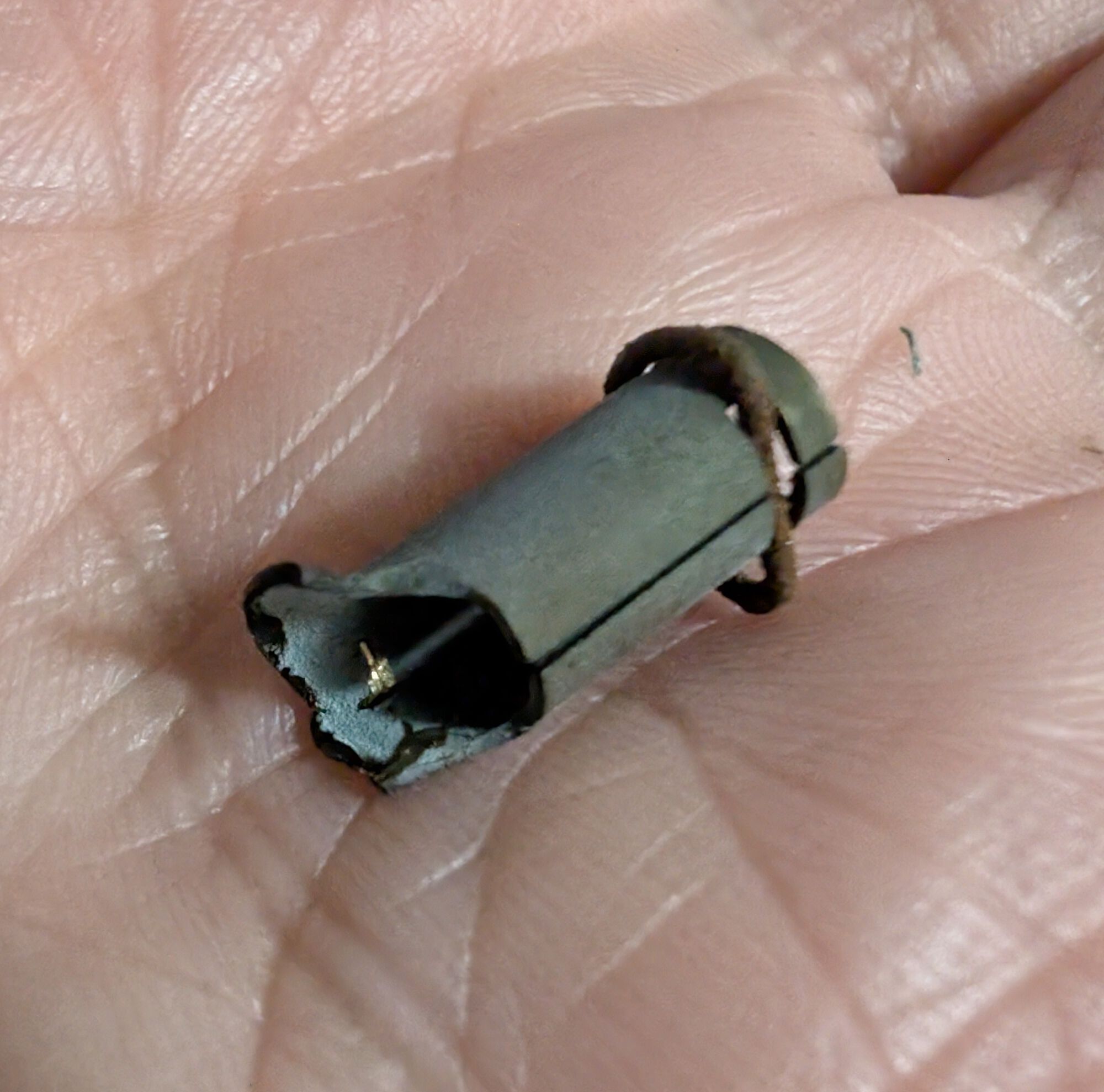

Symptoms:
Over this first month of winter it's started to misfire while the engine is cold. Basically the first 3-5mins. Once warm it was 100% fine.
Once it cranked for 10secs without firing at all (at normal crank speed as shown in my recordings).
And would also misfire going over speed humps while engine still cold.
After a couple of weeks of this intermittently (hard to diag), it threw P0230 fuel pump load relay and P0480 cooling fan relay.
I replaced both the coil and lead as I had them sitting on my shelf.
UPDATE: didn't fix my problems. continued in Failing fuel pump symptoms?
