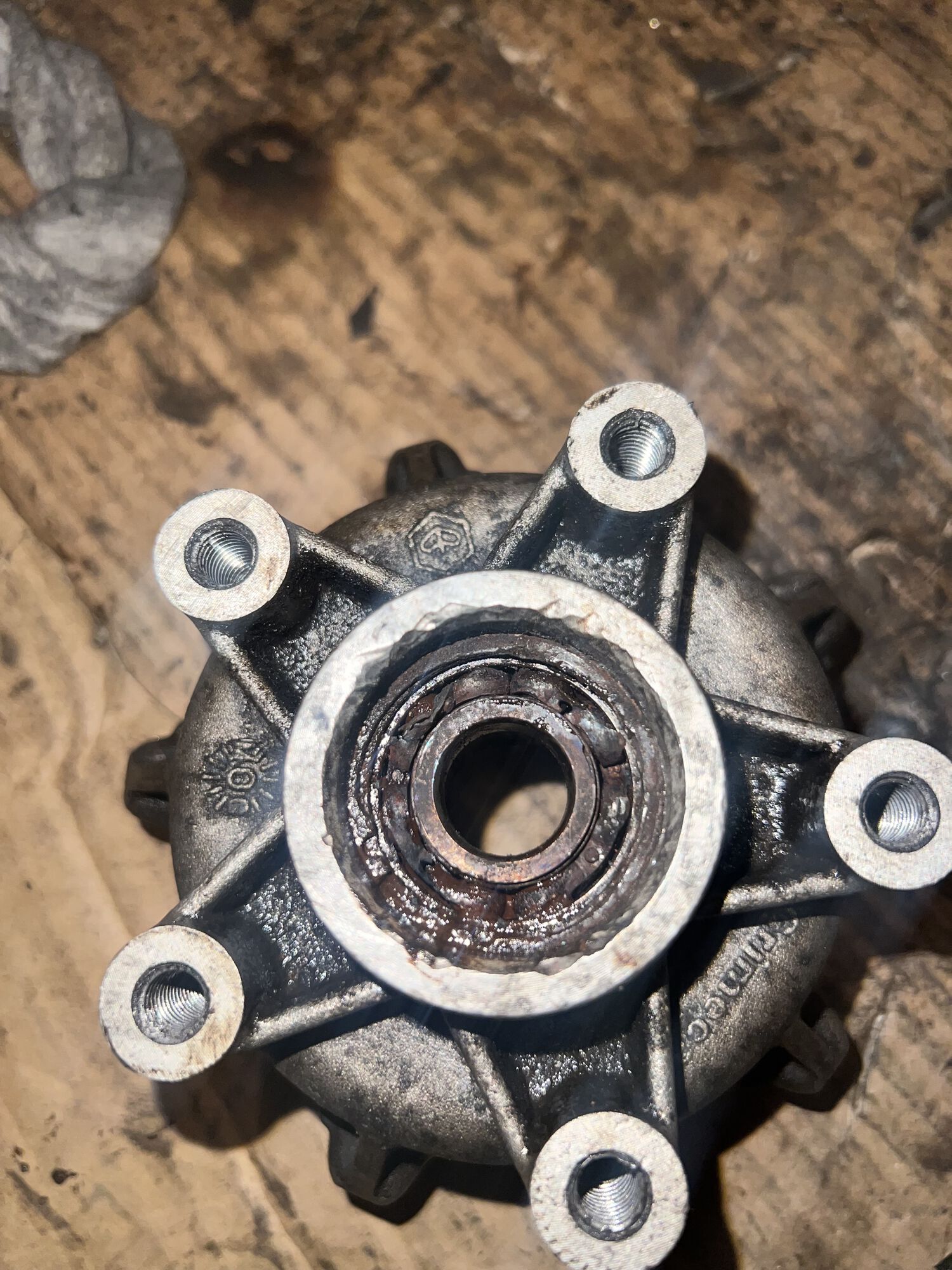

Hi! How do you remove this circlip before bearing, tried everything - heat, hammer still nothing. UPD: wwnt to service they managed to take out it with some huge pliers

The hammer is visible, hmm, dipped in penetrating oil and laboriously tried to move the ring.

You have actually tried with circlip pliers?

Try driving the bearing into the hub just slightly. It will release any pressure the bearing is placing on the circlip. Then, as jimc suggested, use circlip pliers.

I'm thinking at this point new/used hub.

. As other poster has said, try to drive the brg in a few thousands ( if possible), then try to get clip out. However you may have already consumed any minute space hammering on the face of the hub. Good luck.

I'm still scratching my chin wondering how a hammer could possibly have helped remove a circlip.
