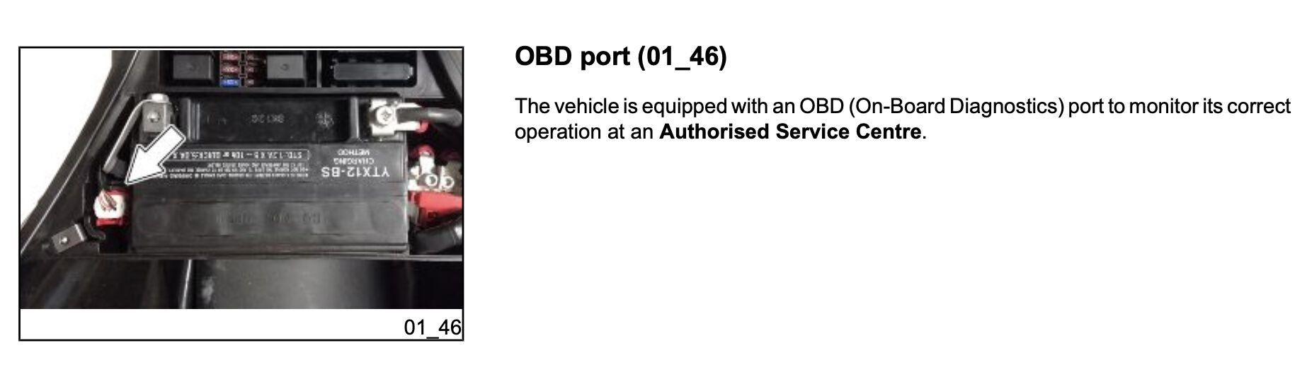

Guys, could anyone tell me where to find the diagnostic port on my 2014 MP3 LT 300, I need to find out what the amber lamp on my dash is trying to tell me, don't know a great deal about these beasts, so I'm hoping one of you lovely people can help me out!?

I'm not 100% sure but in most is very close to the battery. In the download section maybe is the user/workshop manual for your specific model.
I add a picture from manual where shows the location.
Diag Port MP3 300 hpe

That's awesome, thank you for taking the time to reply, much appreciated 👍.
