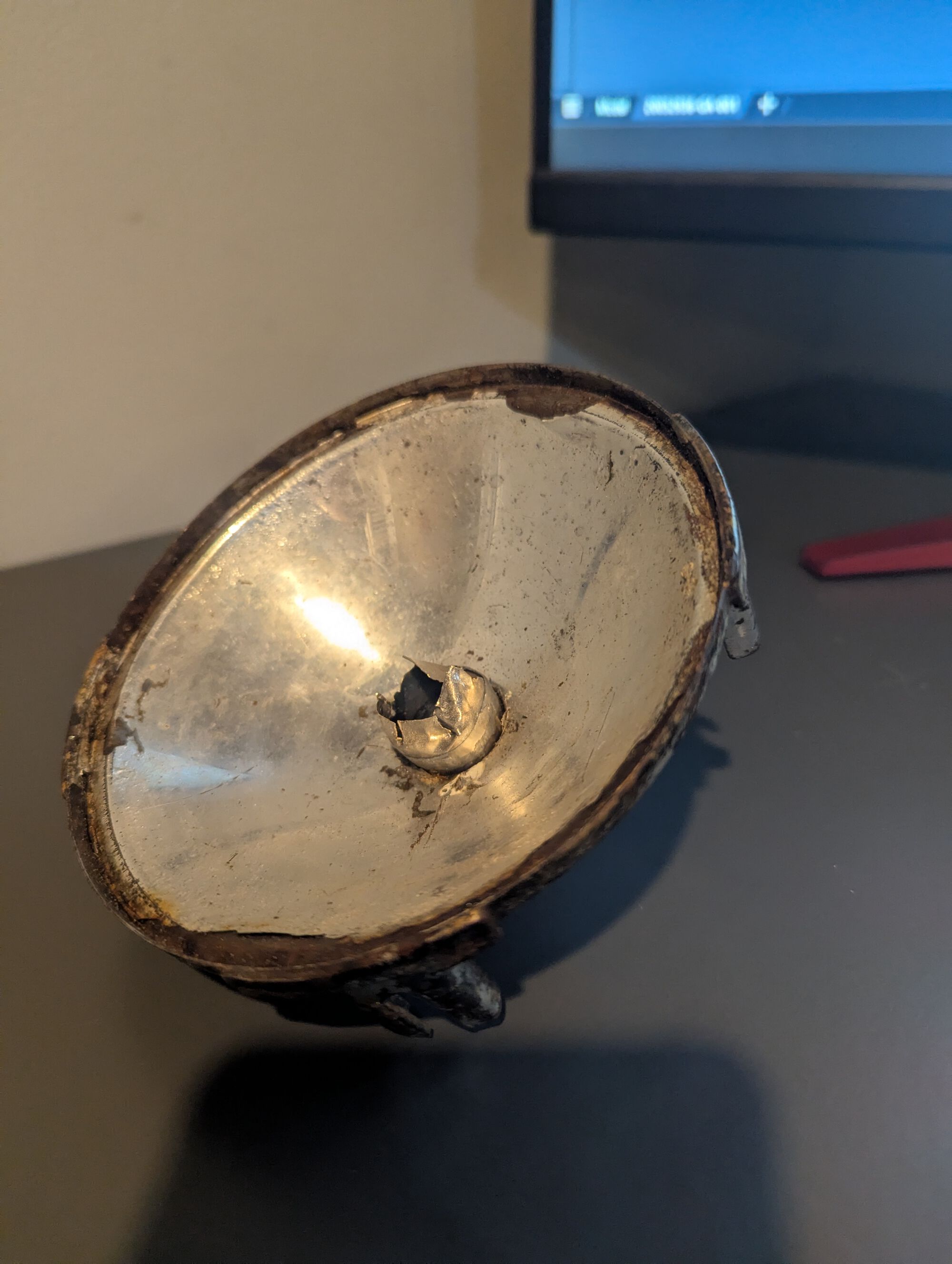

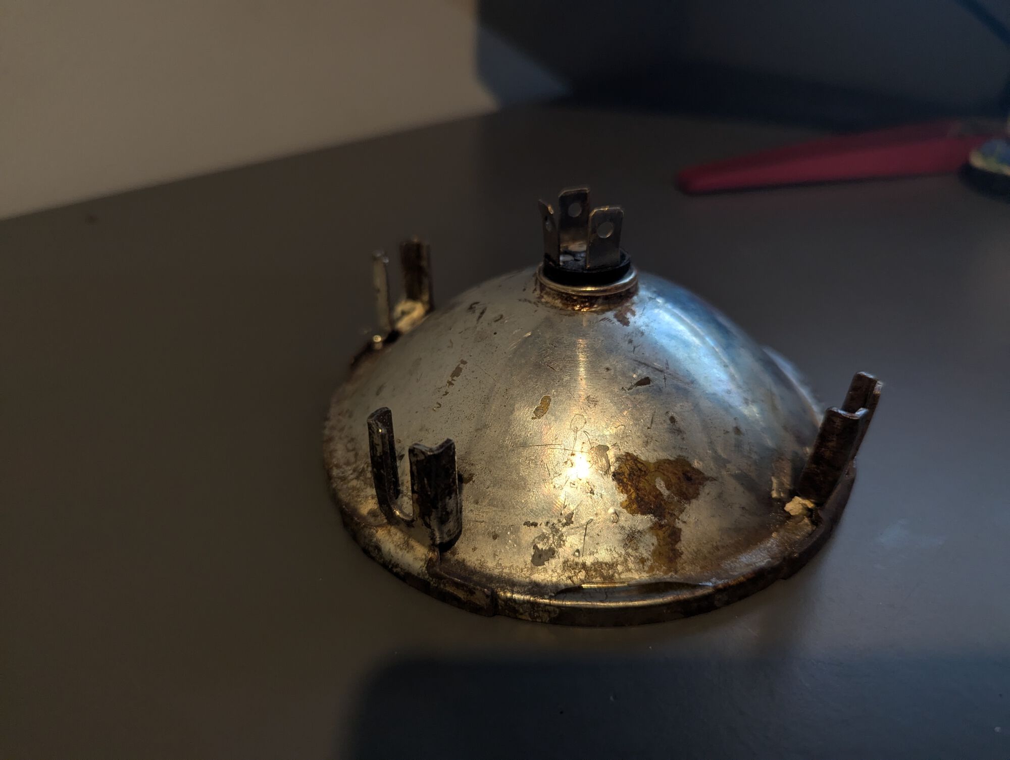

This is what I found in the box. I can't find one like it at all the parts suppliers I know of. Anyone know where I can get a replacement?

That's an old sealed beam headlight with the lens broken off, which I don't think is correct to the bike.
Someone else (SoCalGuy) can say for sure. I have a Bluebadge smallframe which uses a lens with two tabs on top that slot into the headset:
https://www.scootermercato.com/Scooter-Parts/Headlight-Assemblies/144773
Yours looks like it might be the same as a mid-70's sprintV which *did* use the sealed beam lamp like that, with special mounting screws that would match the hole I think you have at 9 o'clock in your picture.

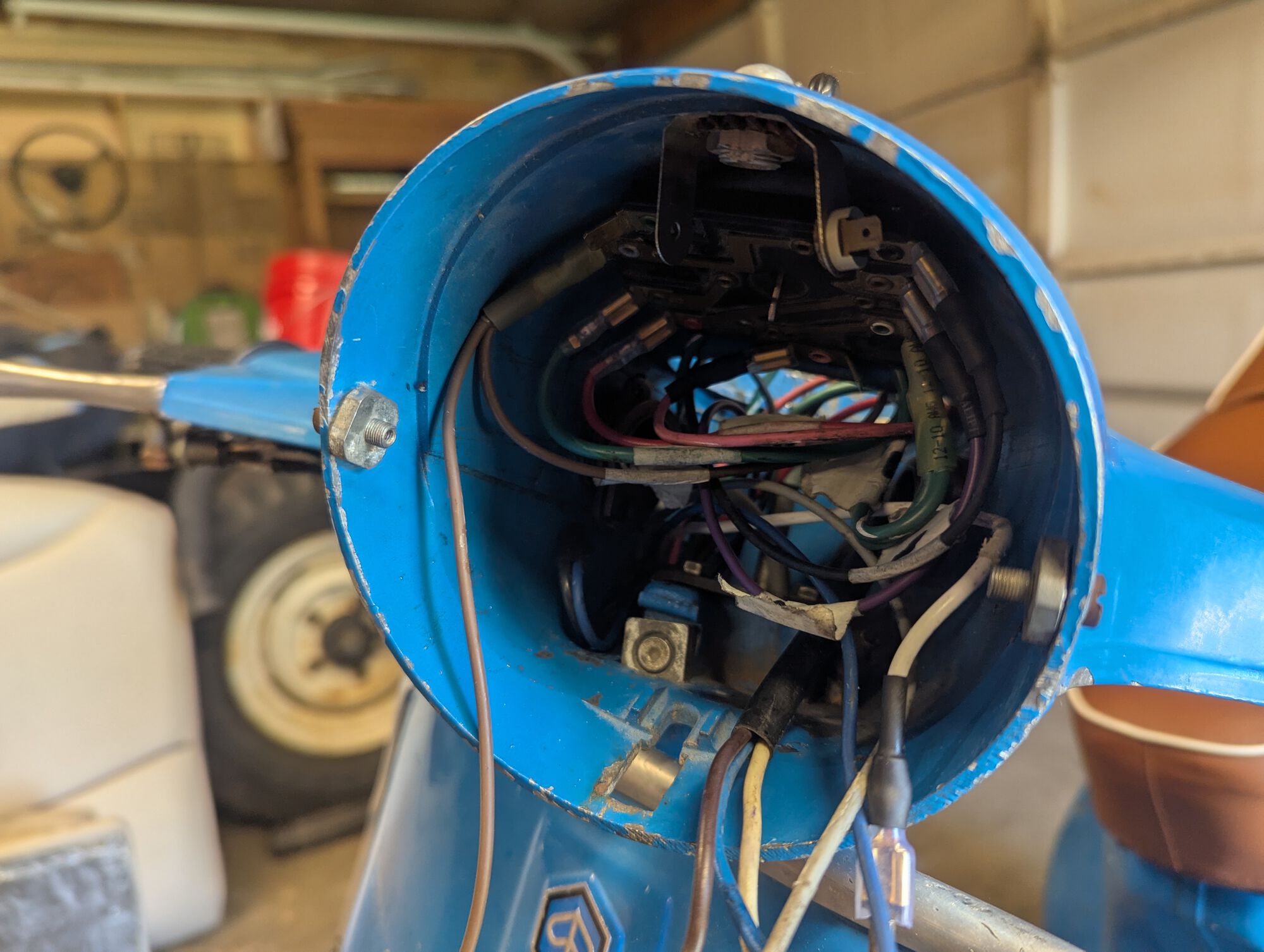

Can you post a close-up of the headlight area of the headset so we can say for sure?

Don't mind the wiring, it's a work in process. 😂

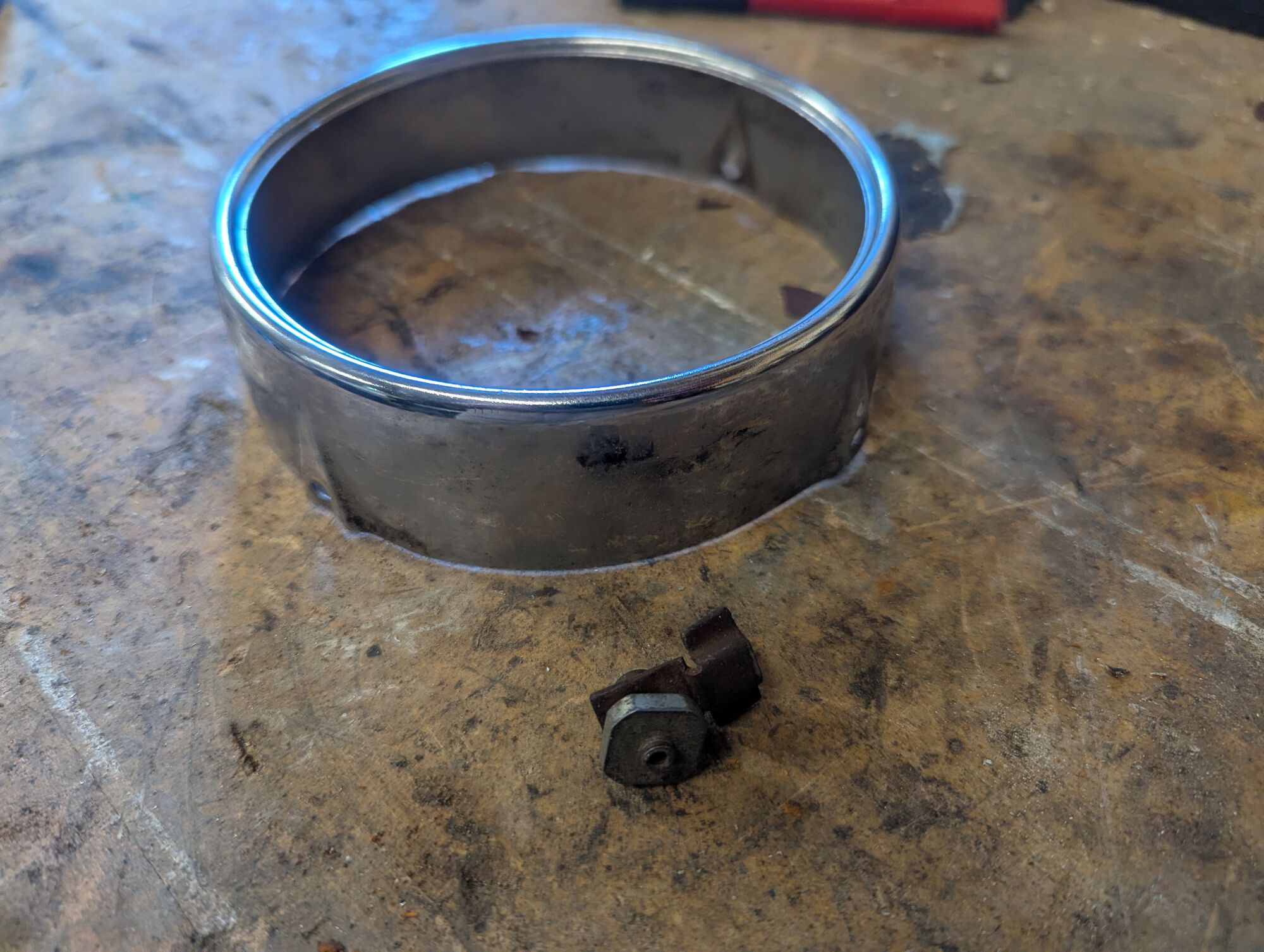

I also have this chrome rim stamped with CEV 1C973.

It took a little doing, but I think this is the bulb you need (you'll want to measure and make sure):
https://www.scooter-center.com/en/headlight-universal-clear-lens-120mm-12v-3535w-hs1-vespa-pv125-vma1t-vma2t-et3-vmb1t-super-vnc1t-vbc1t-ss50-v5ss1t-ss90-v9ss1t/p-12555.html
(I'm assuming you converted the electrical to 12 volt)
Edit: I just realized you have the two square holding nuts and screws. I'll leave this here for anyone else who finds this while searching for this same question.
You'll also need two of these dudes to hold it in place:
https://www.scooterwest.com/screw-and-nut-set-for-usa-style-vespa-headlight-015543.html
That crusty nut you have in the picture goes on the bottom to adjust headlight aim (and drive you crazy in the process of fitting it)
Then a couple of (I think) M3.5 screws to hold the chrome bezel over that.

The sealed beam headlights on the US models are hard to find an expensive. You can convert to a replaceable bulb system. Keep CEV bezel, that's a nice piece, much nicer than the reproductions. Bar Italia has what you need.
http://www.baritaliaclassics.com/catalog/product_info.php?cPath=25_2_193_35&products_id=47
Nice scoot. And take care of that battery door!
