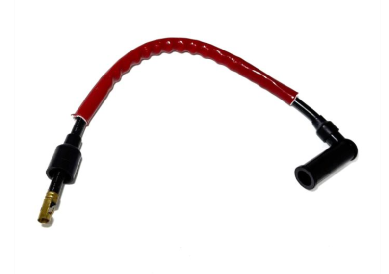

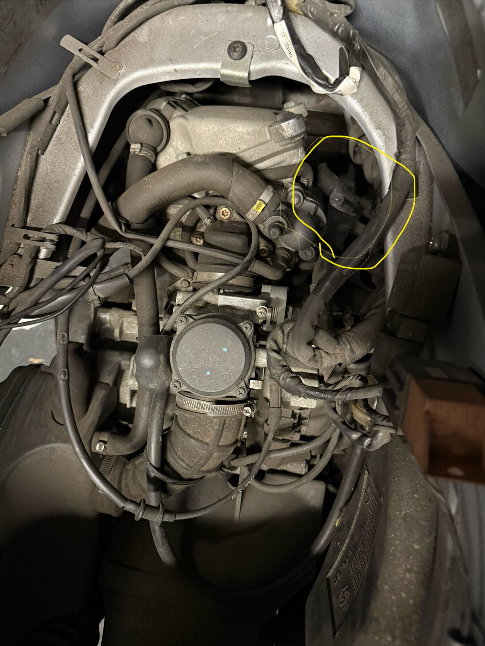

So after some further investigation into engine bay I think I found the culprit. The HT lead looks like it's snapped right off. Not sure on where the rest of it is and how to replace. Help gratefully accepted!

One end screws into the spark plug cap, the other connects to the coil.

Thanks, I could really do with the hands to know where the end of the Cable is connected to, is this something that someone can help with?
Posts: 45968
Posts: 45968
The spark plug is just below where you're marked. The coil is in front of the engine, access through the removable panel under the front of the seat.

Issues with the spark plug cap are way to common, I'm at about half a dozen by now across 2 scoots. First thing I check now.
You don't need the whole lead, just the cap. Cap screws on to the end of the cable.

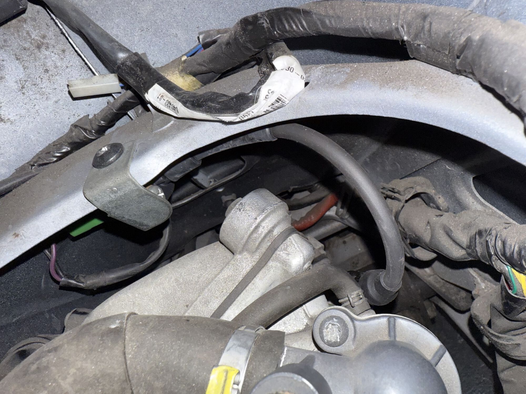

Thanks all, but I am still on the wiser as to where the cable goes because it has snapped. Maybe the photo is not great but all I have is the part that comes out of the spark plug and a bounce 4 inches of cable. If I understand correctly, I need to order the whole Cable and cap? Is there any photos of where the other end goes, please?

caffe67 wrote:
Thanks all, but I am still no the wiser as to where the cable goes because it has snapped.
Took a better look at your pic. Looks like the cable just came out of the cap, not snapped. Have you removed the cap from the plug yet? May not even need a new cap.
With the cap off will see what looks like a screw on the end where the wire goes. Should be able to simply screw it back on the wire. After about 6 turns should feel it bottom out, stop at this point because you're only screwing it into rubber.

Thanks, the end of the lead you see. Unless I am completely mistaken is not the bit that fits into the cap is the other side of it. Hence why I think it in someway snapped. I won't be able to doublecheck now until Monday where I can take a few more photos maybe.

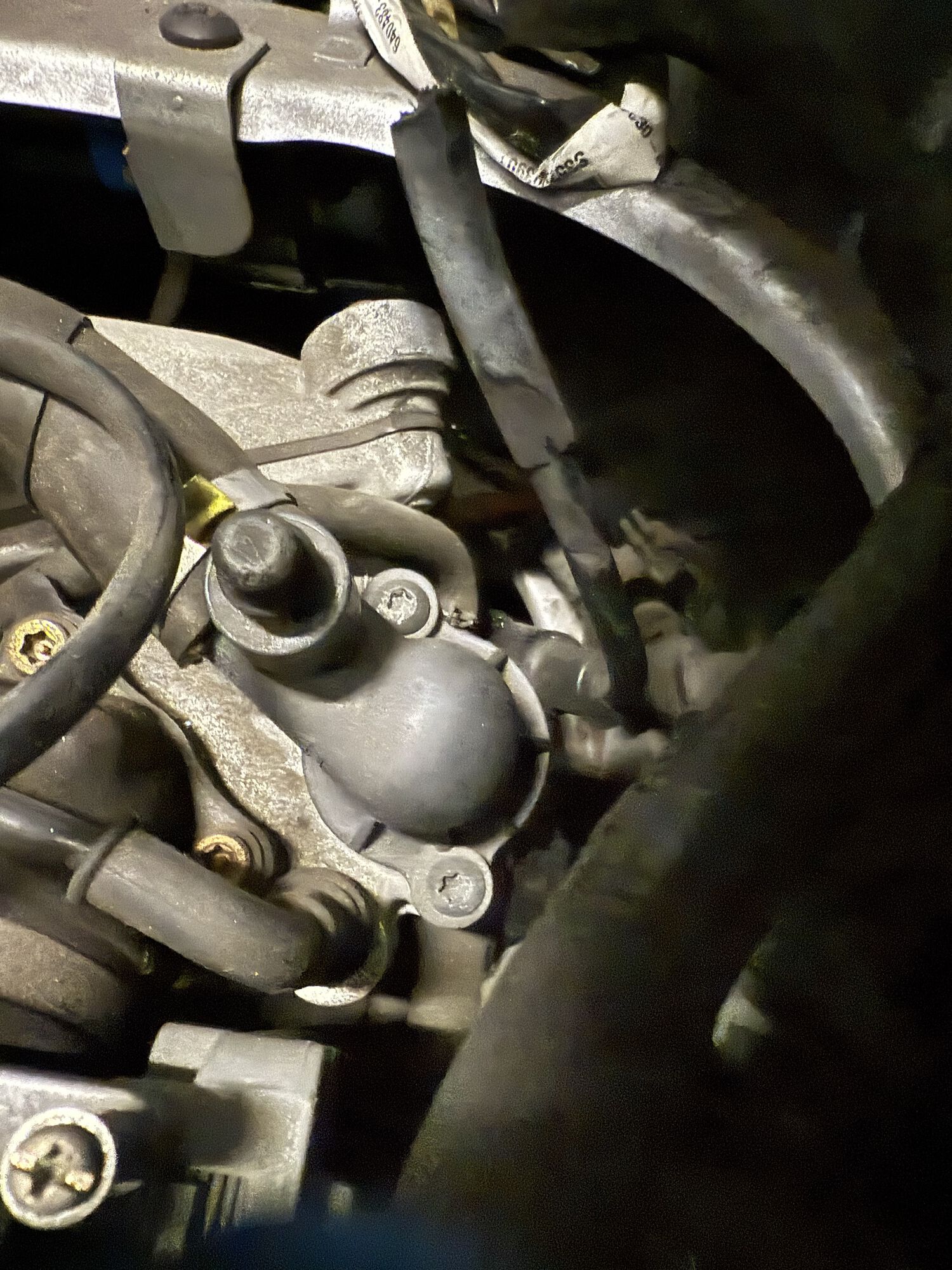

Couldn't find anything behind the battery , so confused now .. tow truck is £100 which would have been good to avoid. Nothing visible behind battery , I took the whole thing out and plastic housing. Is it possible that it snapped off?

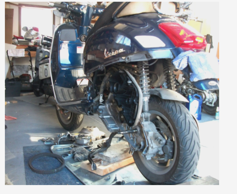

Hold on here before you take half of the scooter apart. Are you replacing the coil, or just the cable from the coil to the plug? It's been a few years, but I replaced the cable on a GTS300 by removing nothing. Raise the scooter with the centerstand sitting on some scrap lumber. Climb under it with a flashlight and look at the area between the battery and the front of the engine. What do you see?
Yeah, last time it happened to me, on my current scoot, GTS 300, I only had to take the exhaust off to get my hand on the coil.

Update ! The coil is housed under the side of this frame. Nothing needed to be dismantled or removed. I don't know if I would have been able to fix myself as looks awkward to get at. But glad it's working again!
