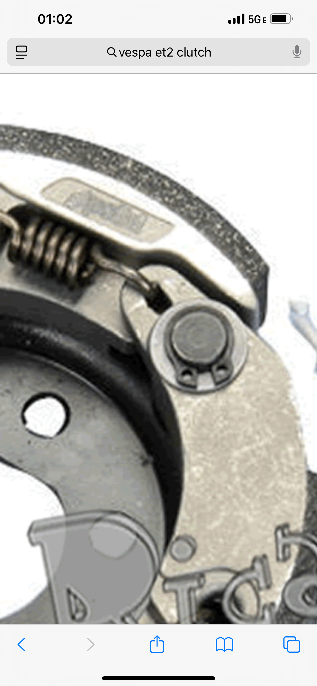

If compression still tests ok, I'd zero on the clutch then. I've seen the clutch pad pivot pin circlips fail. Totally random WTF experience!
