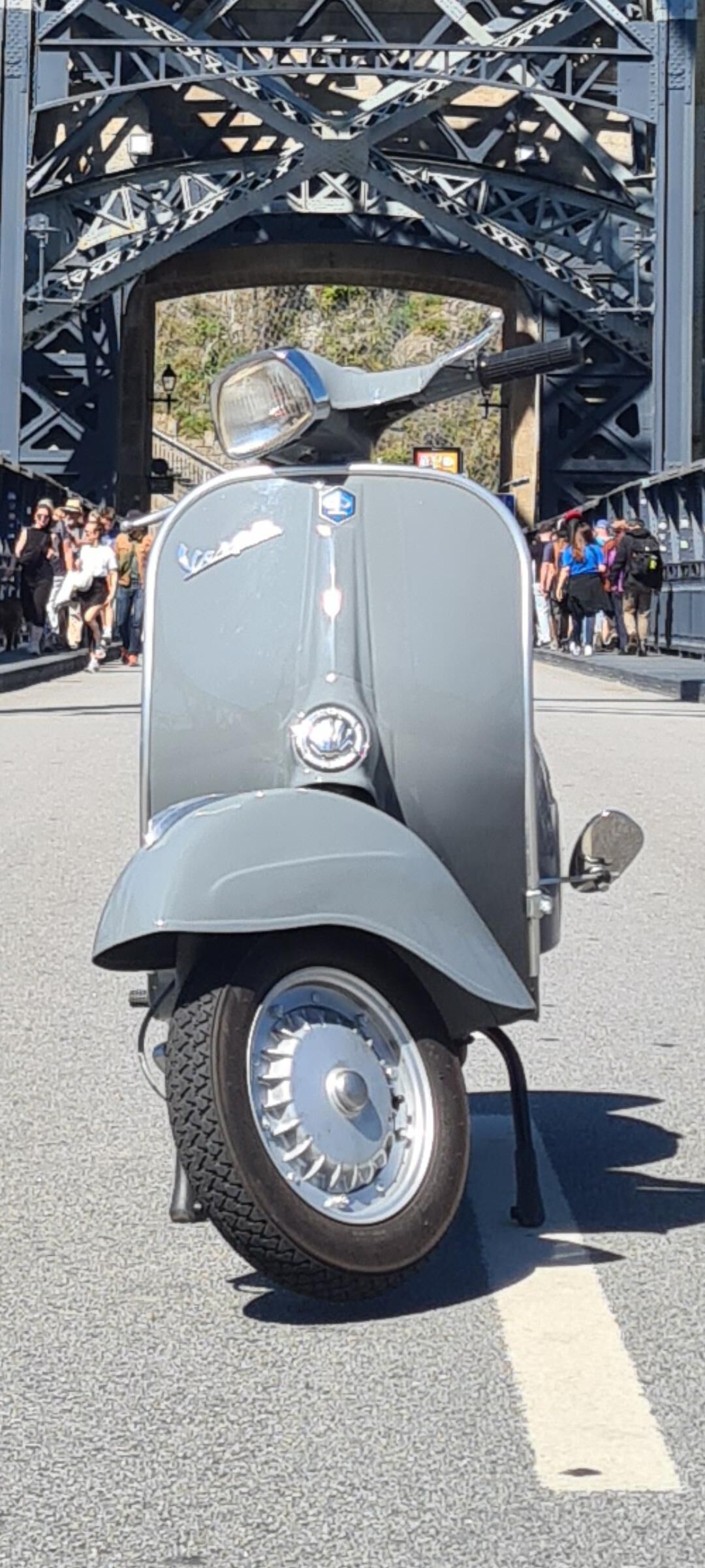

As a bonus, here's a pic of it!

That's a great looking bike! Post up some more pictures once it's running strong again.
