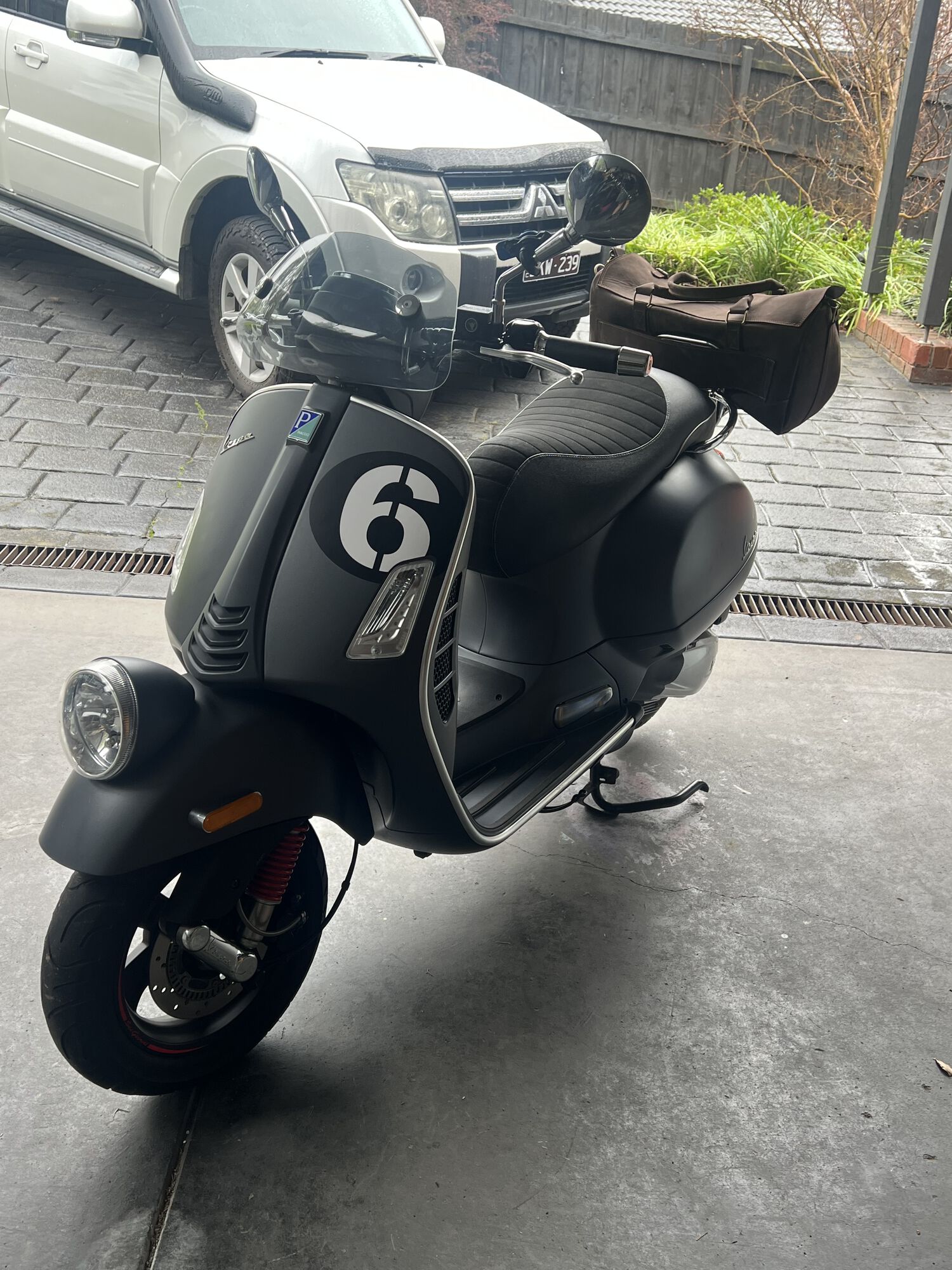

Hi all, maybe someone can help shed some light on this to help me. My low beam light has blown on my 2022 Sei Giorni, currently running around on Hi-Beam only. Want to change out globe to an LED option, have removed the 10mm nut at rear and can tile the light to remove but the headlight adjuster at the bottom is too long and cannot tilt the light enough to remove. Anyone come across this issue and how to fix so can remove.
What was supposed to be a 2 minute job has ended up with this post searing for answers/guidance.
Thanks all, pic for attention.
Andrew

Thanks finally got it I had to screw in the adjuster screw further to be able to leverage out.

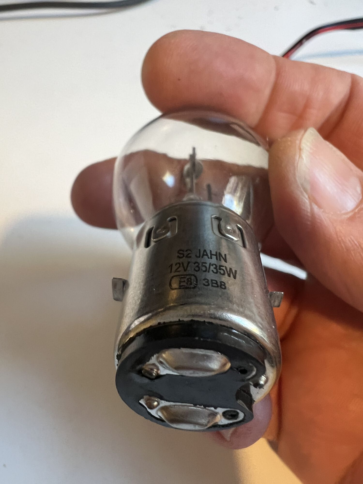

Can anyone in Australia recommend a suitable LED replacement globe? This is the factory globe, its 35W has two notches at top and two on bottom.

Did the same conversion on mine. Brilliant result
.LED from Ali EX
https://www.aliexpress.com/item/4000155383102.html?spm=a2g0o.order_list.order_list_main.161.1ab01802ZpWOor
