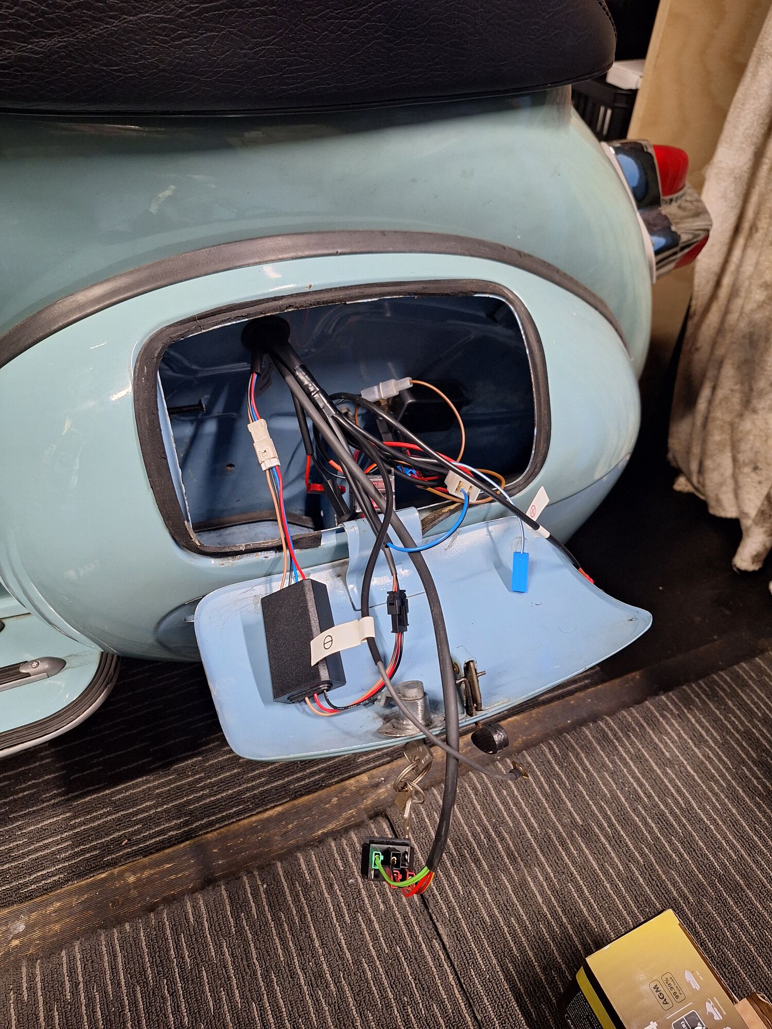

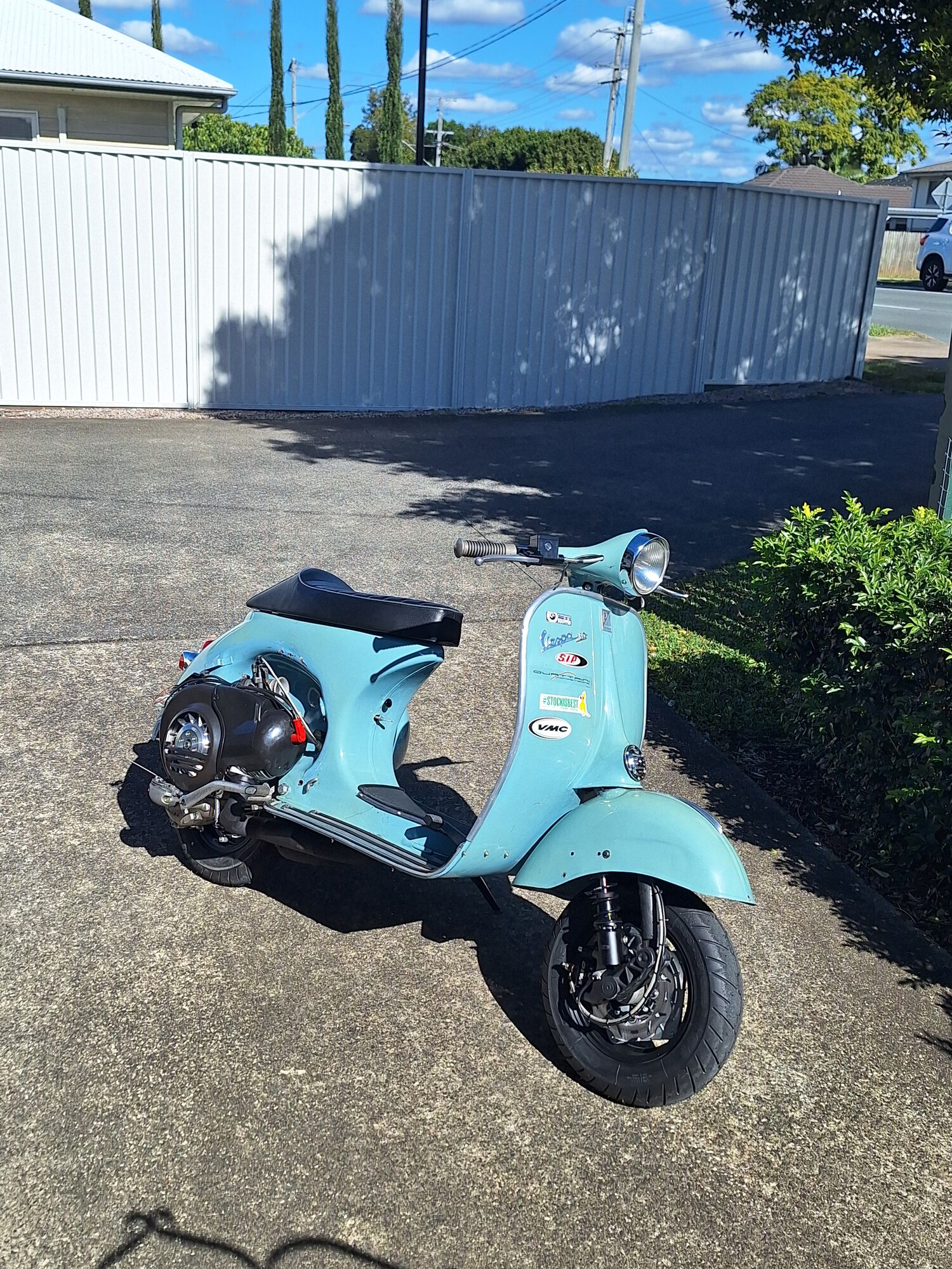

Hey MV. So just finishing up this VBBajaj, got a nice lump, VMC radial disc PX front end and fancy SIP loom with all the bells and whistles.
I've been sussing out what the best way is to mount the battery and all the switches and boxes and wiring and fuses, USB port, etc under the side panel. I guess I'm wanting the chance for you all to show how you've done it...
I guess it needs to be secure, compact, maybe an easy to remove panel with the switch, USB port mounted on top with the fuses on the side? C'mon, gotta see some picts!!
VBBajaj.
VBBajaj.
Let's see some ideas of how to turn this into something nice!!

It's not in the least bit tidy - so no pics - but as much of mine as possible is mounted under/beside/behind the tank as well. You don't say if it's electric start so I assume it's not... I have a small 2ah battery (mainly for the sip speedo) tucked up behind the tank. My sip black box is also there. I have a usb socket through into the glovebox.

It's not elec start. Yeah, maybe best idea is to put all the wiring etc in under the tank and switch/USB mounted to face inside the glove box. I bought a standard type battery for this scoot so it pretty big, I'll end up mounting that in the glovebox.
