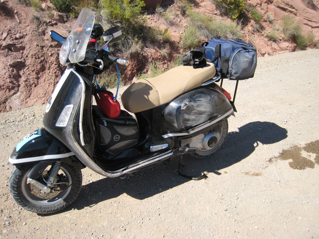

Posts: 39740
Posts: 39740
I feel your pain. Not because of the rack (I didn't have a front rack, and the rear rack I built myself).
This was, for me, Cannonball 2008, on a gravel switchback in remote Utah.
(The wet spot on the ground is gasoline from the aux tank hidden in the gym bag on the back rack).
