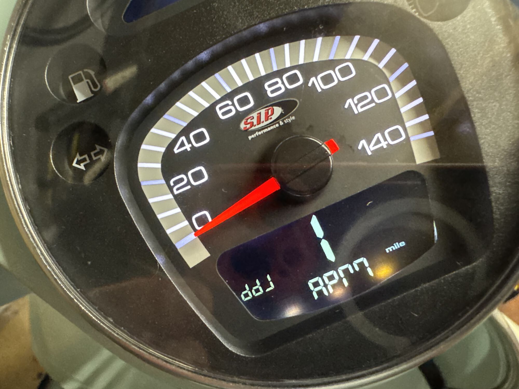

I get the AFR7 flashing on the ADJ 1 setting but my only option is miles or KM not C or F. If I carry on holding the button it reverts back to the ADJ 1 setting flashing.
Its a bit frustrating as it should flash C or F next to AFR7 and not just miles I think. See image.

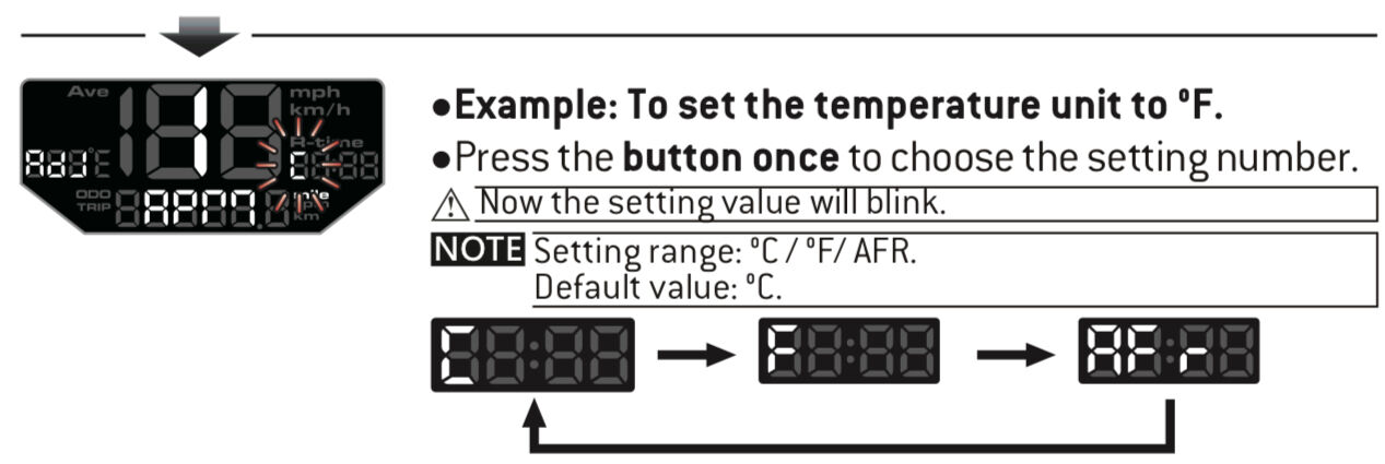

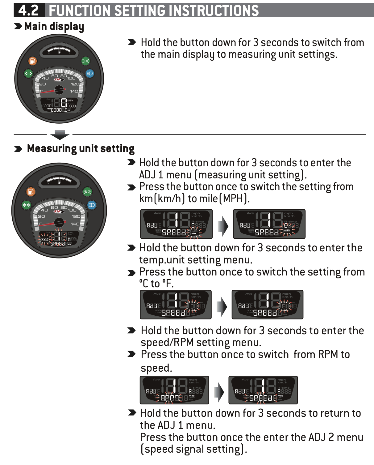

@roland87 avatar
Posts: 1833
Location: Ukraine. Kyiv.
@roland87 avatar
Posts: 1833
PX200EFL & Gl150
Posts: 7
Location: UK
PX200EFL & Gl150
Posts: 7
Location: UK
Thanks Roland, unfortunately I am missing C or F above the mile or km option (see pic above).
The 3 second hold only moves the flashing options from ADJ 1 - to mile or km - to SPEED or RPM - and back to ADJ 1. No C or F option in any category.
Also have a look at my pic below which shows the temperature at 117c when the engine hasn't been started all day - ambient temp was about 17c.
