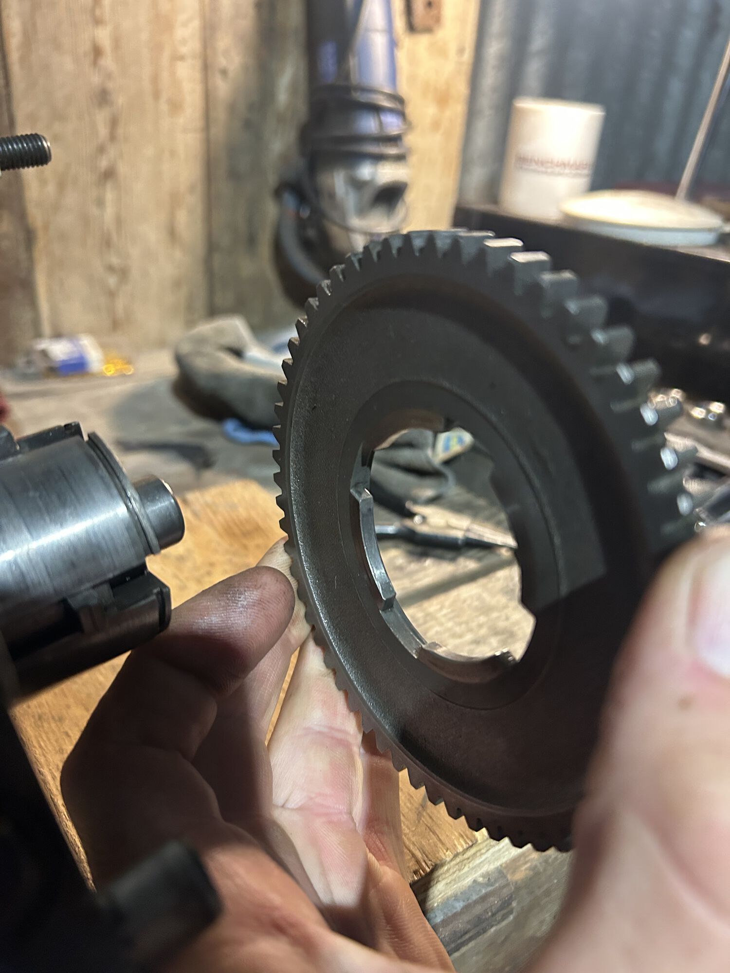

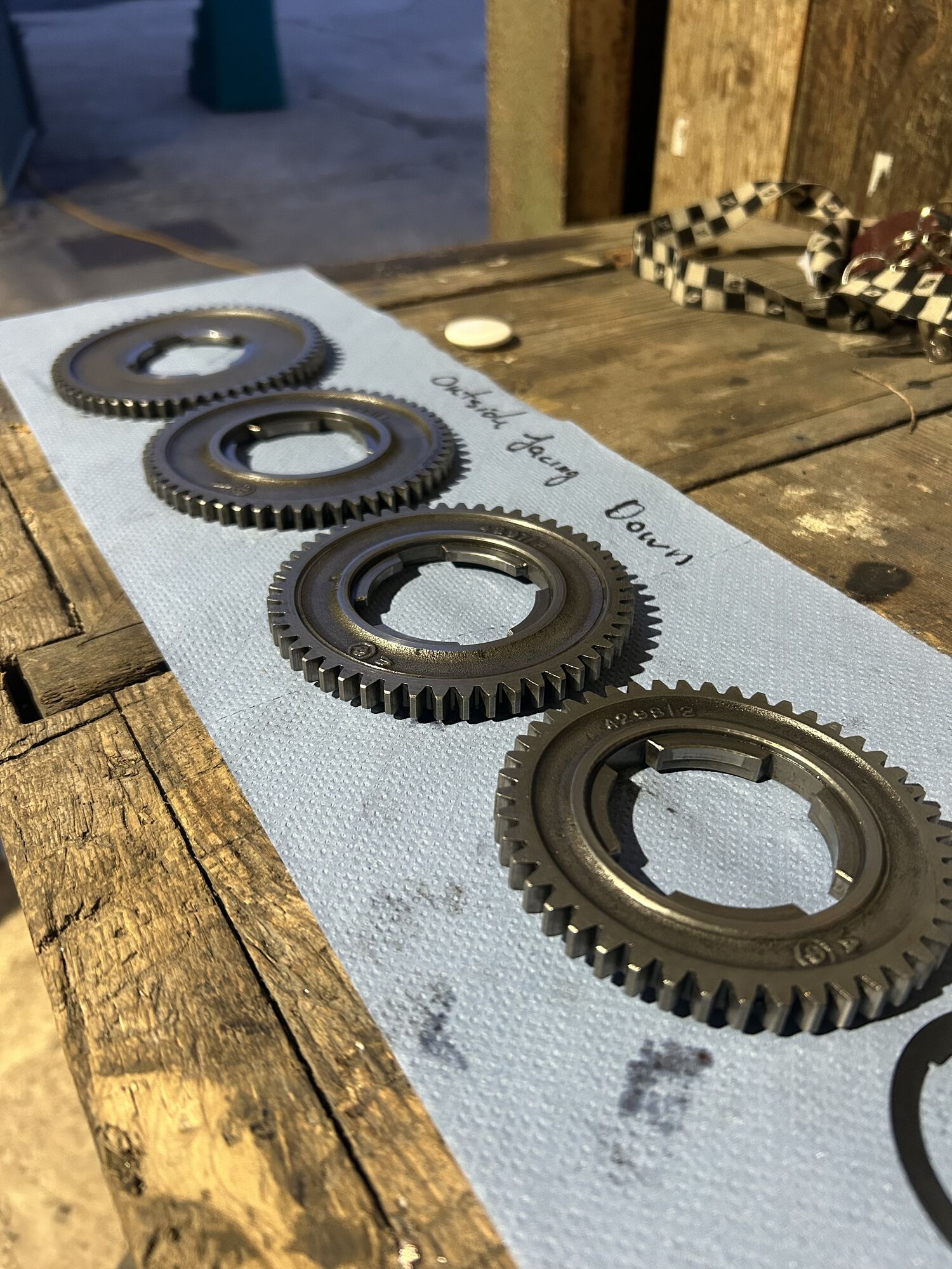

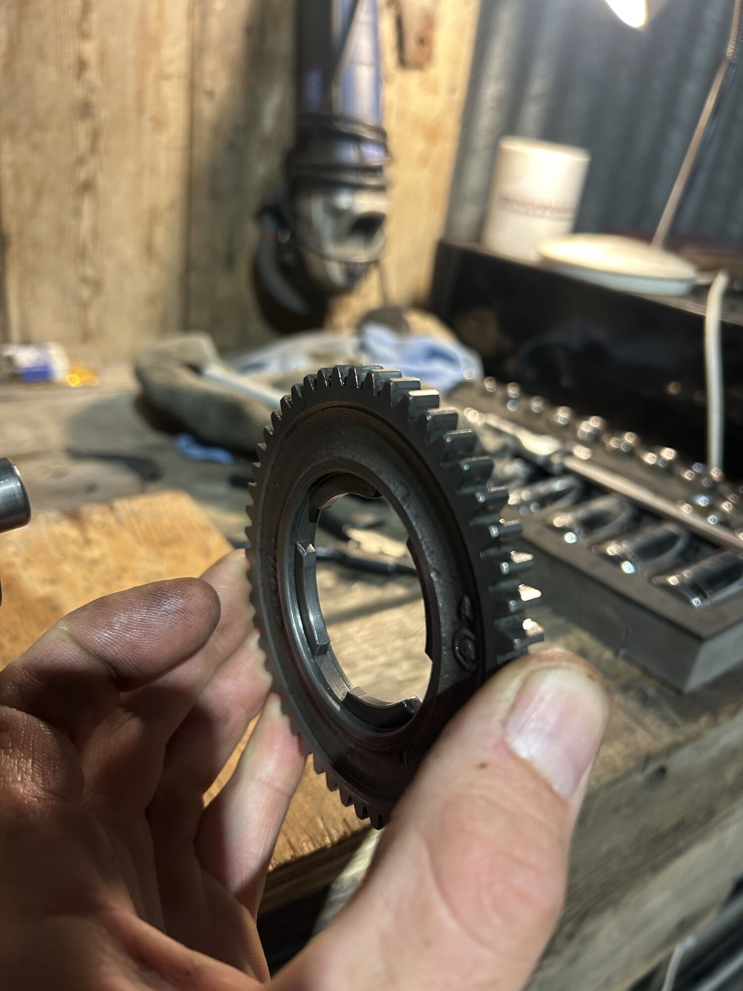

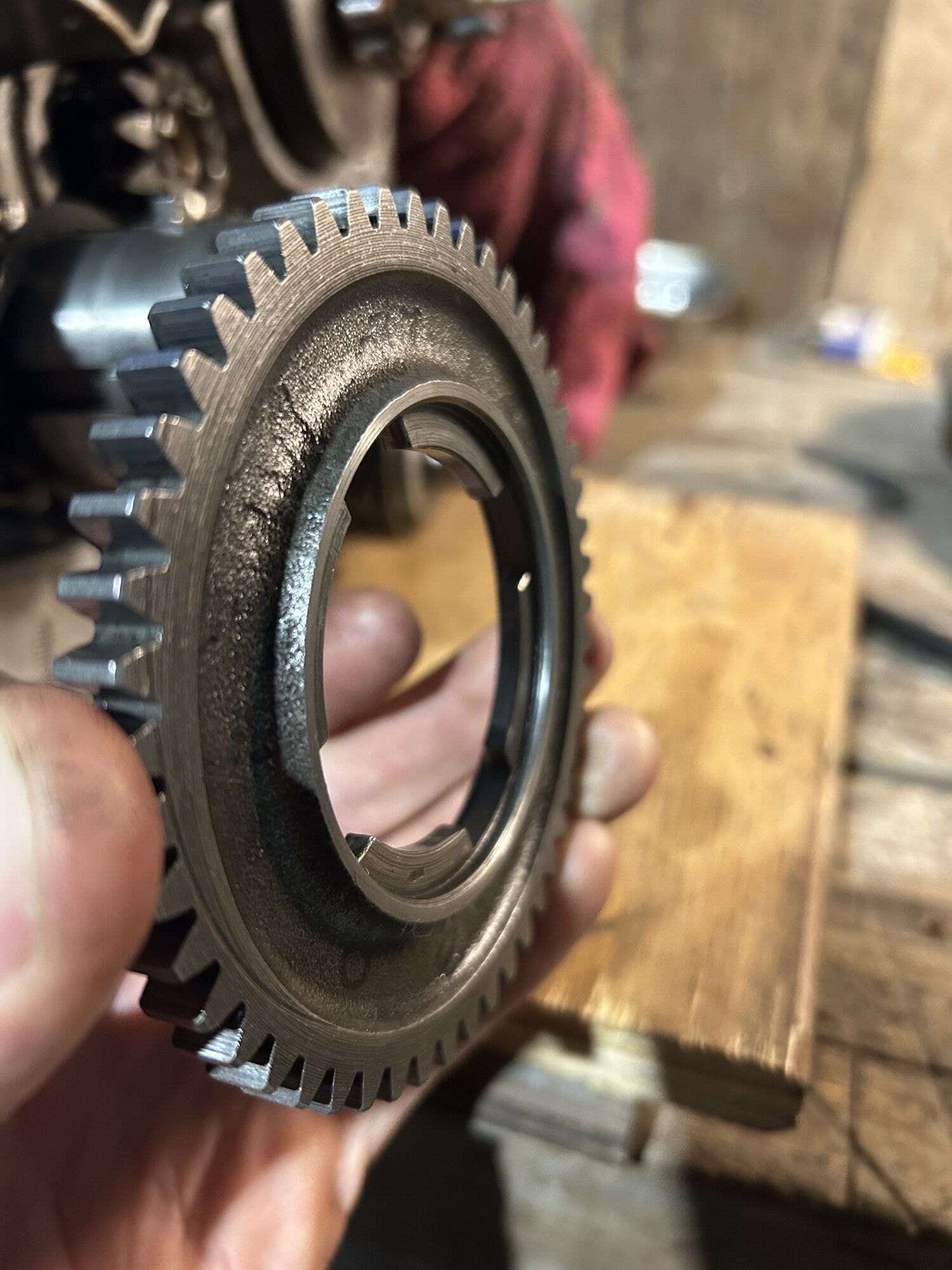

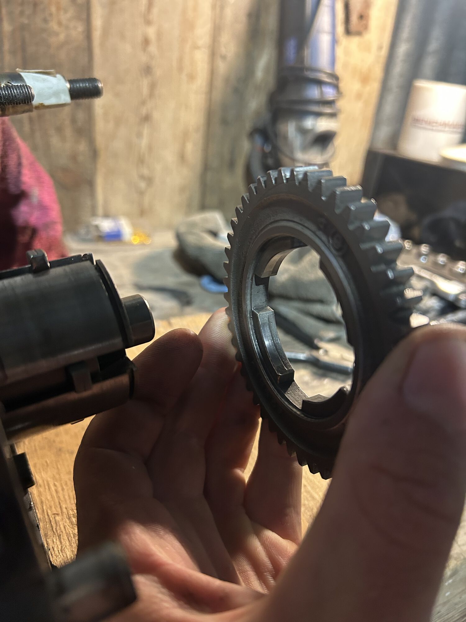

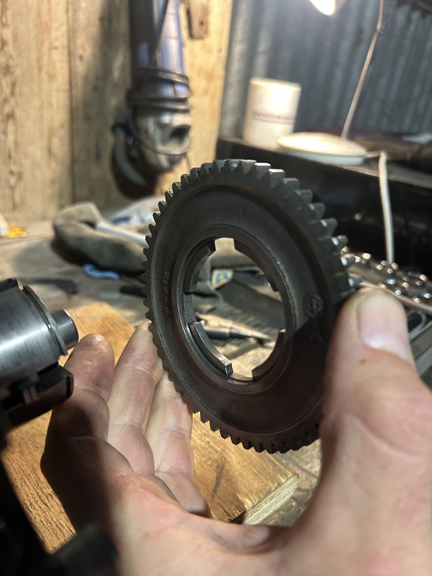

Thanks for the advice. I have now stripped the engine back down so I can examine the internals again.

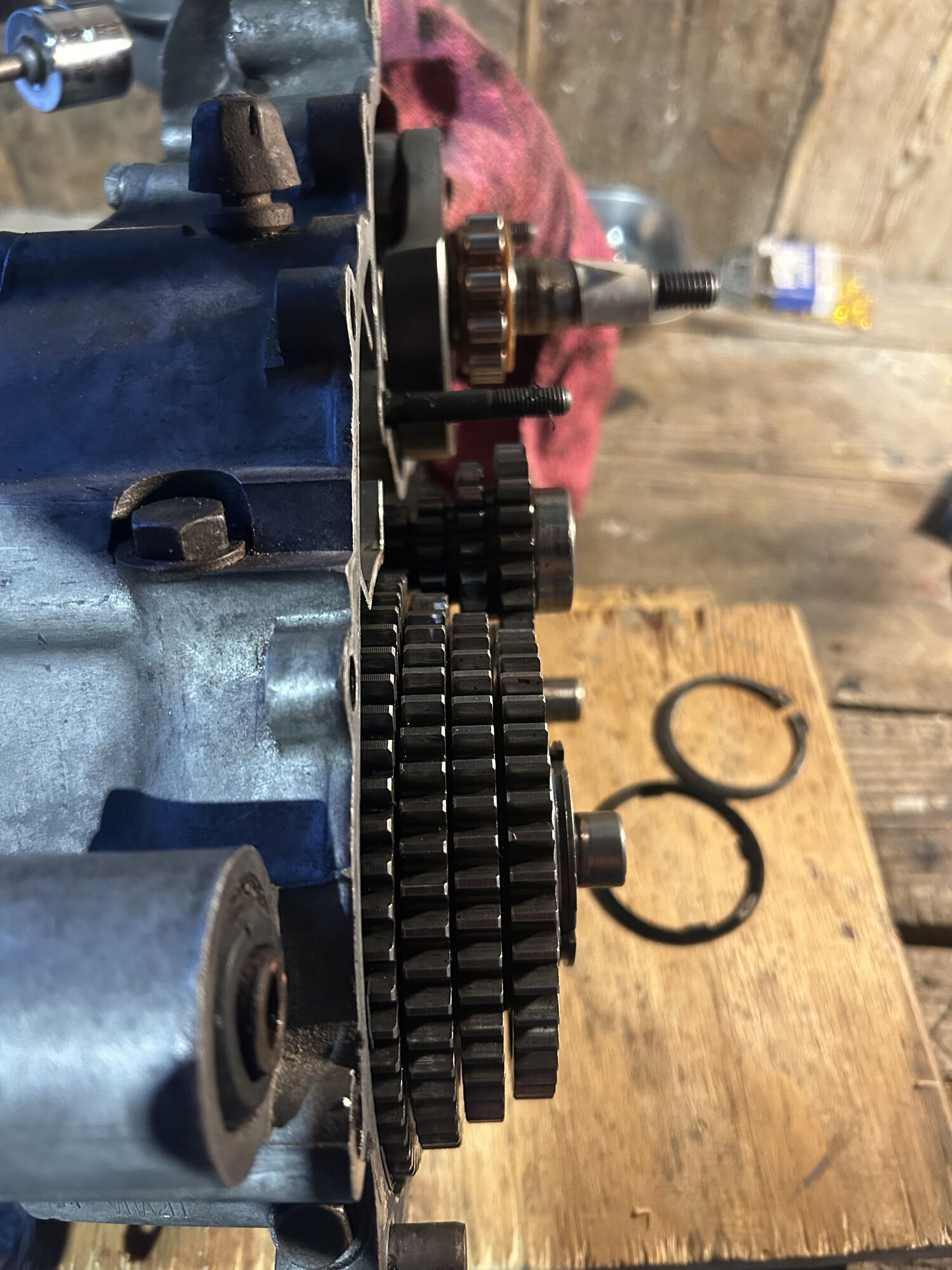

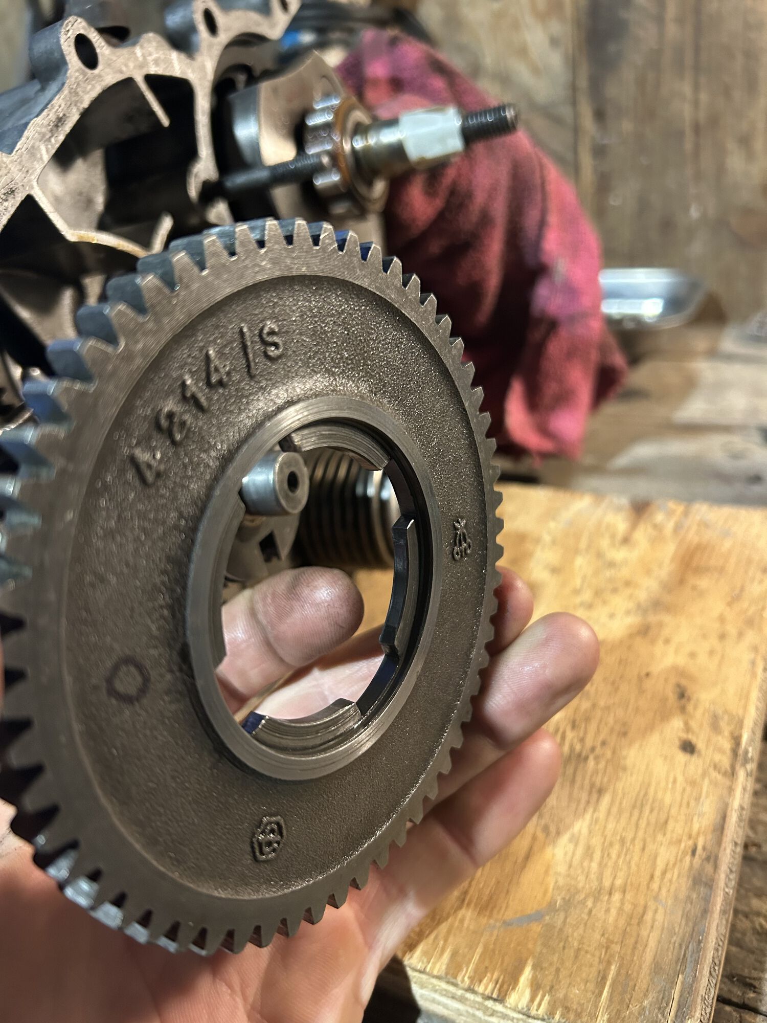

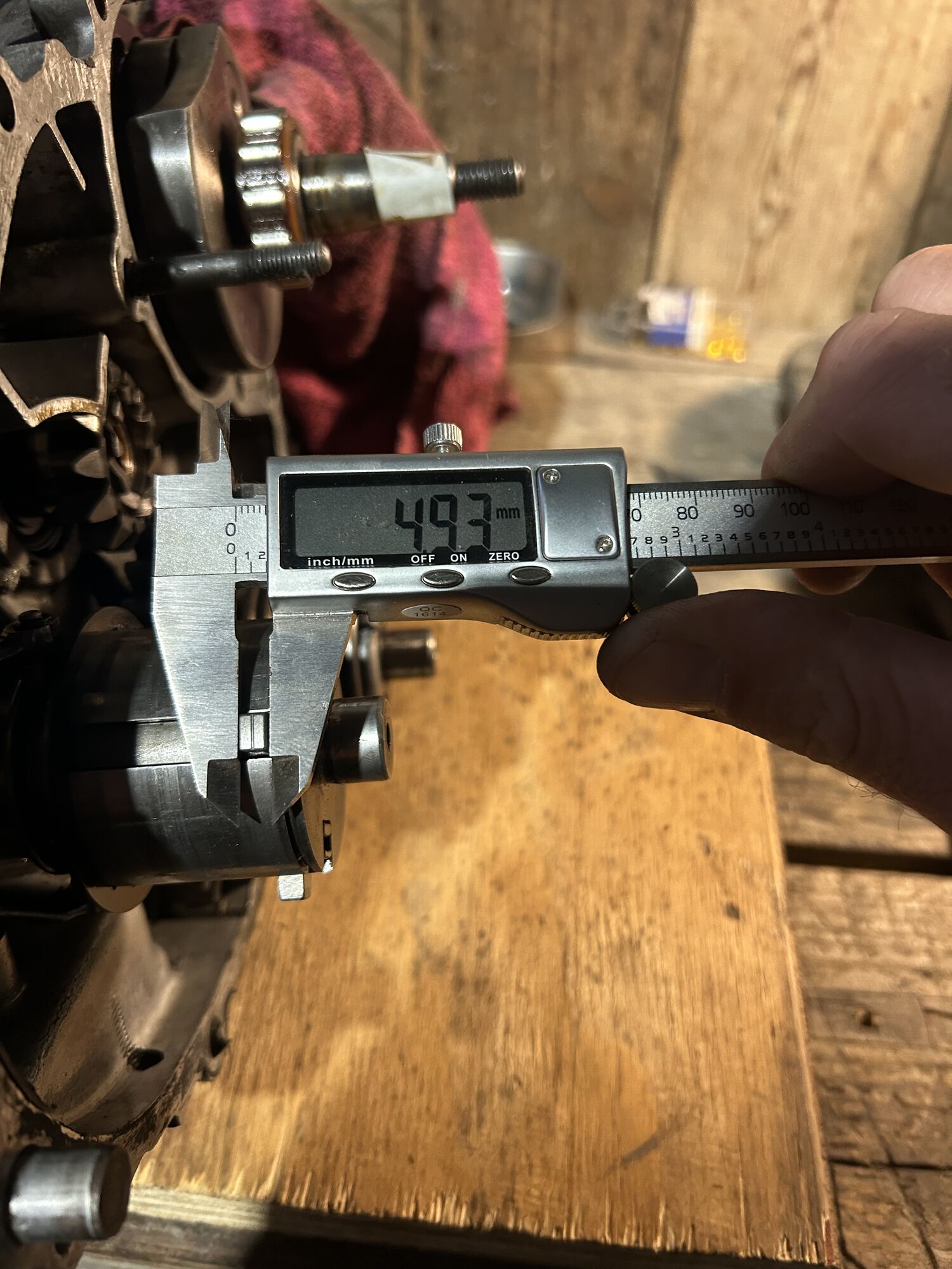

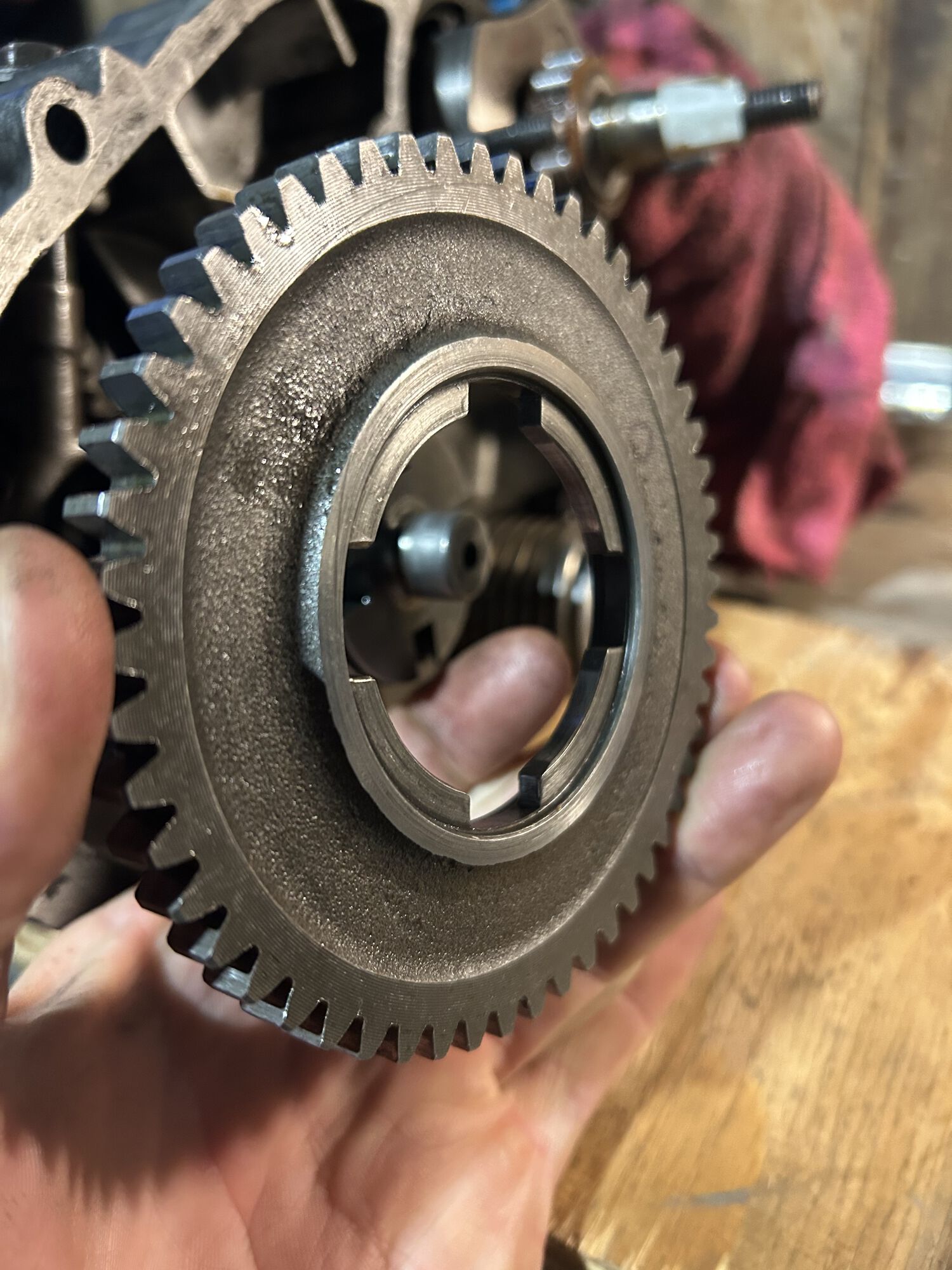

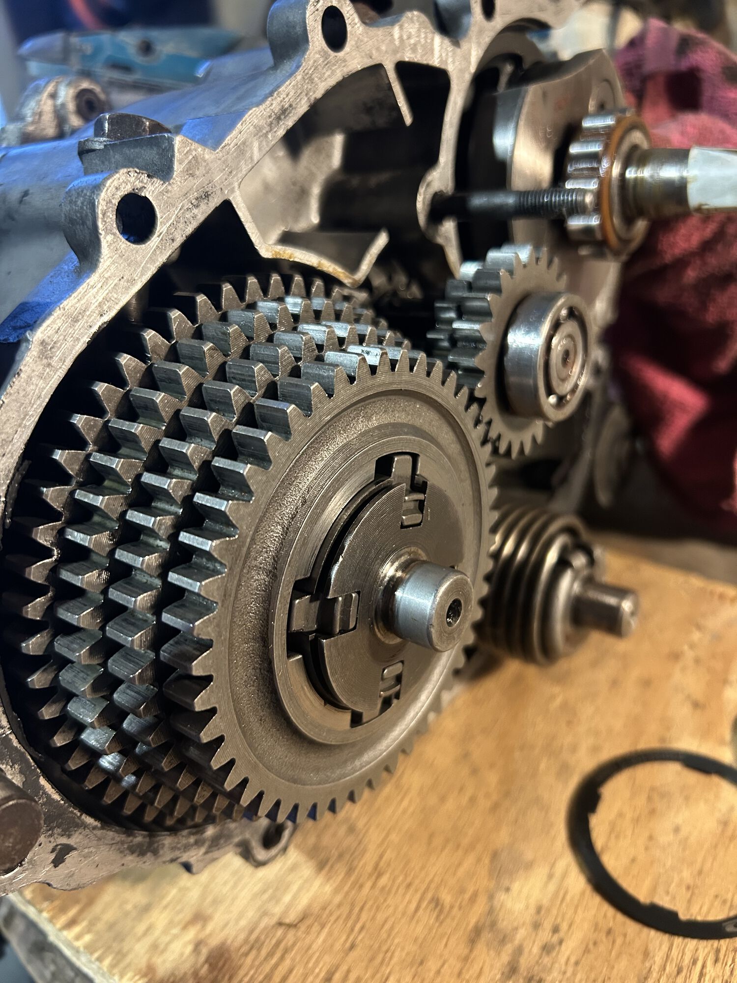

Looking again, It appears the issue (as you suggested) is caused by warn gears and or cruciform. It seems quite clear that there is to much space between 2nd - 3rd and 3rd - 4th so the cruciform can spin between these gears. I haven't been able to measure the thickness of what remains on the gear tabs. I have also uploaded a video showing the issue.

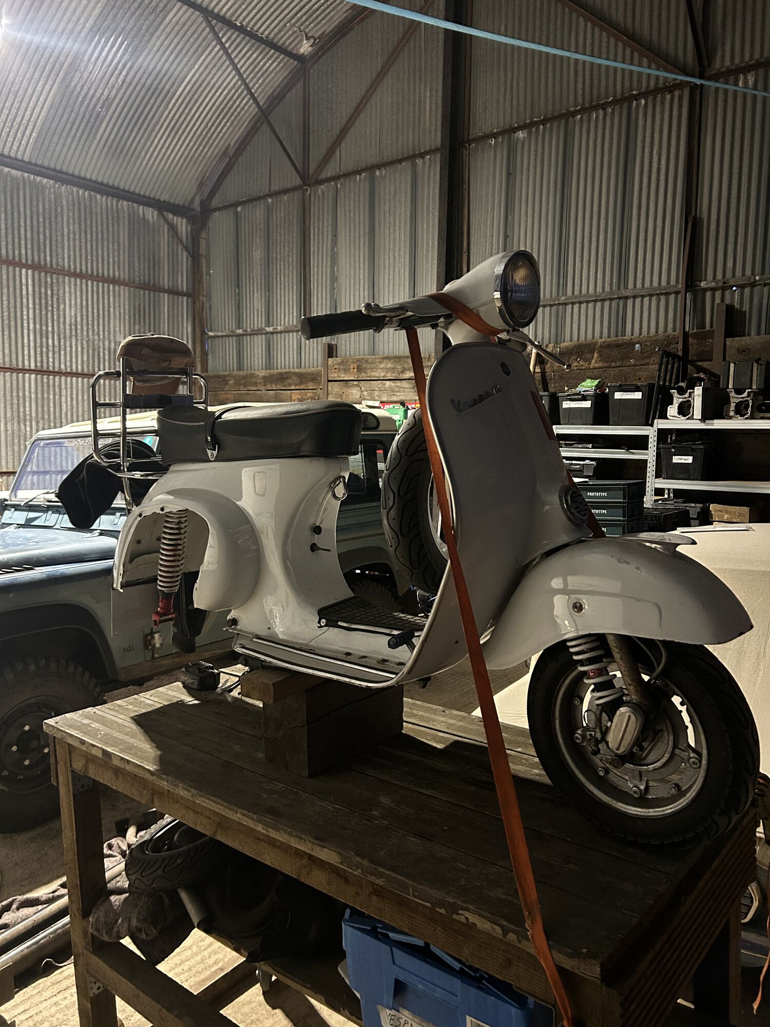

Here a load of photos of everything + photo of the scoot!

To me, the corners of the gear slots and the cruciform do not look bad. The gap between gears is necessary so that two gears can not be engaged at the same time. The gap between first and second is greater for a true neutral position. Maybe your cables are adjusted to tight and you are inadvertently moving the grip while accelerating? I have done thin many times while going up hill, for instance.
