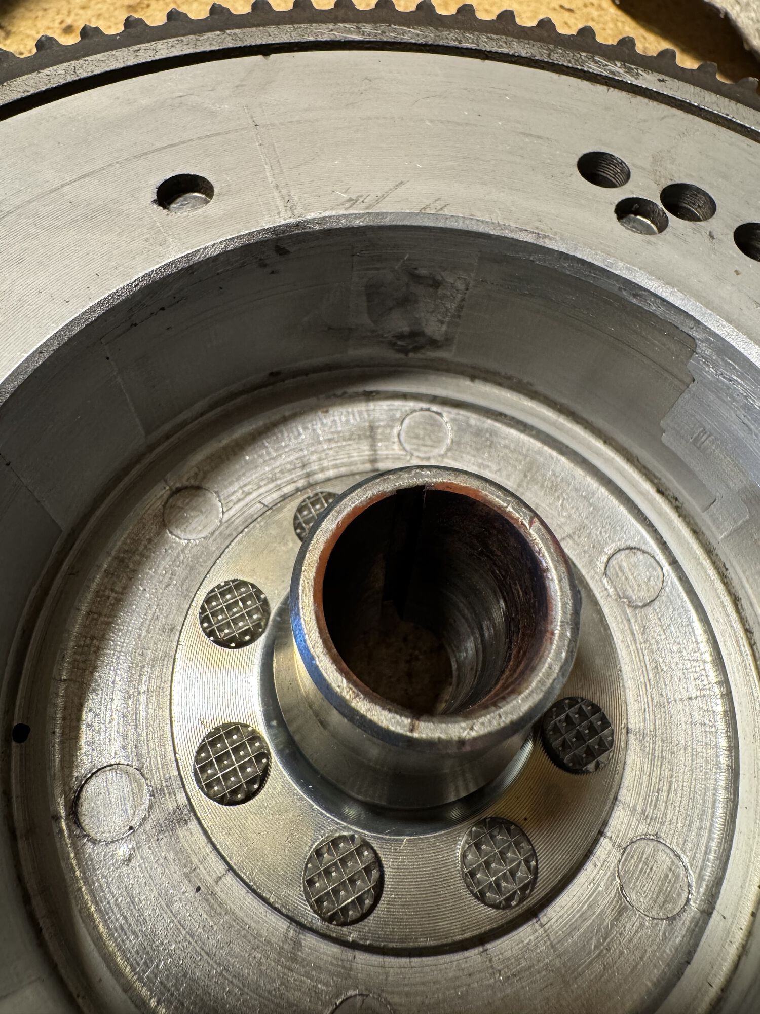

So the dial wheel came up very minimal readings of 0.05 variant (dial wheel setup on the crank edge with the flywheel off). However I did notice a gouge inside so not sure if that is current or a previous crank ?
