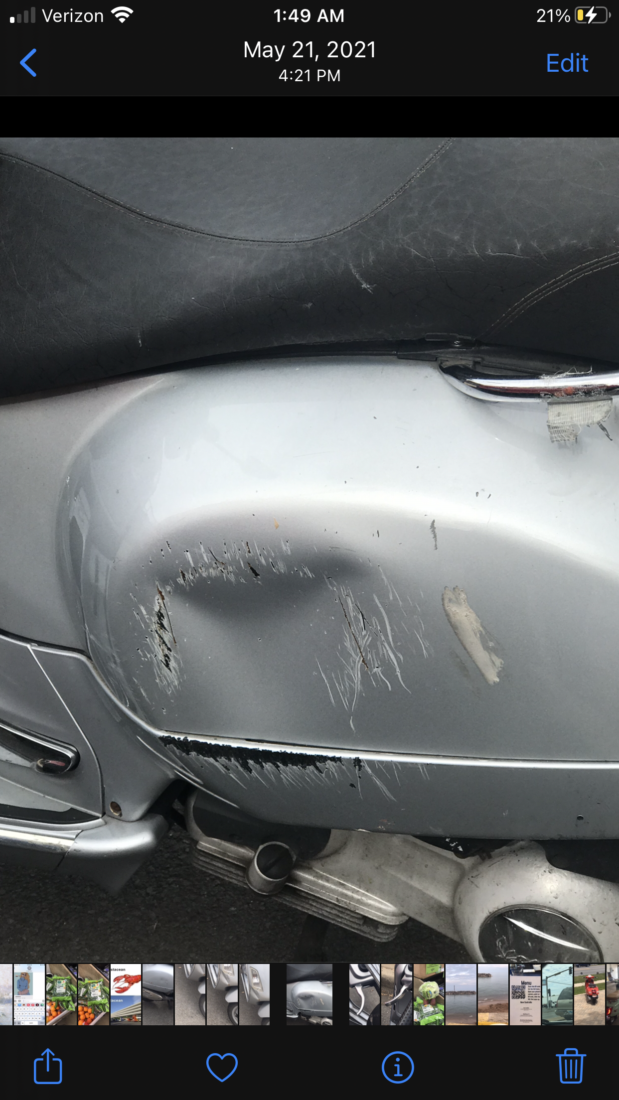

ok! so while looking around i stumbled accross this, the price was reduced cause it was damaged in a shipping fall. the dealership is telling me that its not a salvage title and that its a normal title.
they did repair the damage from the fall as the dealership is a body shop as well.
attached is the repair and the original damage. I dont know anything about the structure of the bike, but i do know thats frame damage, i was just wondering if its safe for the engine frame damage and safe to ride frame damage. I probably should ask them to knock a good 400 off the price for sure now too.

I wouldn't be concerned about that damage at all. The engine mounts much lower down at floorboard area, and the shocks mount up under the seat. While it is technically frame damage, this looks only cosmetic.
Frame damage on a Vespa is only worth worrying about if the fork had moved or the engine mounts.
If it has been well painted and the dent removed, there is no reason not to buy it. Maybe ask them for a little more discount?
That's pretty close to my thought on it. It's just a harder fall than I think I imagined. But I know for sure it's like a fall actually. It's similar to bikes I've ridden in terms of damage level
I feel like my old bike(grey) might be worse lol. That was from a scrap recycling truck hooking on to the mirror and dragging it 8 feet, also bending the left brake lever into a perfect cup holder shape, which I did use to hold drinks occasionally, until it snapped in half(but still worked)

It isn't particularly clear from that image but it looks like there isn't even any broken paint on that bike.
Over here in Porto, I have had much worse damage removed by a paintless dent repair specialist. Just requires a fair bit of disassembly behind.
That's reassuring, yeah you're right the paint didn't even crack really
