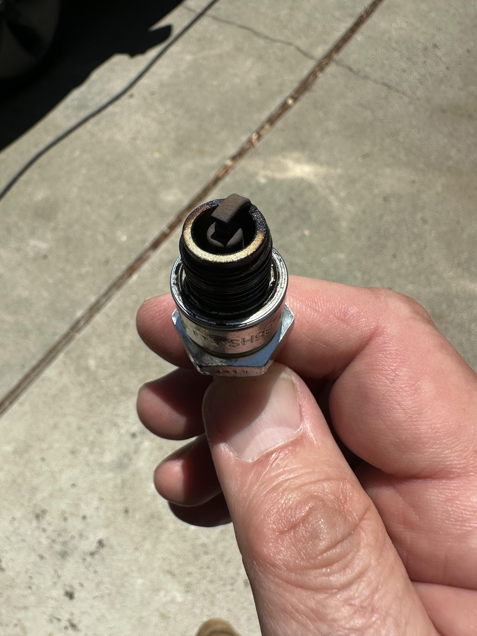

I pulled the spark plug, and it seems good to me. If I hear clear symptoms of an air leak, it will obviously need attention, either by me or Tim at Bello Moto, but otherwise, if I regularly inspect the spark plug, am I safe to ride around?
B6HS plug after about 160 km. I think this is how it's supposed to look?

Looks a little charred to me. Consider upjetting and a clean plug.
If you're worried can also pull the head and inspect the piston top.

If you just pulled the plug after a ride home, that won't tell you much.
Search "plug chop" here to see how to take a sort of picture at a fixed throttle position. A true "chop" involves actually chopping the plug to see the soot ring at the bottom of the insulator, but who wants to have to do that?
If that pic were a kind of plug chop I'd say on the rich side, but you probably rode around with the engine cooler/stop and go before pulling it.

Did the spark plug end up being okay? It does look a little charred up. Good luck!
@metadaddy avatar
Posts: 322
Location: San Jose, CA
@metadaddy avatar
Posts: 322
Thanks! I haven't taken another look yet. I'll report back when I do 👍🏻
