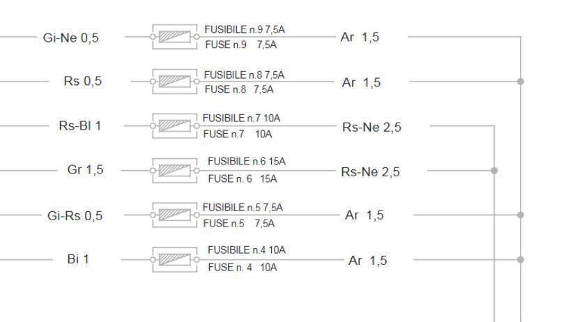

Did you look at the circuit diagram?
With the fuses removed, one side of fuses 4,5,8 and 9 will be shorted - the orange wire from the ignition switch, one side of fuses 6 and 7 will be shorted with permanent 12V on the red/black wires. The other side of the fuses may well show some continuity, e.g. through a light bulb to ground, then back up though a relay coil or other device. Not a short mind, but enough to sound off a continuity buzzer or bleeper.
Looking for continuity across those circuits is not a good diagnostic tool for anything really.
The headlight should only work with the engine running, the headlight relay coil gets its ground from the ECU when the ECU is happen to let the engine start and run.
