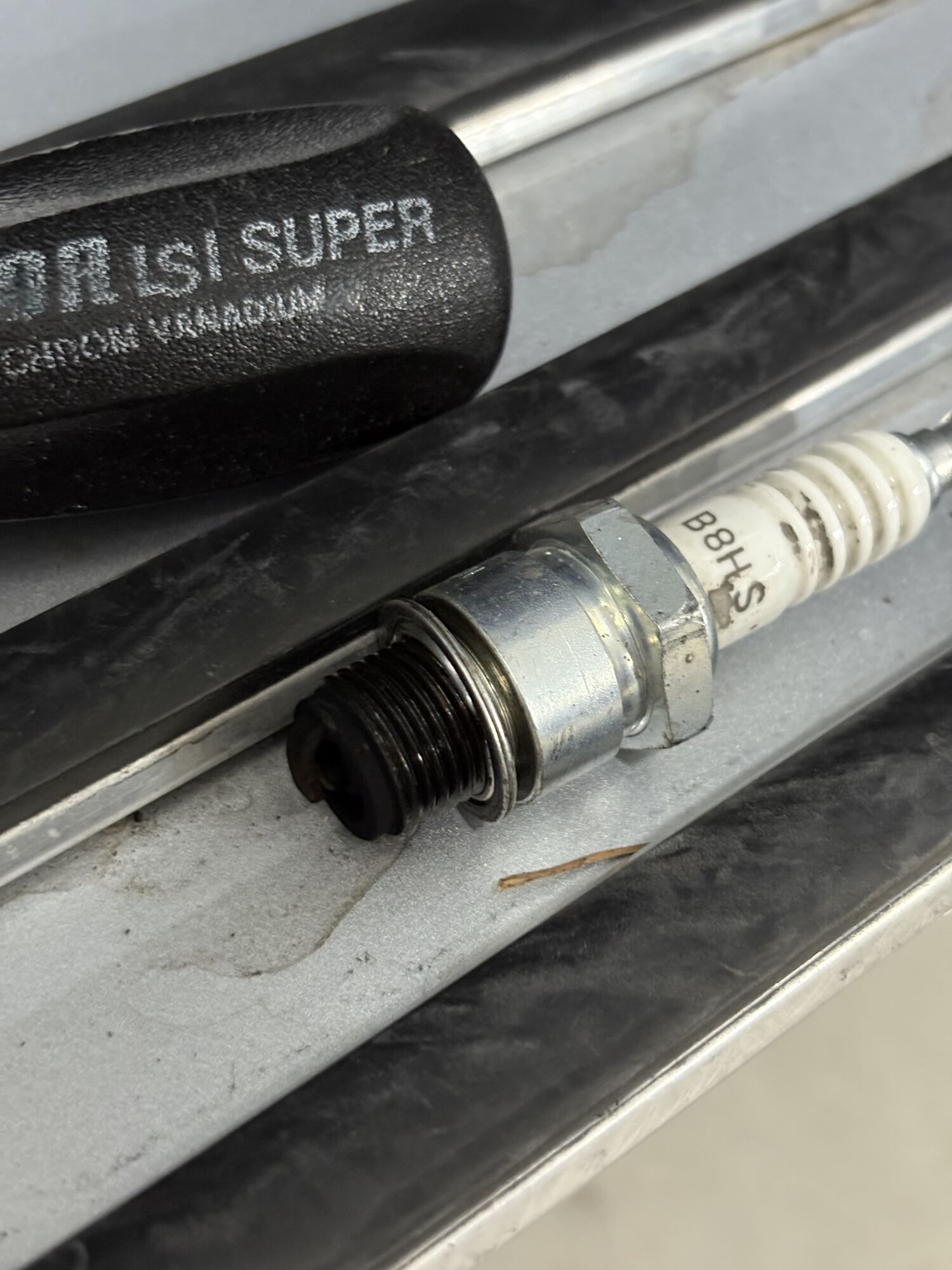

To be honest with you, not really. Up jetting seems counter intuitive. What is the logic behind it? I tought i should down jet since my spark plug looks like this (see att.)
Logic behind it is if it gets worse, you will know AND you will not seize your motor. If I told you to go leaner jetting, you could seize the motor and then we would both be in trouble.
Now that I can see the spark plug is black, if you have smaller main jets, slowly start to downjet until you find a good balance of performance without seizing the motor. So maybe 125 MJ?
